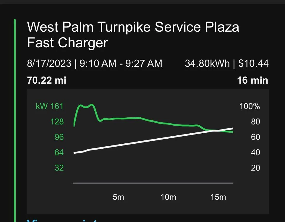

On a DC charger, my Pro SR tops out at 161 kw. I’ve seen those numbers on FPL and EA chargers. Because the battery pack is below 400volts, you need a charger with a higher amp output to compensate for the low voltage. On the 150 kw chargers, I top out around 100 kw. But on the 350 kw chargers, I can pull the bigger number because the charger puts out more amps.
