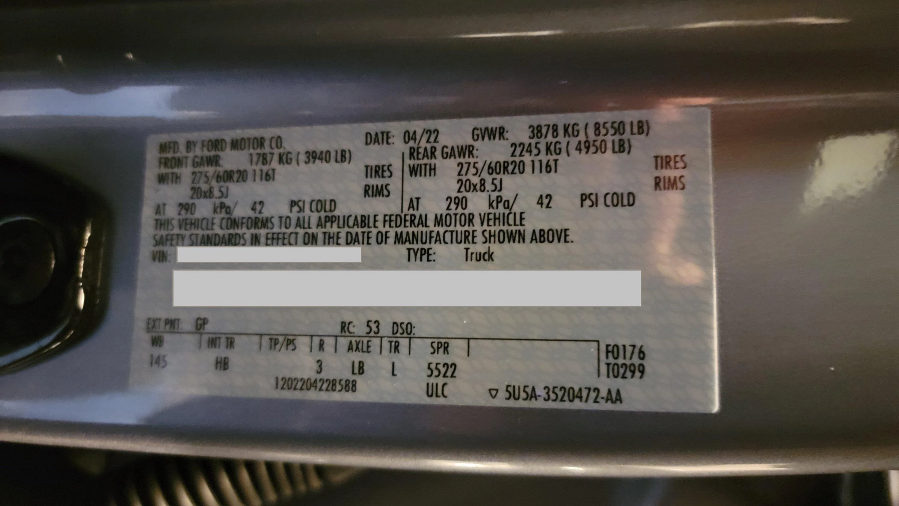

Yea.. I think I'm (we're) screwed for options. The math says you could go with a 115 load index tire based on GAWR and GVWR but I am sure (?) Ford cooked in some tolerances I am not aware of.
Ford F-150 Lightning Different Tires on Stock Rims - 116 Load Index 20230129_193951 - Copy
GVWR 8550:
per tire: 2137.5
GAWR Front: 3940
per tire: 1970
GAWR Back : 4950
per tire: 2475
115 tire has load index of 2679
116 tire has load index of 2756

I ran into this trying to get winter tires, Costco wouldn't put Blizzaks on, because they have a load index of 115 and the Grabbers are 116 (so the door sticker says 116). Was really frustrating.
