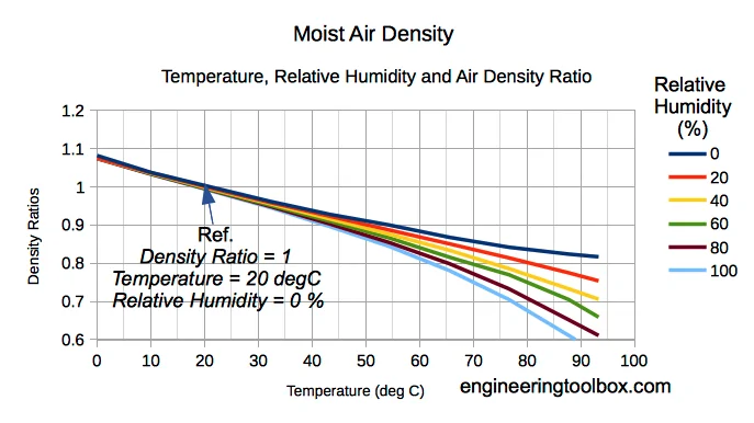

The density of air contributes linearly to drag forces, which come into play above about 35-45 mph (56-72 kph). At STP (0 m altitude, 25 ºC, 0% humidity) the density of air is about 101 kPa. At 2100 m, the air density is about 78 kPa (same temperature, same humidity). *IF* drag forces were the only thing that had impact on efficiency, that would be a reduction of about 23% going from sea level to my home. That’s obviously not all that matters (rolling resistance, various electrical and thermal inefficiencies, mechanical inefficiencies, temperature, humidity, etc. matter too).
Humidity impacts on air density are coupled with air temperature because of the nature of how air holds onto water vapor. Below about 25 ºC, the density is mostly temperature-dependent because of that behavior. In this plot they’re using 20 ºC as the reference, but the moist air density difference between 25 ºC and 20 ºC isn’t all that much so you can use the graph to gauge the relative density for the temperatures you’re experiencing. I doubt you’re getting much above 30 ºC except in the very hottest days.
Ford F-150 Lightning Efficiency after 16,000 kms moist_air_density_temperature_relative_humidity
