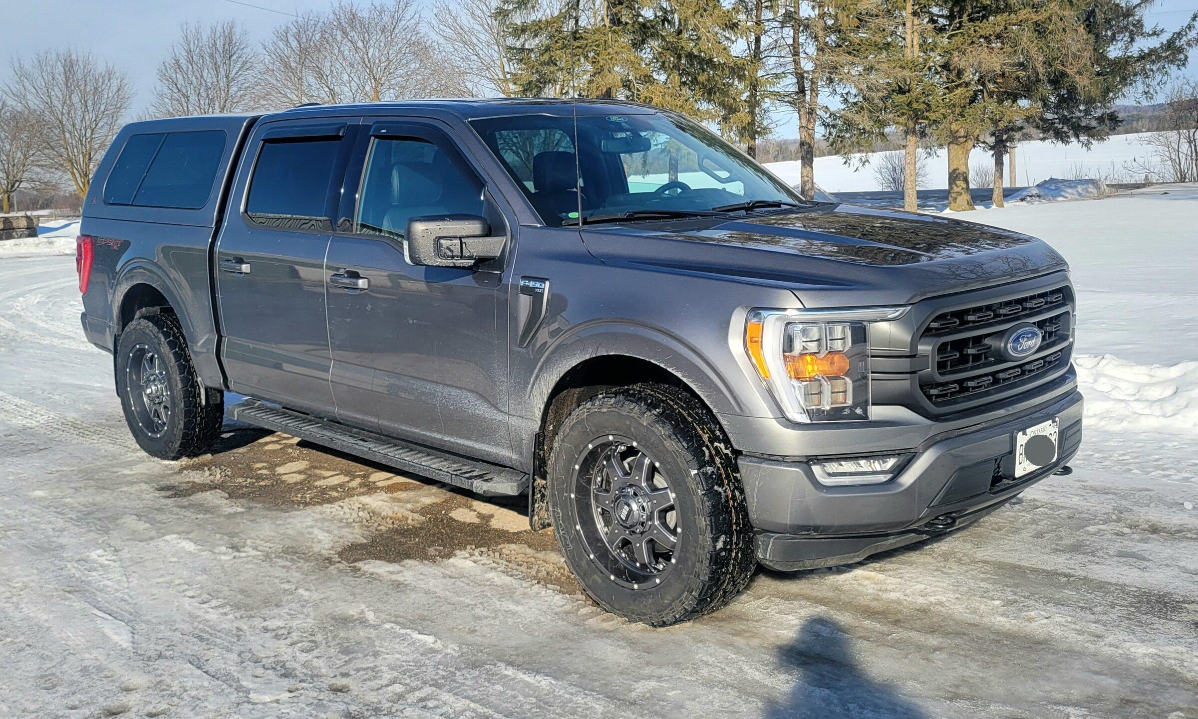

Thanks. Truck is 4x4 with a 5.0L
Do you have an eta on the clip height shocks?
