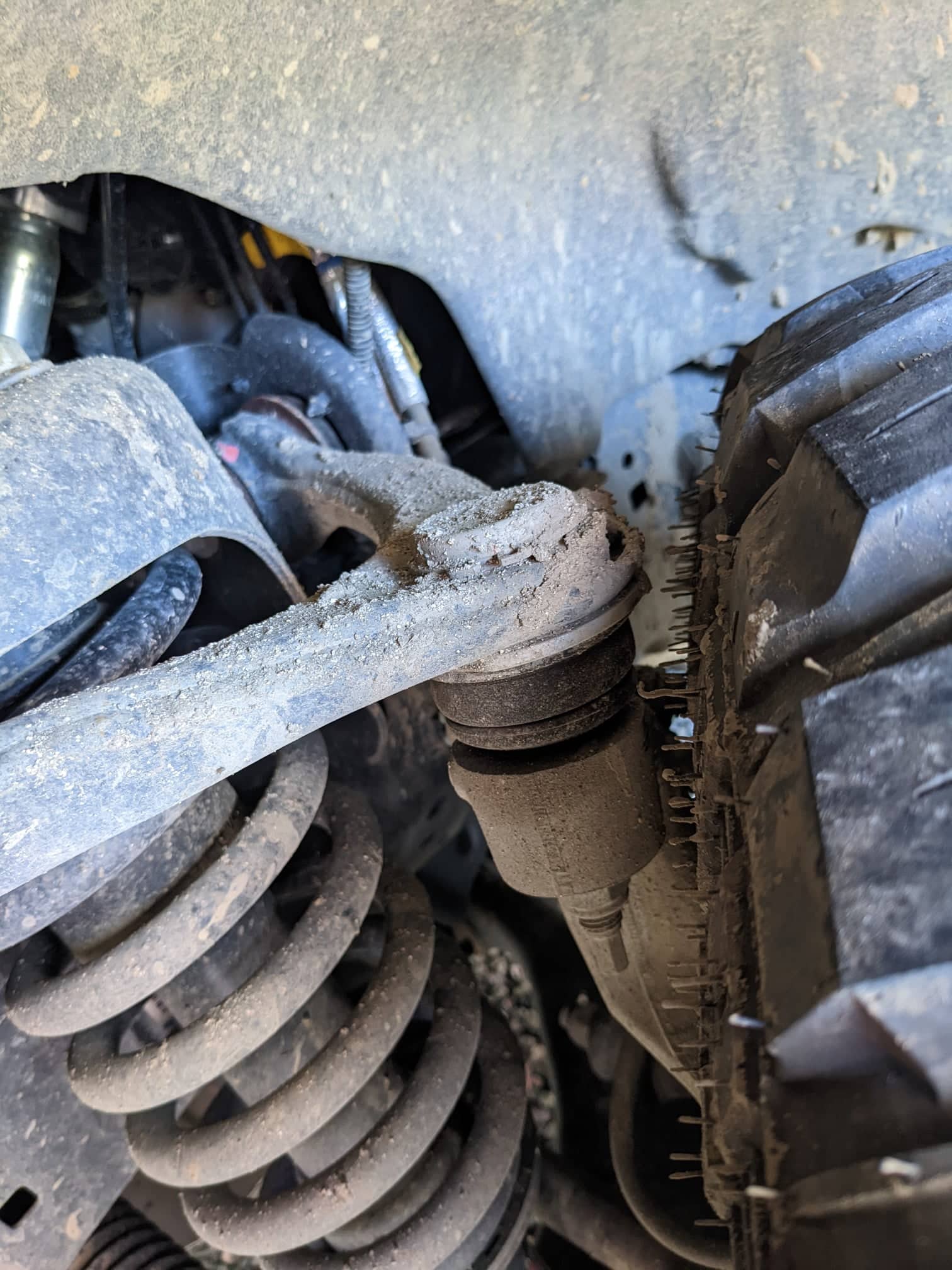

3600 mile update:
The 33x12.5s are working great with no lift or spacers. I probably see full suspension articulation at least once per week and have not experienced a single rub. She has the FX4 package if that makes a difference but I don't believe that provides additional clearance.
When it's time for replacement I'll be going to 35x12.5.

I'm surprised 12.5 fits with stock wheels. Can you share a picture of the upper A arm clearances?
