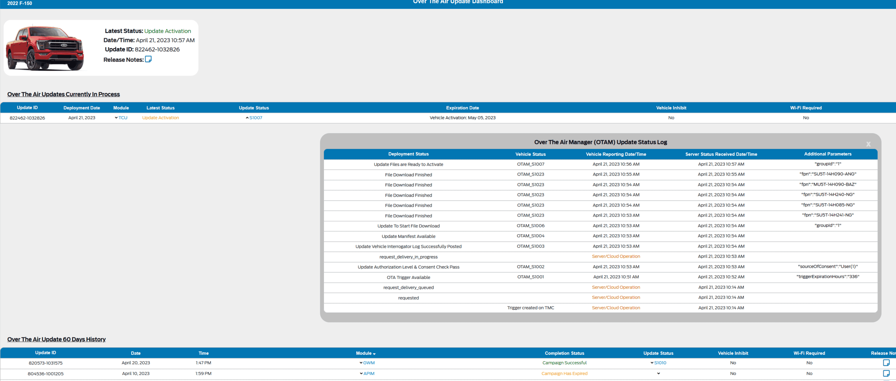

I've run out of ideas on how to kick off the activation of an update I'm seeing. Today I reset the truck by disconnecting the LVB for about 10 minutes and then put it on a charger and then running the truck until torque (Android app) showed I was above 90% SOC on the LVB. I then set the OTA update schedule to about 10 minutes after I arrived home. Still showing awaiting activation.
Ford F-150 Lightning FLARE-PRD-SOFTWARE-FNV2 Activation 1682893496014
Any other ideas I should try before Friday (date this update expires)?

I should note that I have not seen an update for the TCU in FDRS.

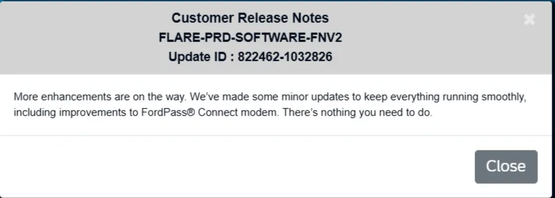

SmoothJ
Dec 22, 2021
65
1,148
853
New Jersey
2022 F150 Lightning
Whats under release notes for that update?
Just a reminder, the OTA schedule in the truck settings only matters for updates that require the vehicle to be off. Most updates don't have that requirement. Smart ruling that out though.
