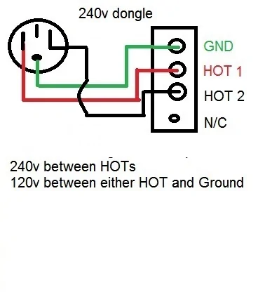

The Ford Mobile Power Cord does not need or use the neutral in the 240V mode with the 240V dongle. I tested the wiring on mine and drew the picture below:

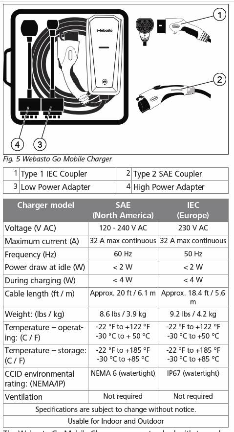

It was made by Webasto and sold on Amazon as the Webasto Go - also some bad reviews of failures there...
Ford F-150 Lightning Great information regarding using a NEMA 6-50 for charging webasto go

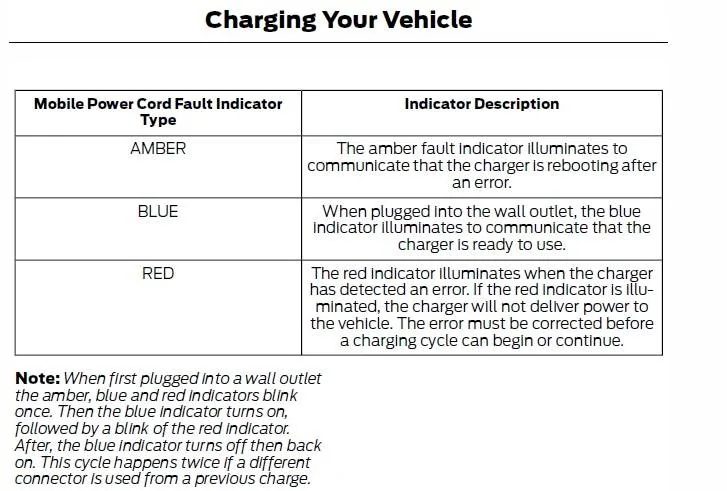

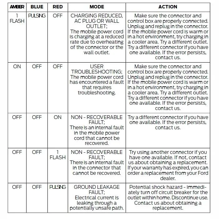

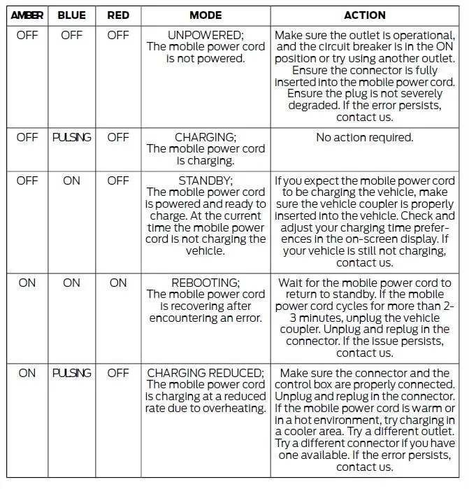

You may need this table with error codes (in 3 sections):
Ford F-150 Lightning Great information regarding using a NEMA 6-50 for charging error codes 1
Ford F-150 Lightning Great information regarding using a NEMA 6-50 for charging error codes 2
Ford F-150 Lightning Great information regarding using a NEMA 6-50 for charging error codes 3

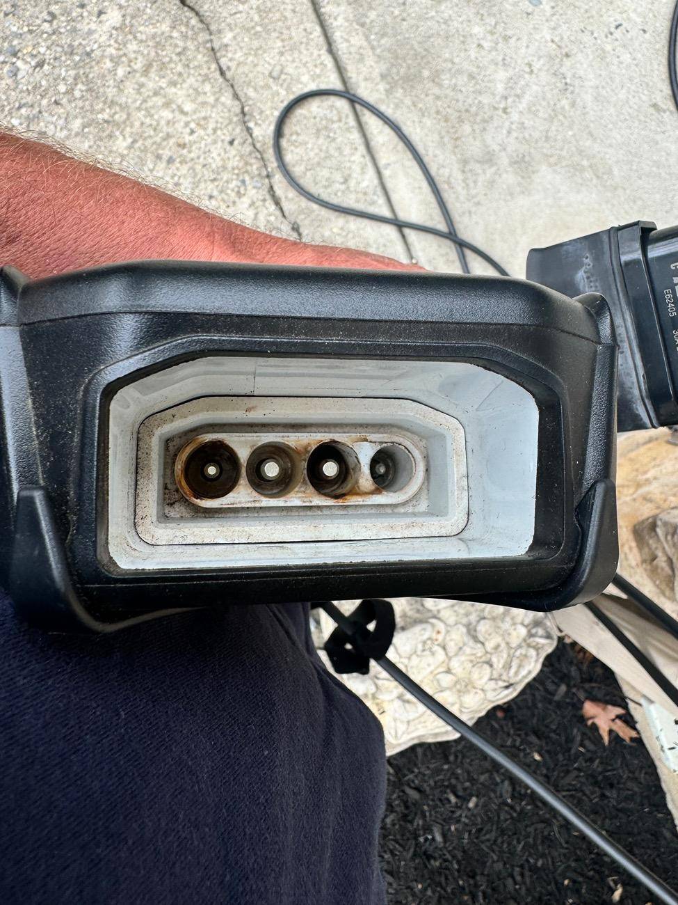

Ford F-150 Lightning Great information regarding using a NEMA 6-50 for charging IMG_2158-discoloration overheatin
This shows why this FMPC failed - a poor connection of the 240V dongle.

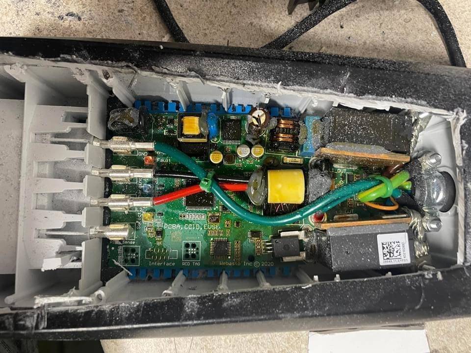

This one melted and failed and the poster cut it open to see if there was anything he could replace:
Ford F-150 Lightning Great information regarding using a NEMA 6-50 for charging insides of unit 1
