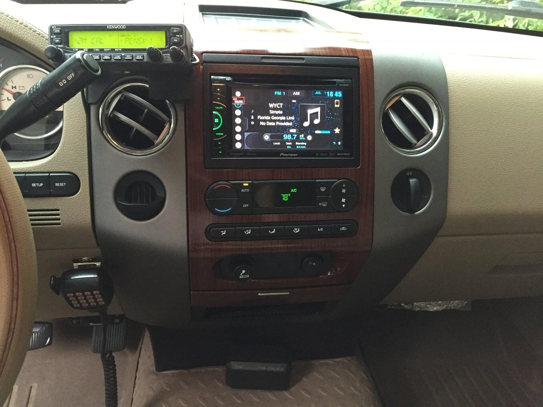

This was my install in my last truck
Ford F-150 Lightning Ham & GMRS Install 417E18B6-9503-4B6C-83F6-F9E3D3F9CFAB
