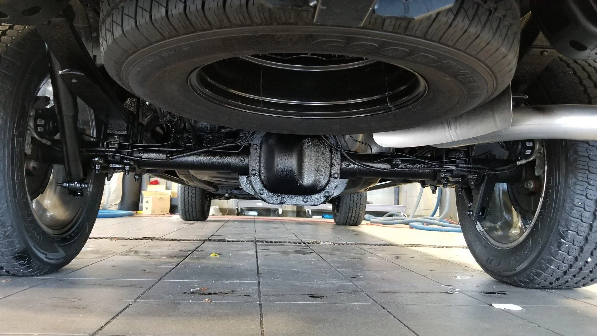

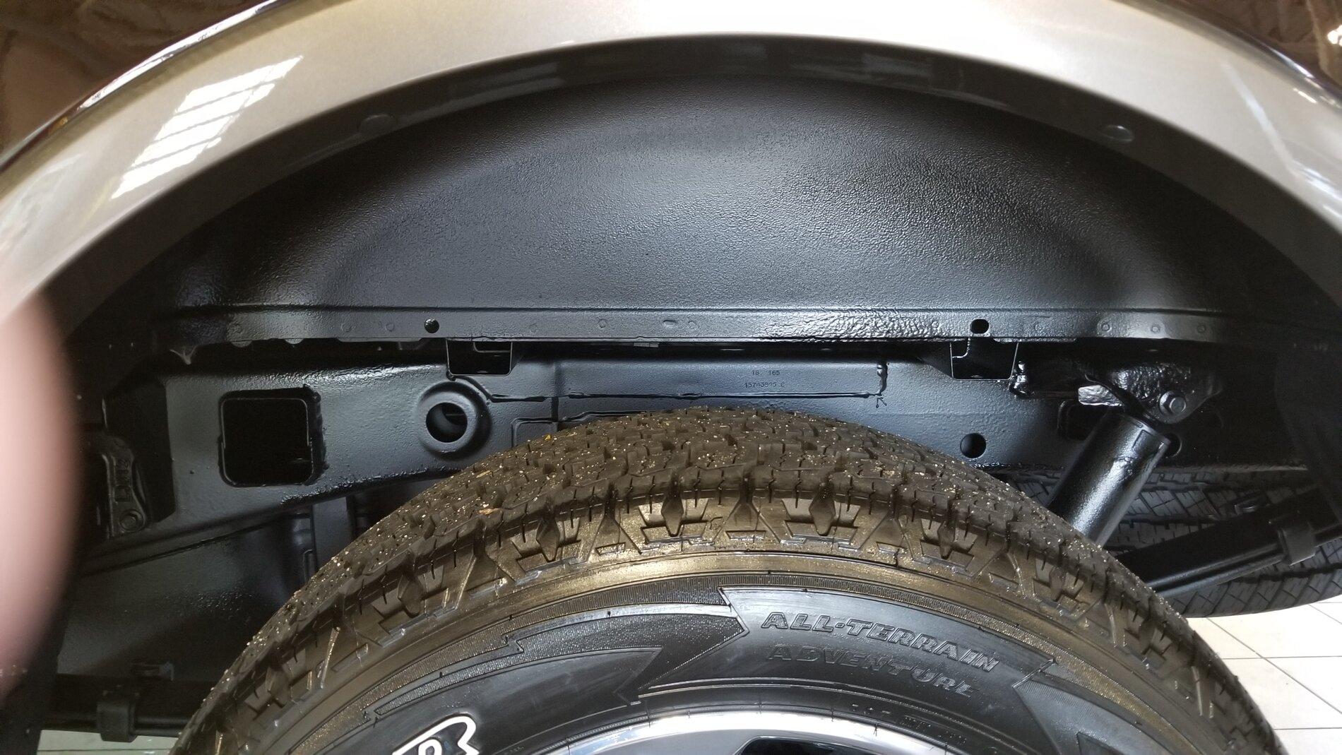

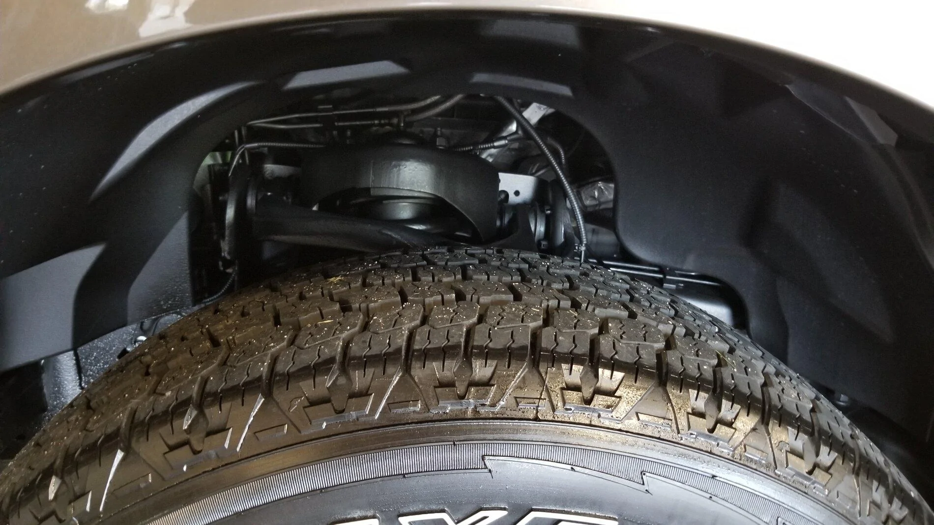

I went with the Line-X rustproofing and undercoating. They had spray done in a day, but I had to leave overnight as it was wet outside which could have impacted the curing. Live in Chicago suburbs where salt is life in the winter!

I have had Line-X bedliner and undercoating on last two trucks and will be again on my 2021. We even did my wife's 2019 Escape. They do an excellent job in a day. I don't drive for 36 hours so it cures (don't want a bunch of dirt to stick when it's soft and new).
Ford F-150 Lightning Has anybody used Line-X rustproofing? 18_Oct 16 - 2018 F150 Soundguard - Front Driver
Ford F-150 Lightning Has anybody used Line-X rustproofing? 18_Oct 16 - 2018 F150 Soundguard - Rear Driver
My liner is the Premium for $599 and $279 for undercoating.
