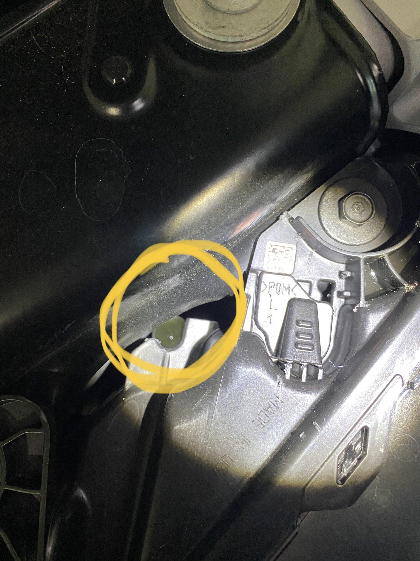

Ok thanks everyone…I apparently don’t know how to find it in the online manual smh. My bad.
lol, no worries, it’s in the service section and not the headlight section. This picture isn’t the best, but look down from the top of the headlight and you’ll see a white Phillips adjuster.
Ford F-150 Lightning Headlight correction following level F731F112-AA16-4BDB-A915-8BEB23EACCE5

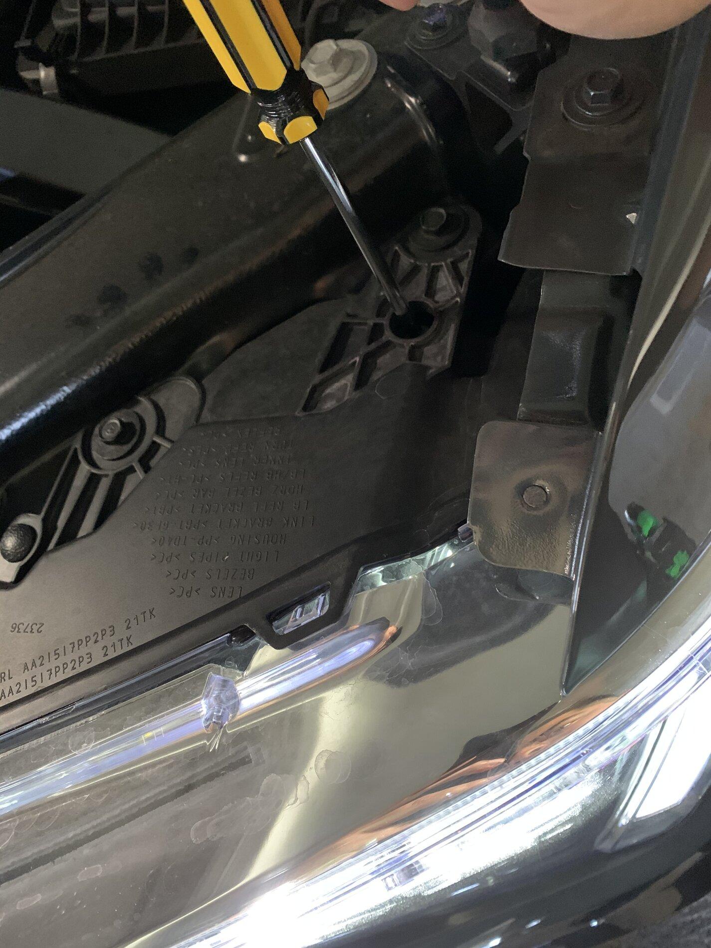

Guys here’s a picture for reference. This is on an xlt 302a with quad led reflector headlights. You twist clockwise to bring the beam down. This is my buddies truck I adjusted, it’s leveled on 34s and I brought it down 4 full turns. Mine is leveled on 35s and brought it down 5 full turns.
Ford F-150 Lightning Headlight correction following level CFE56D97-50C0-4C15-910B-8B8E894A5848
