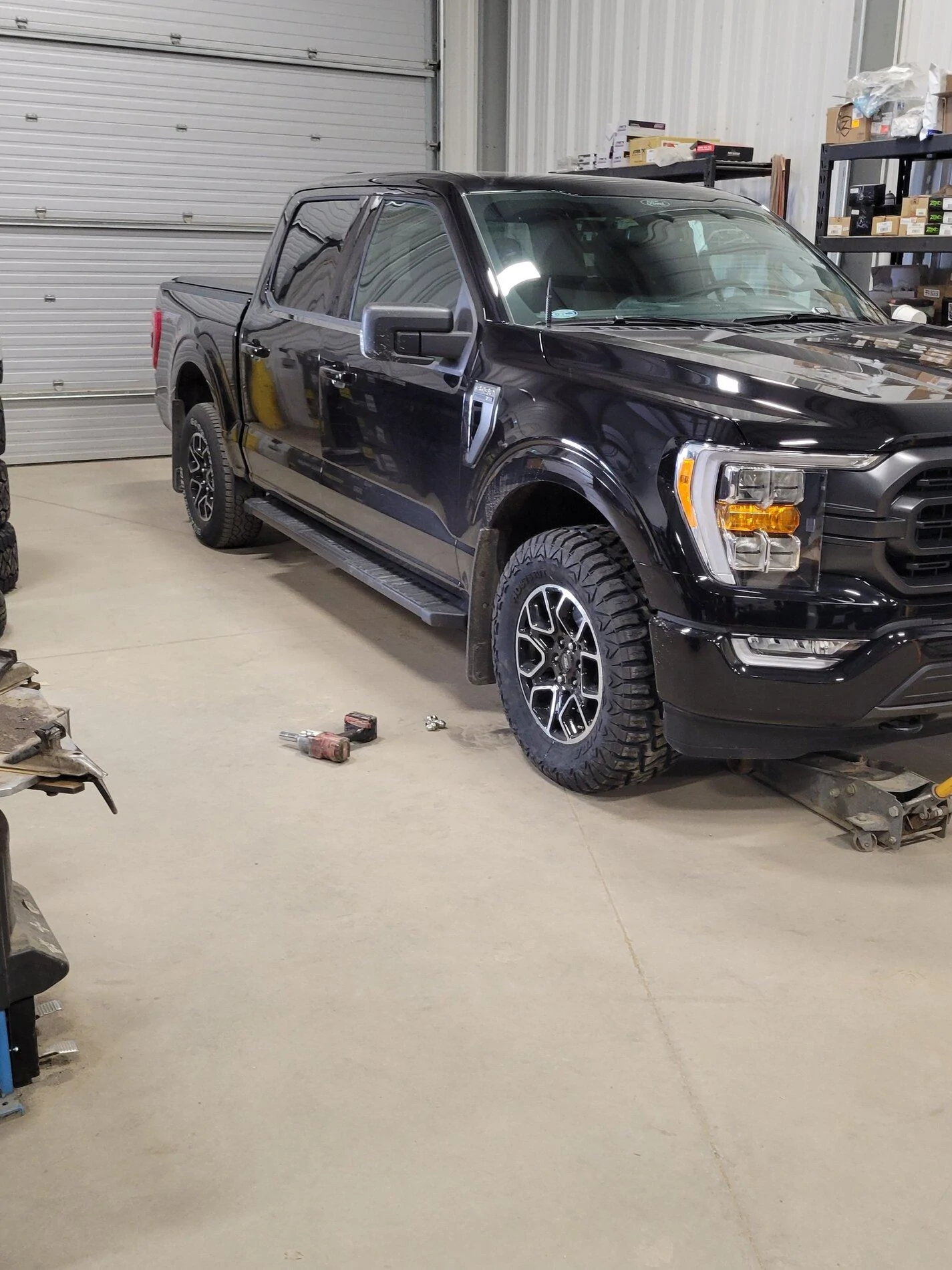

On a stock rim I test fit 33 x 12.5 x 18. No level. No rub.
thanks, do you think by pushing the wheel out a couple inches that there would be any rubbing on the outside of the tire to any bumper or wheel liner area ?
That I couldn't tell you sorry.
