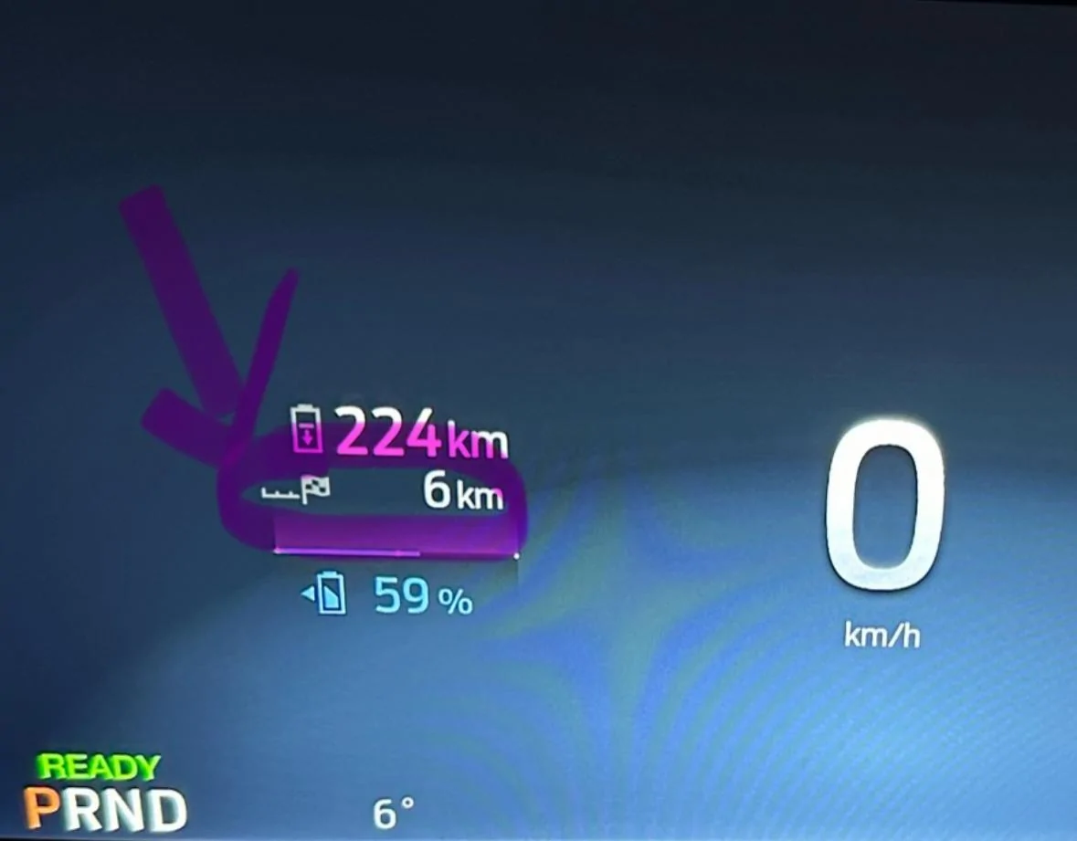

Anyone know what this symbol means? It’s a checkered flag and I cannot seem to find info anywhere.

Gimme_my_MME Well-known member Joined May 29, 2022 Threads 2 Messages 651 Reaction score 1,247 Location Dearborn Vehicles Grabber Blue First Edition Mustang Mach-E Occupation Engineer Nov 26, 2023 #2 6km until your destination
OP OP jetjaguar Member First Name Michael Joined Aug 10, 2023 Threads 2 Messages 7 Reaction score 3 Location Canada Vehicles Lightning Nov 26, 2023 Thread starter #3 Thank you. I don’t think I input any destination . Only using CarPlay. I guess I could’ve hit something. Cheers!

Maquis Well-known member First Name Dave Joined May 20, 2021 Threads 9 Messages 4,315 Reaction score 5,768 Location Illinois Vehicles 2021 Mach-E E4-X; 2023 Lightning Lariat ER Nov 26, 2023 #4 jetjaguar said: Thank you. I don’t think I input any destination . Only using CarPlay. I guess I could’ve hit something. Cheers! Click to expand... Known bug. Clear it by going into the Ford nav, entering a destination, engage the route, then cancel.

OP OP jetjaguar Member First Name Michael Joined Aug 10, 2023 Threads 2 Messages 7 Reaction score 3 Location Canada Vehicles Lightning Nov 26, 2023 Thread starter #5 Maquis said: Known bug. Clear it by going into the Ford nav, entering a destination, engage the route, then cancel. Click to expand... Brilliant! It cleared doing that. Thank you.
