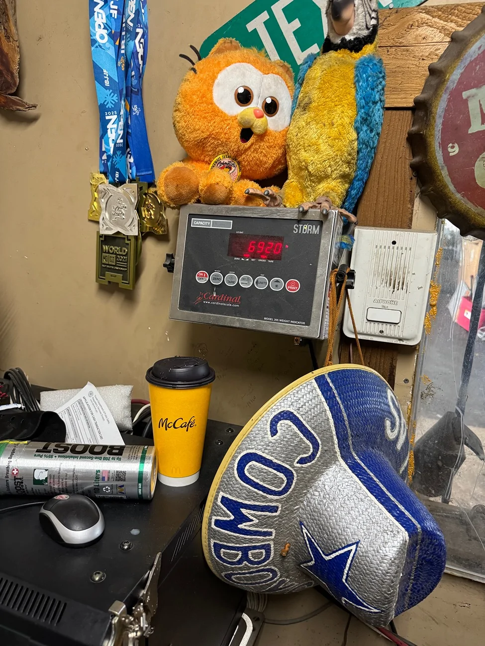

My lariat ER with less than 100 pounds of stuff inside 6920 lbs!
Ford F-150 Lightning Interesting Article On Current Guardrails Vs EVs IMG_1564
