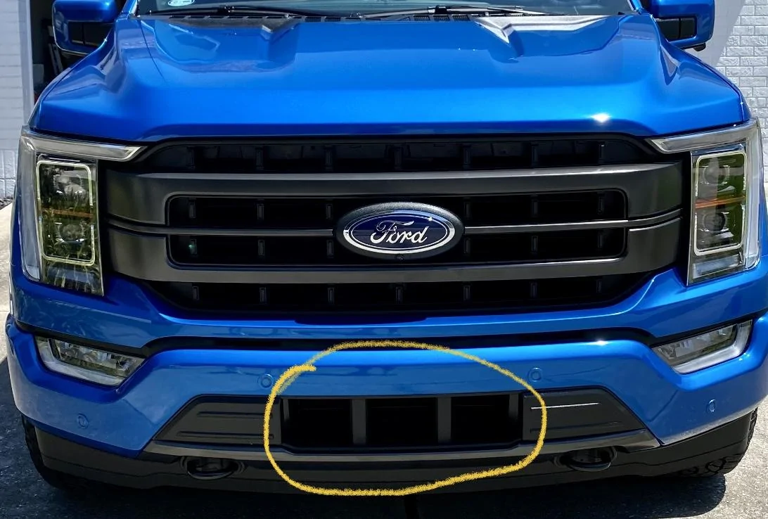

Well I'm planning on doing my first oil change on Monday so while I'm down there I'll make sure I can get that panel off without damaging anything. If you're up for trading at that point let me know.
That opening was one of the first things I noticed when they backed it off the truck. Without the license plate bracket on there it really looks unfinished. Especially with the gleaming white of the oil filter shining through at you. Took a while for someone to get back to mas as to why it had the EB panel on it and not the standard 5.0 panel.
