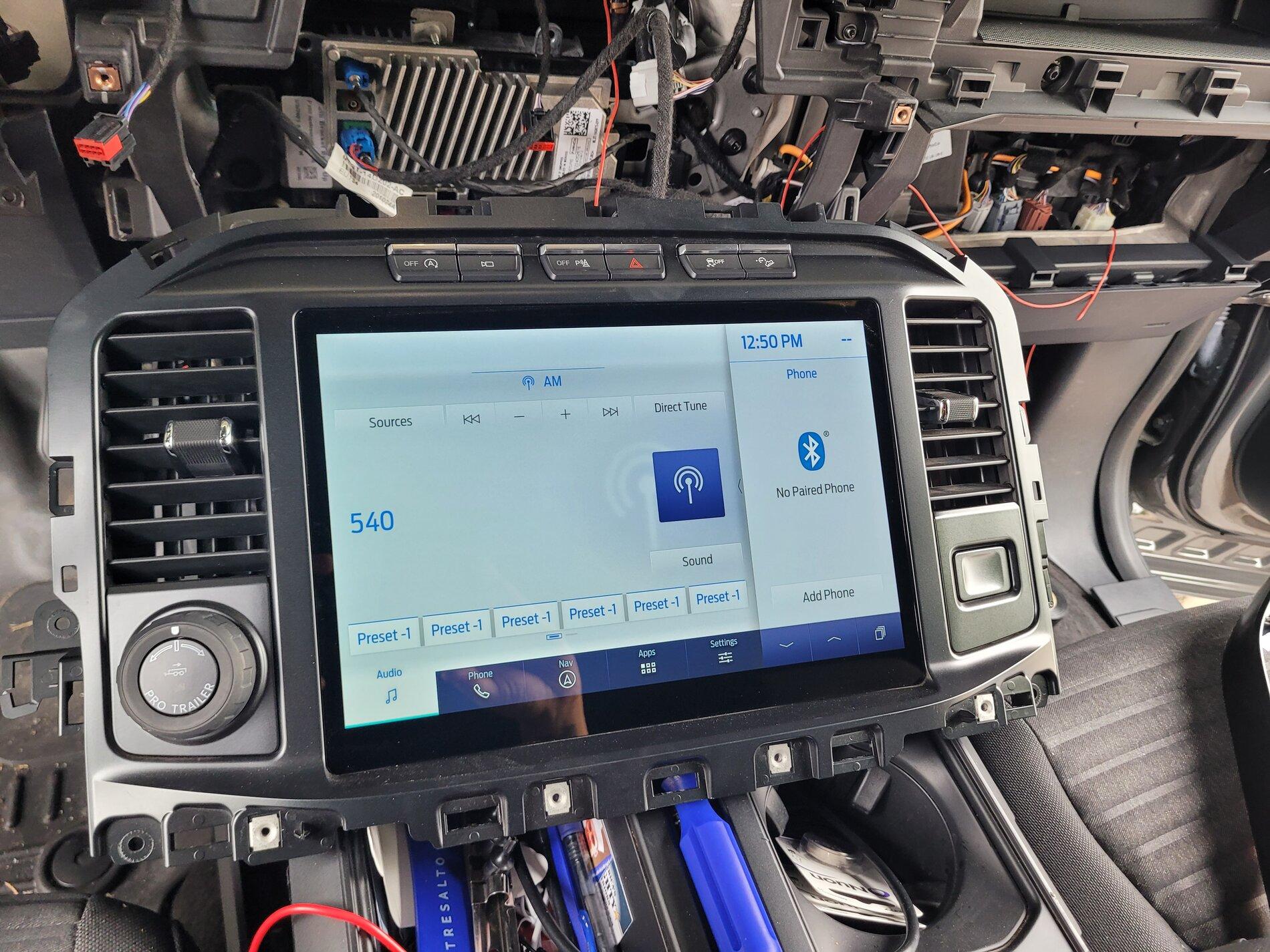

Did the 12" swap today. I need to figure out what the GPS harness is, and do some programming on it.

bro please tell me what the lower part is called with the hvac /volume? Also is it direct plug and play? Anything else needed beside screen and lower part??
No it's not plug and play. The part below is an hvac bezel. Pull a Vin from a truck that has this screen and order the part from ford.
Screen
Apim
Hvac bezel
2 harnesses
