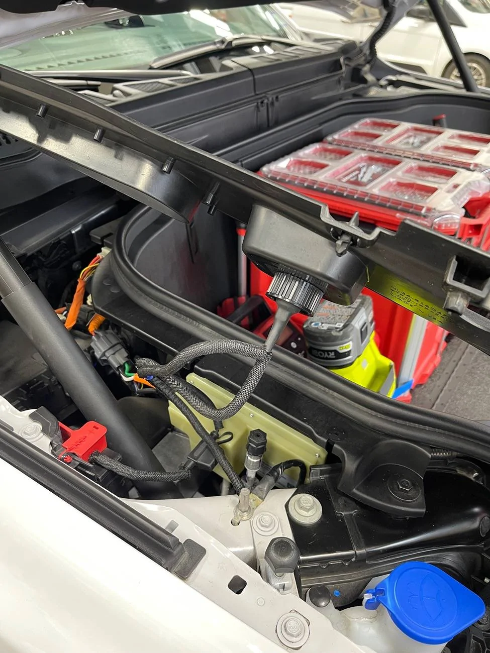

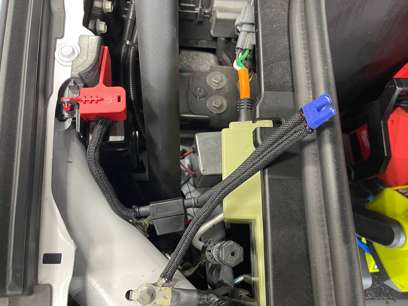

2023 F150 Lightning Lariat

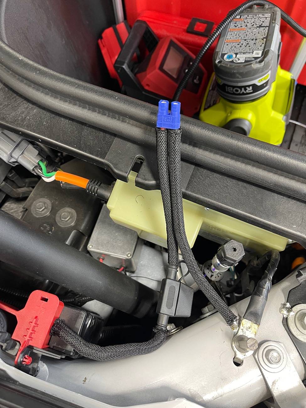

@Itaintfastenough Love your setup and it looks like a great install.
I'd like to recommend one small update - You have the negative charge lug under the main grounding lug. You should reverse this. The heavier main grounding lug carries much more current and should be in direct contact with the frame. The charge port lug carries much less current and should be mounted on top of the main grounding lug. I can't see the positive terminal but same for that. Always put the heavier lugs first on the contact surfaces. :)
