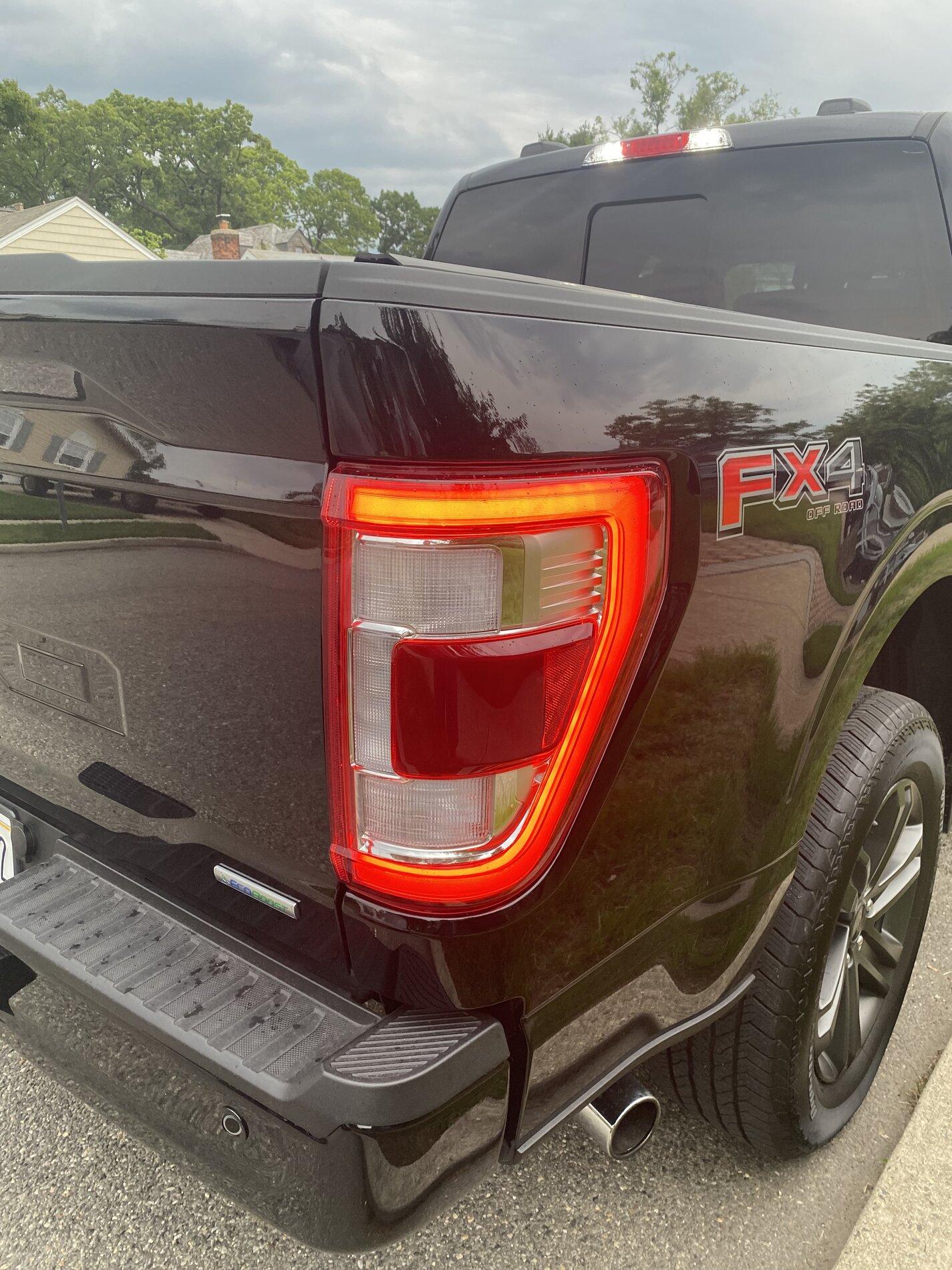

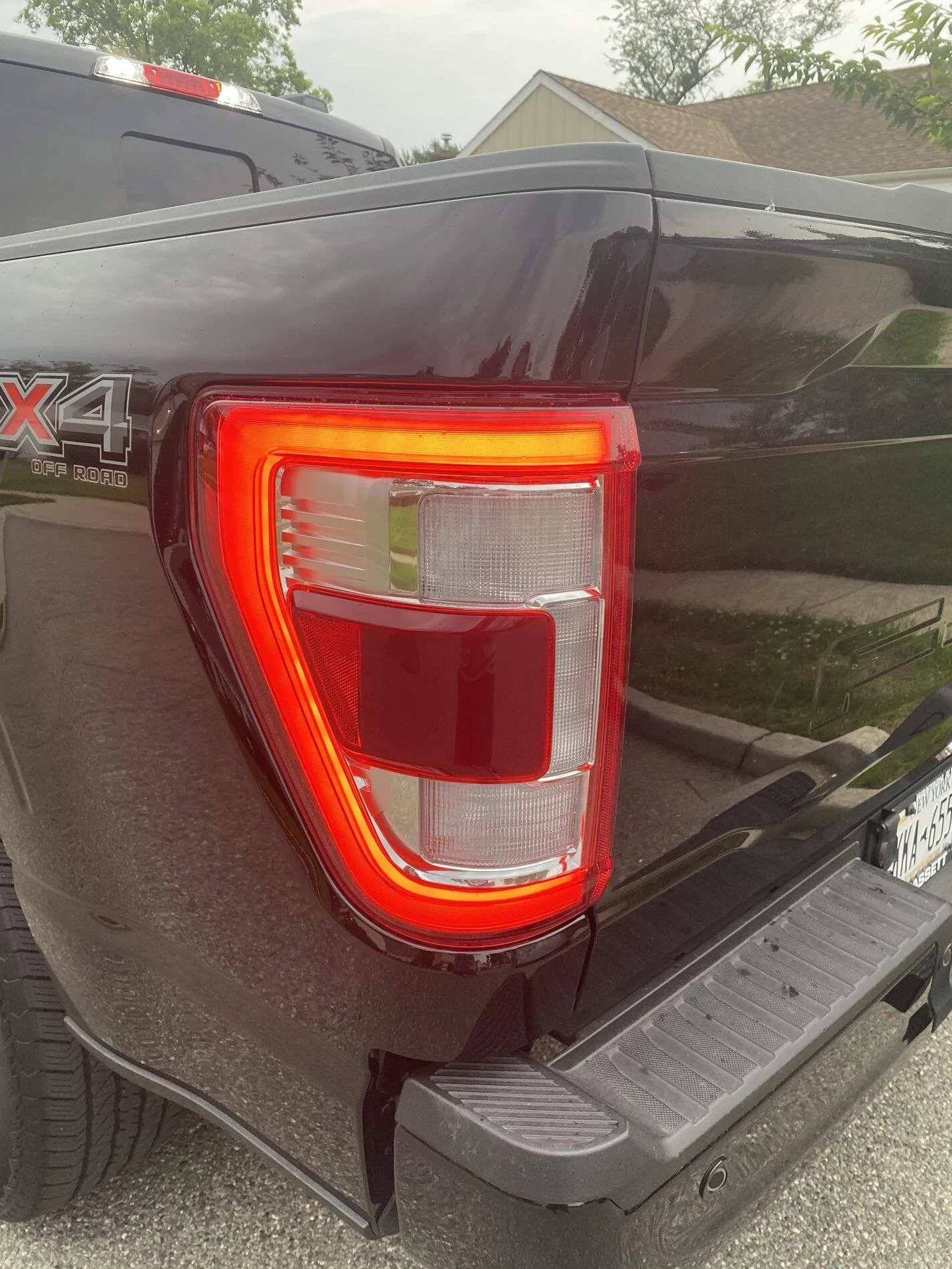

So I wanted to do this a while ago and got in touch with Boosted Greygoose a while ago and he took acre of me with an awesome set of LED taillights with BLIS and the adapters needed. I finally got around to putting them in this past weekend and can kick myself for not doing this sooner as I think they look so awesome! This was a pretty simple procedure as Boosted Greygoose gives you everything you need. Both taillights took me about 40-45 minutes including a hiccup I had with Forscan. I'm a Forscan newbie so it was all new to me. Plus I took my time as I like to be meticulous when I do things. This was in daylight. They look so much better at night.

Just ordered this harness for this reason! I’ll never understand why Ford puts LED headlights but never the tails. Quick question, how long did it take to get shipped after you placed the order & how long did it take to arrive? I just placed an order for mine just yesterday afternoon.
Why Ford don't do it? Simple, money. 1. It makes people want to upgrade to bigger packages to get them. 2. Save $5 here, $8 there on each vehicle, after tens of thousands of vehicles, it adds up. Plus keeps entry price lower when combined with other less expensive parts. Makes the truck more attractive to casual shoppers.
Shipping was fairly quick. Don't remember exactly how many days but BG was good at giving updates. Install was easy, just take time and follow instructions.
