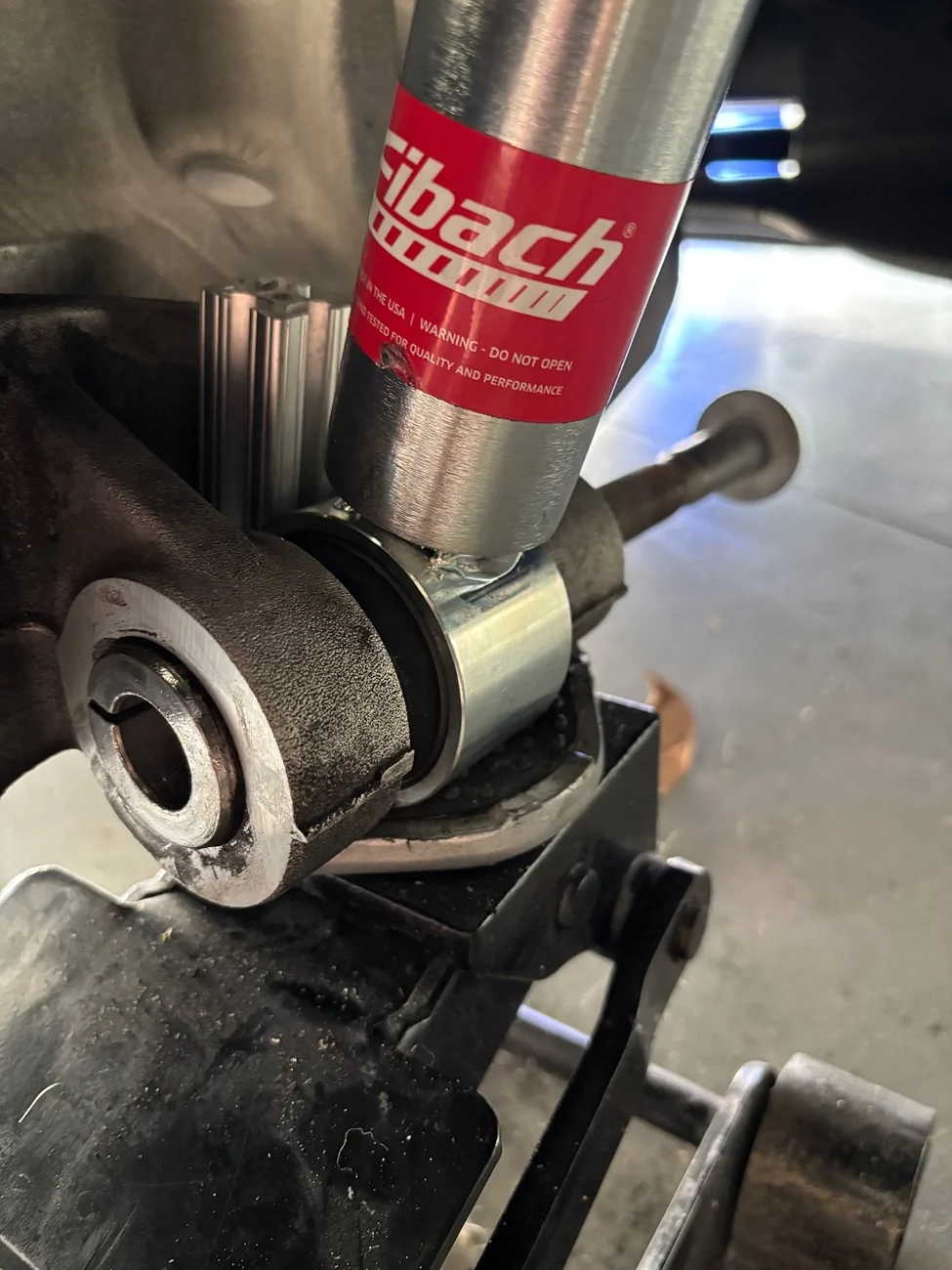

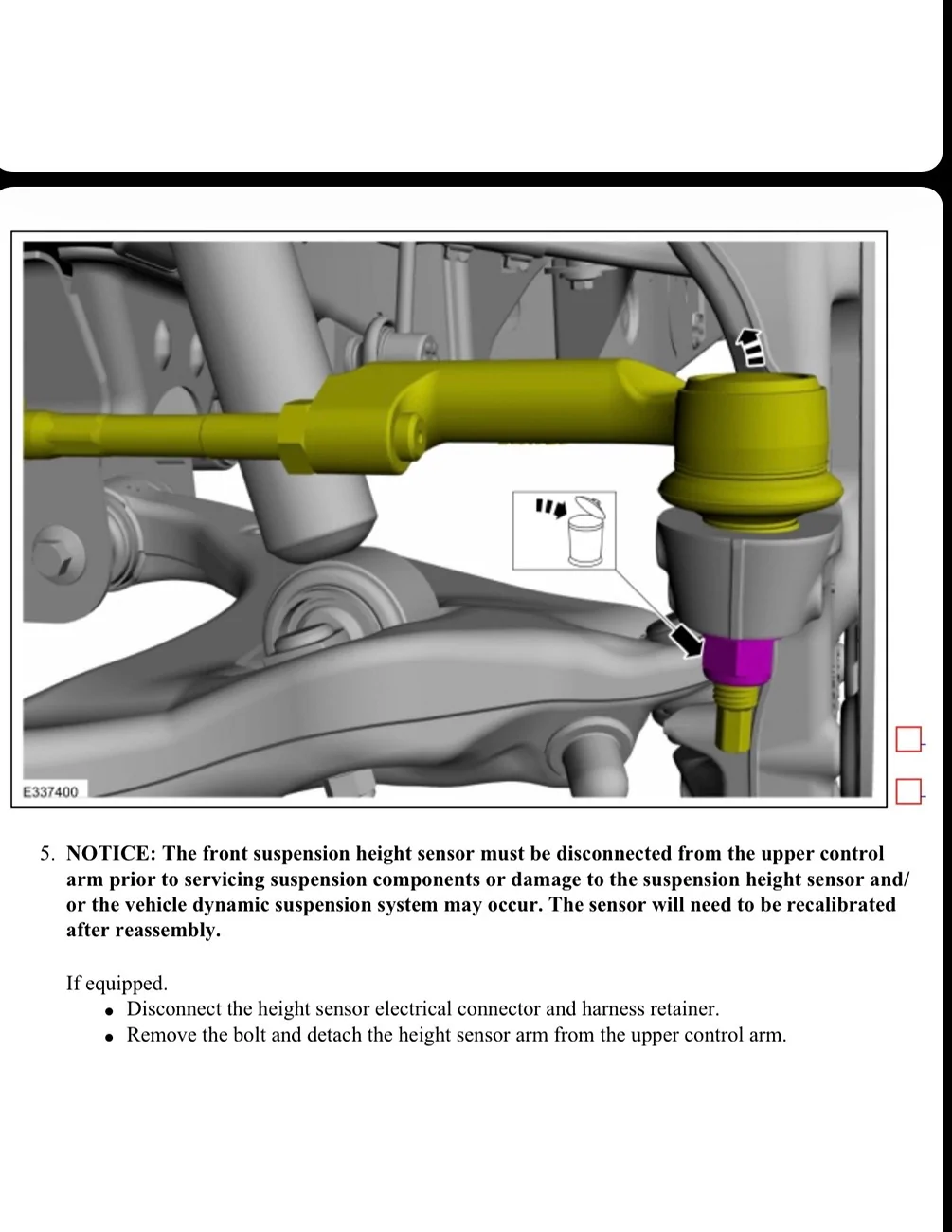

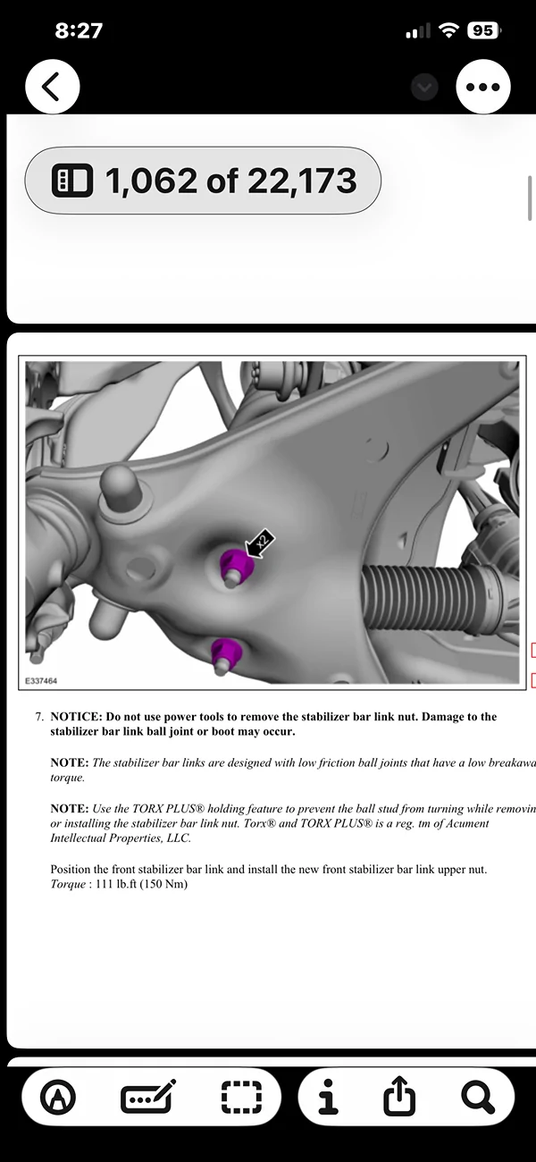

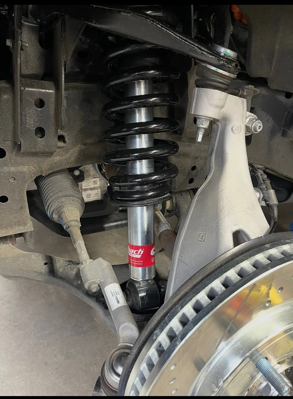

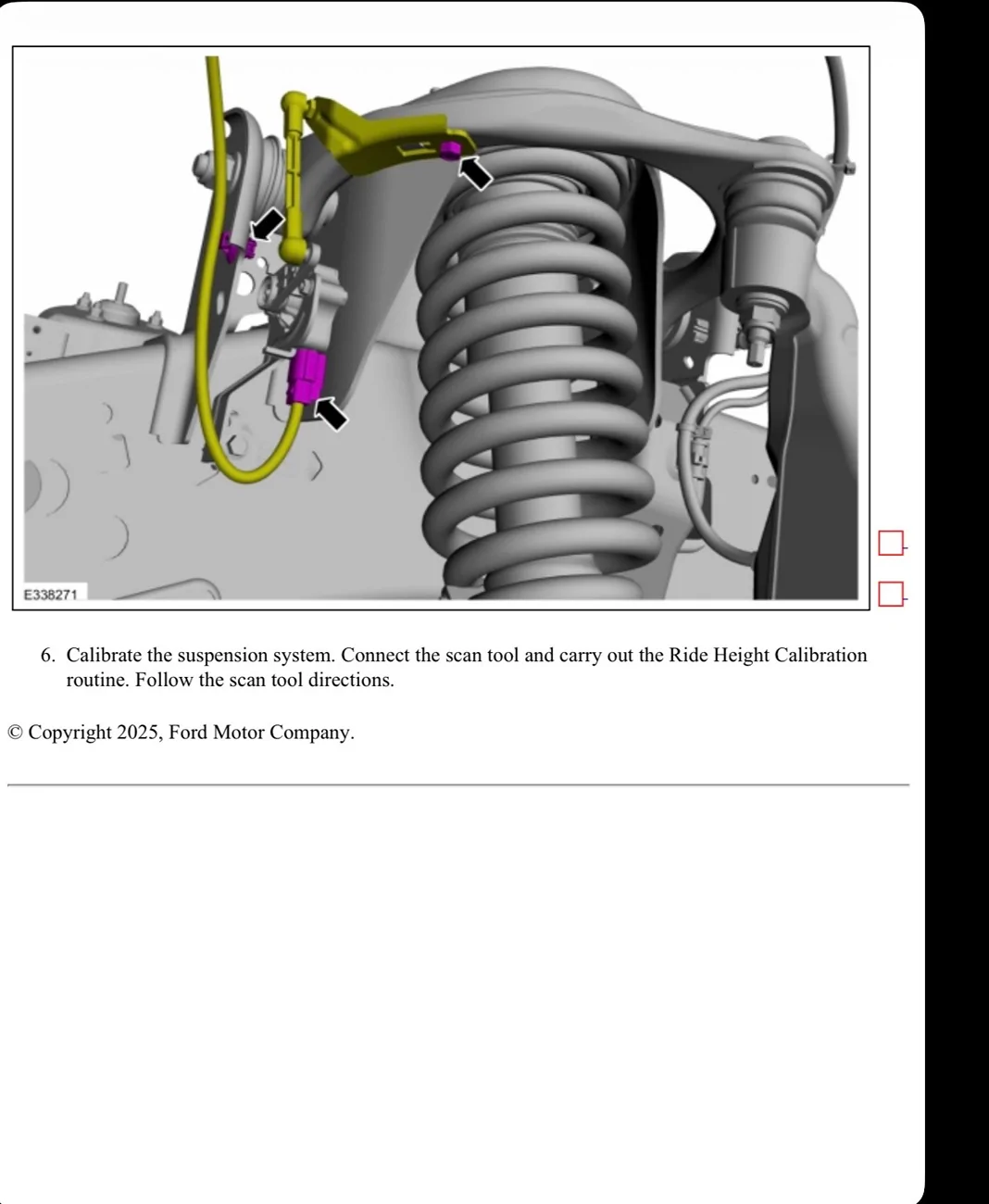

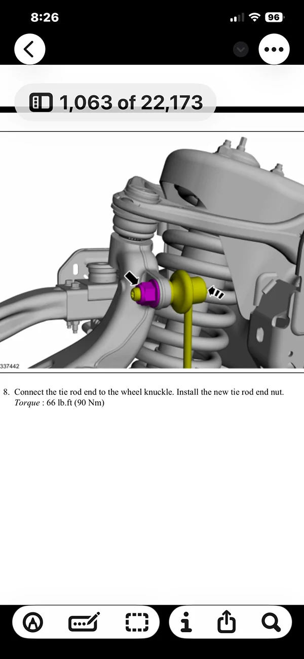

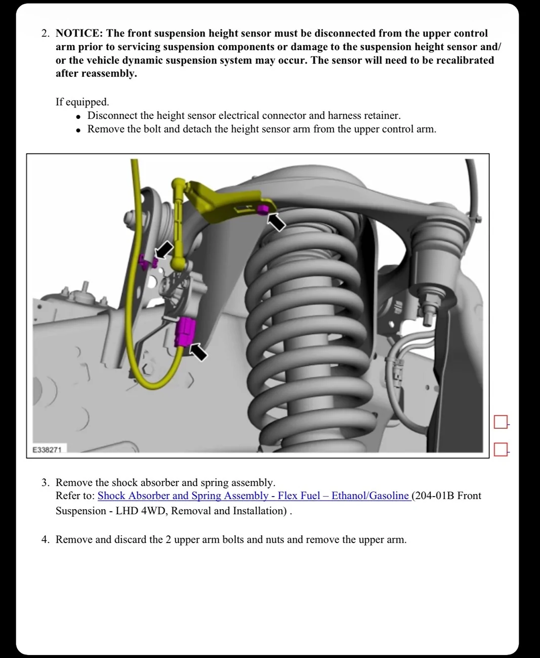

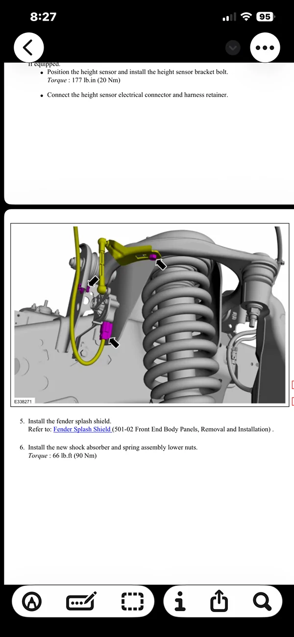

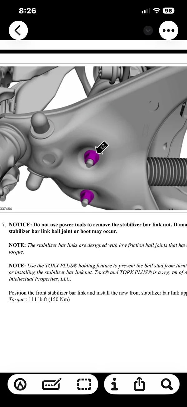

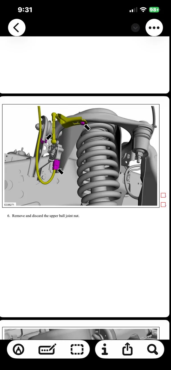

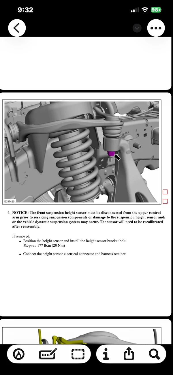

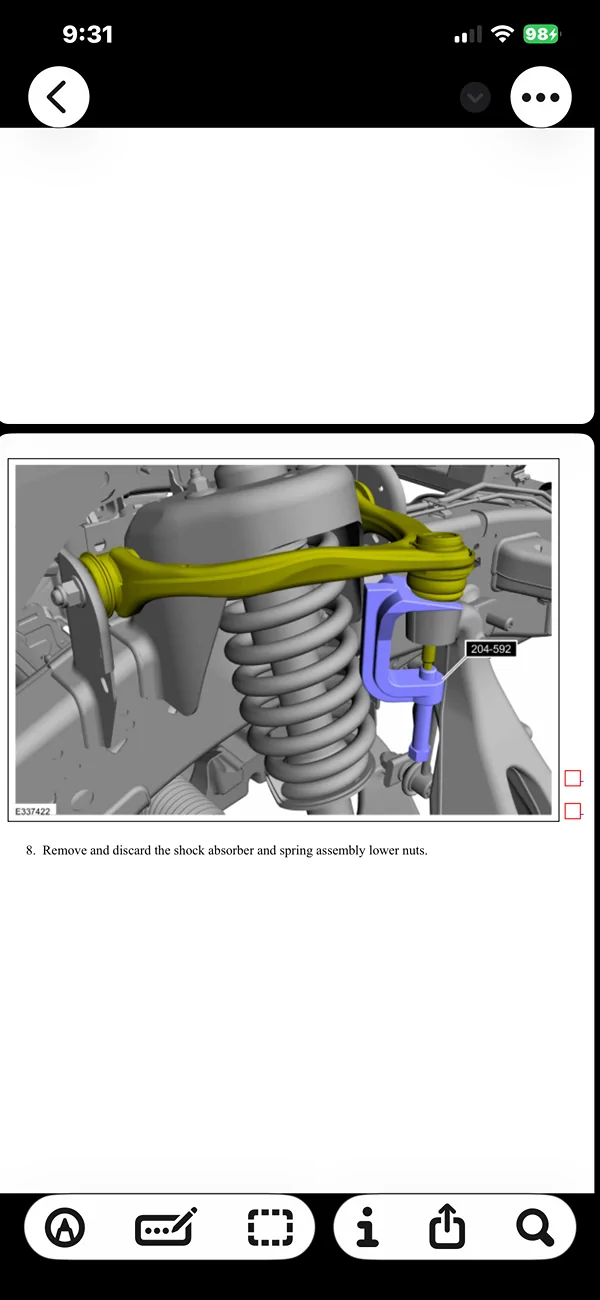

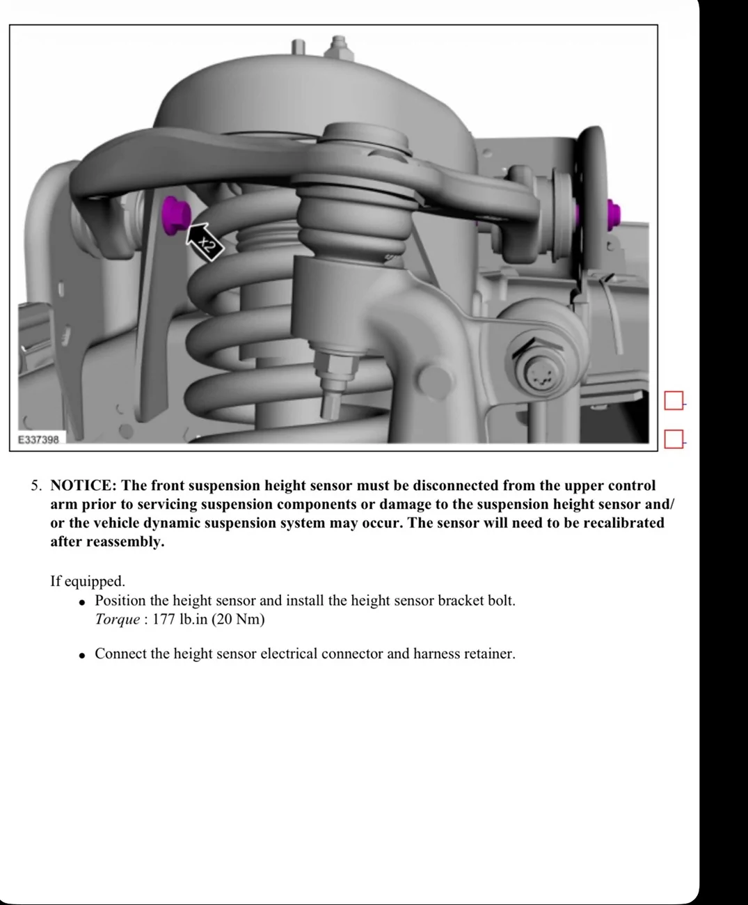

Just replaced mine with Eibach shocks… (you do Not need to remove front brake calipers, rotor, backing plate, or axle shaft nut) Hope this helps.

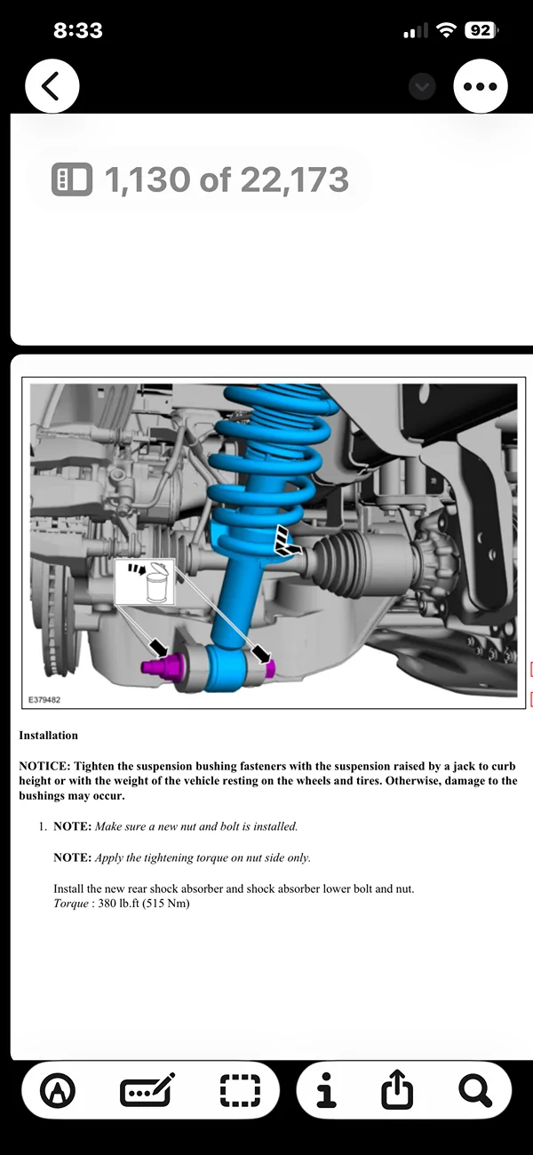

Ooooh You have made my day! A pizza and a sixpack of choice on me when we have a chance to meet!

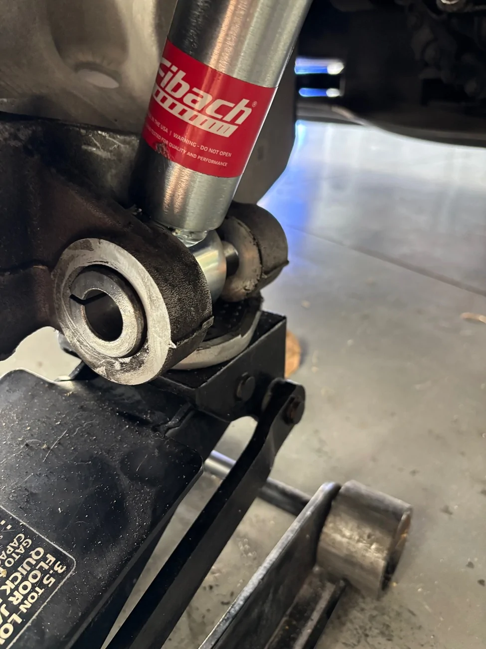

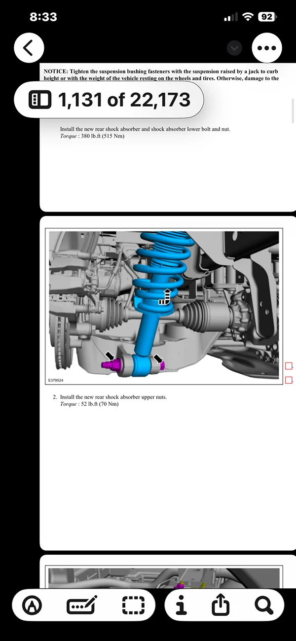

380 foot-pounds? Wow that is pretty tight on the rear shock's bottom mount. I really, really appreciate this info.
What are Your driving impressions now with the Eibachs all around and the Ford OEM springs? Also, how many of the OEM shocks were blown or leaking at their replacement?

Well, it was the highway speed porpoiseing (rebounds)after encountering a minor dip that prompted me to replace them… my mileage is low at just under 15K, and three out of four OEM shocks had lost their nitrogen charge. Even backing out of my shop, with a 1-1/2ā€ drop down from slab to ramp caused a couple of rebounds… That’s all gone with the Eibachs, and was the first thing I noticed. Highway speed dips are now smoothed out, with an overall improved feel one would expect from a quality shock. I’m running stock size Michelin tires with aftermarket 9and3 wheels with stock offset (+44) and stock ride height. Yeah, I agree, that bottom rear shock nut (30mm socket) is a tough one to break free and tighten. Had to us my 3/4ā€ torque wrench rated up to 600ftlbs to tighten it. Caution! Make sure you support the rear swing arm when doing so! Also, don’t get frustrated when jacking up the rear coil over assembly to align with the bottom bolt hole… I wound up using a 1x1 square tube (about 6ā€ long) between the bottom shock mount and swing arm to help keep it from being pushed to the rear while jacking it up. I did however experience frustration when I was finished, and putting up my tools, that I noticed a rear shock ā€œbump stopā€ sitting on my workbench! Had to pull that rear shock assembly out and dismantle it again..😔 It’s not that hard to do, take your time… it’s worth the time and $ invested… Good luck! šŸ¤—

... putting up my tools, that I noticed a rear shock ā€œbump stopā€ sitting on my workbench! Had to pull that rear shock assembly out and dismantle it again..😔 It’s not that hard to do, take your time… it’s worth the time and $ invested… Good luck! šŸ¤—
