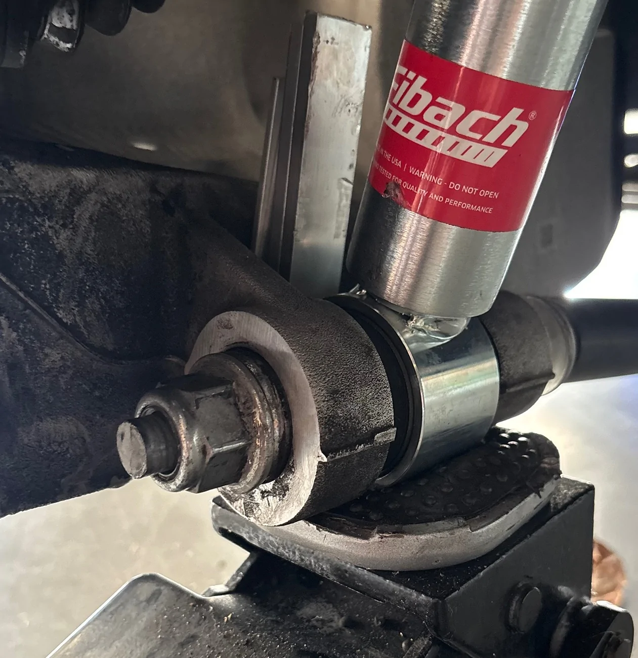

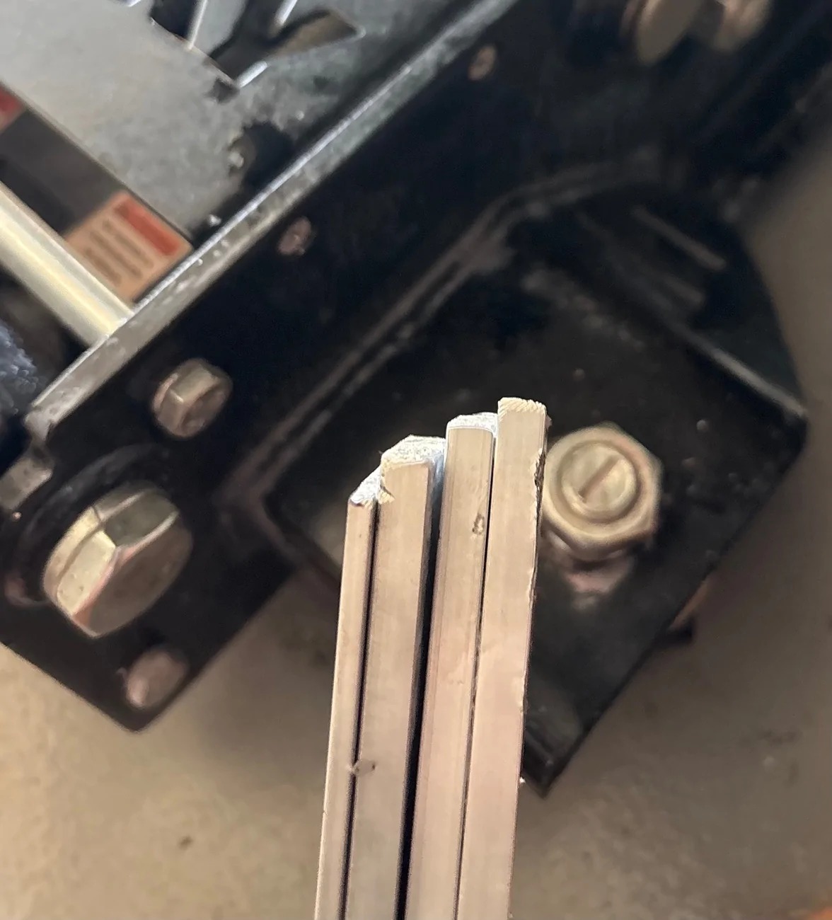

Reference for future DIYers… 7/8” worth of aluminum bar shims was the magic number to get the shock to line up with the mounting hole when compressed with a floor jack. After running the bolt through and taking the pressure off the jack, the shims fall right out
