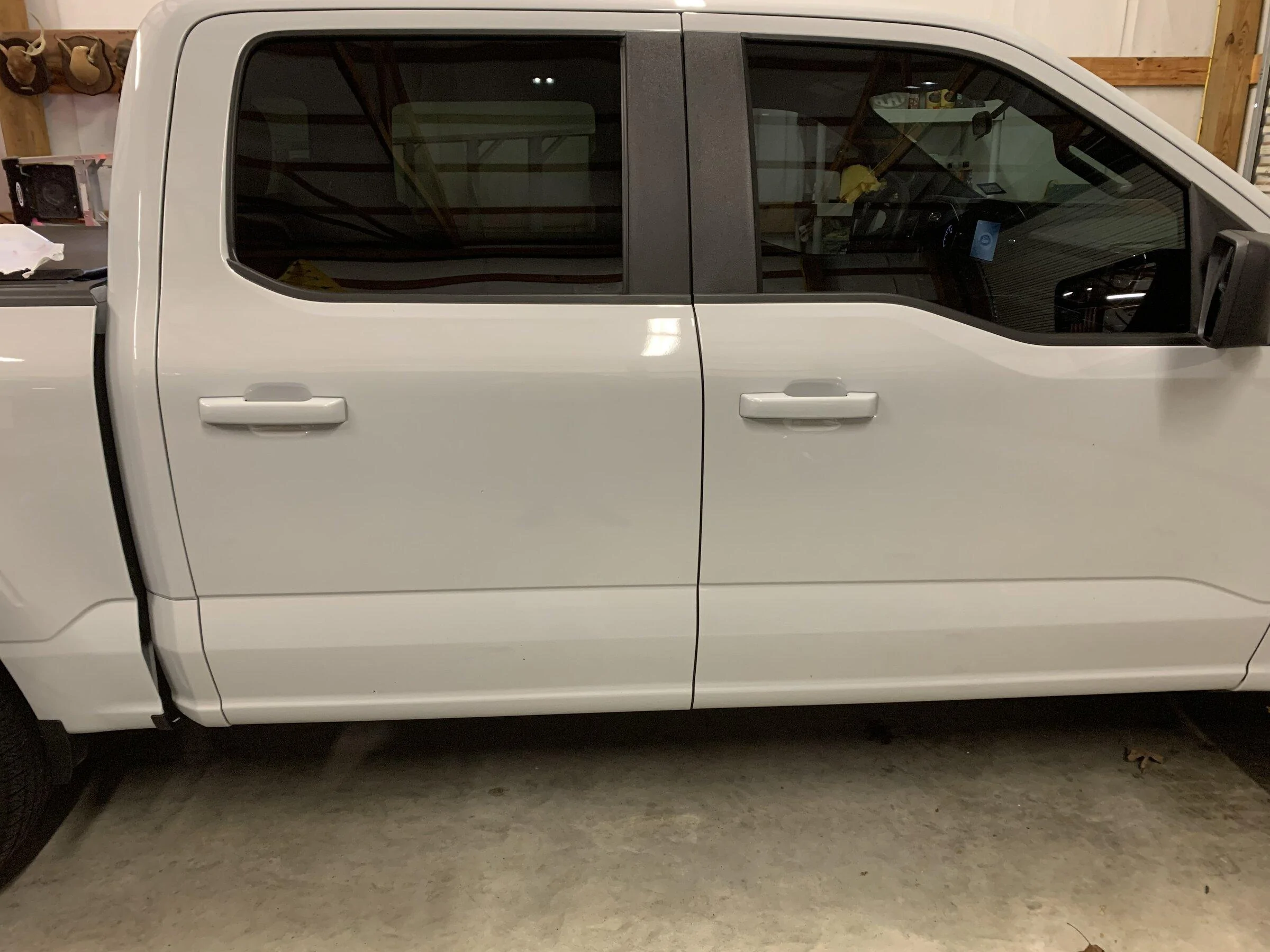

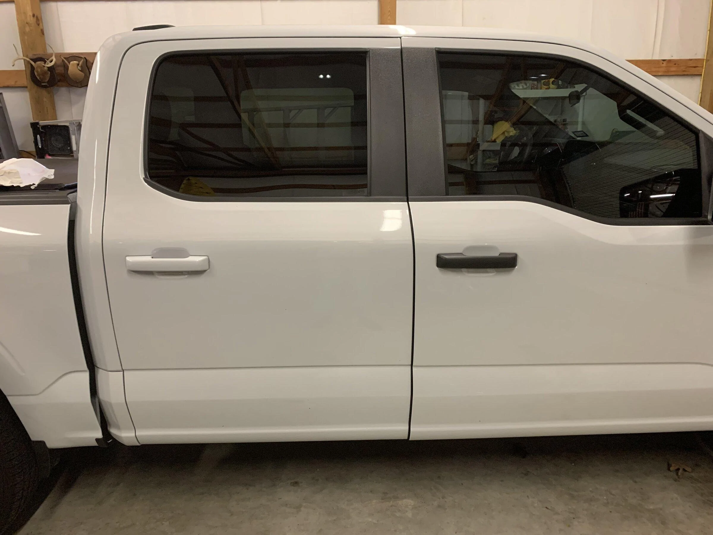

I ordered paint matched door handles through BFN truck shop during Black Friday, my handles arrived yesterday. The paint quality and paint match is spot on. I have a space white metallic truck?!

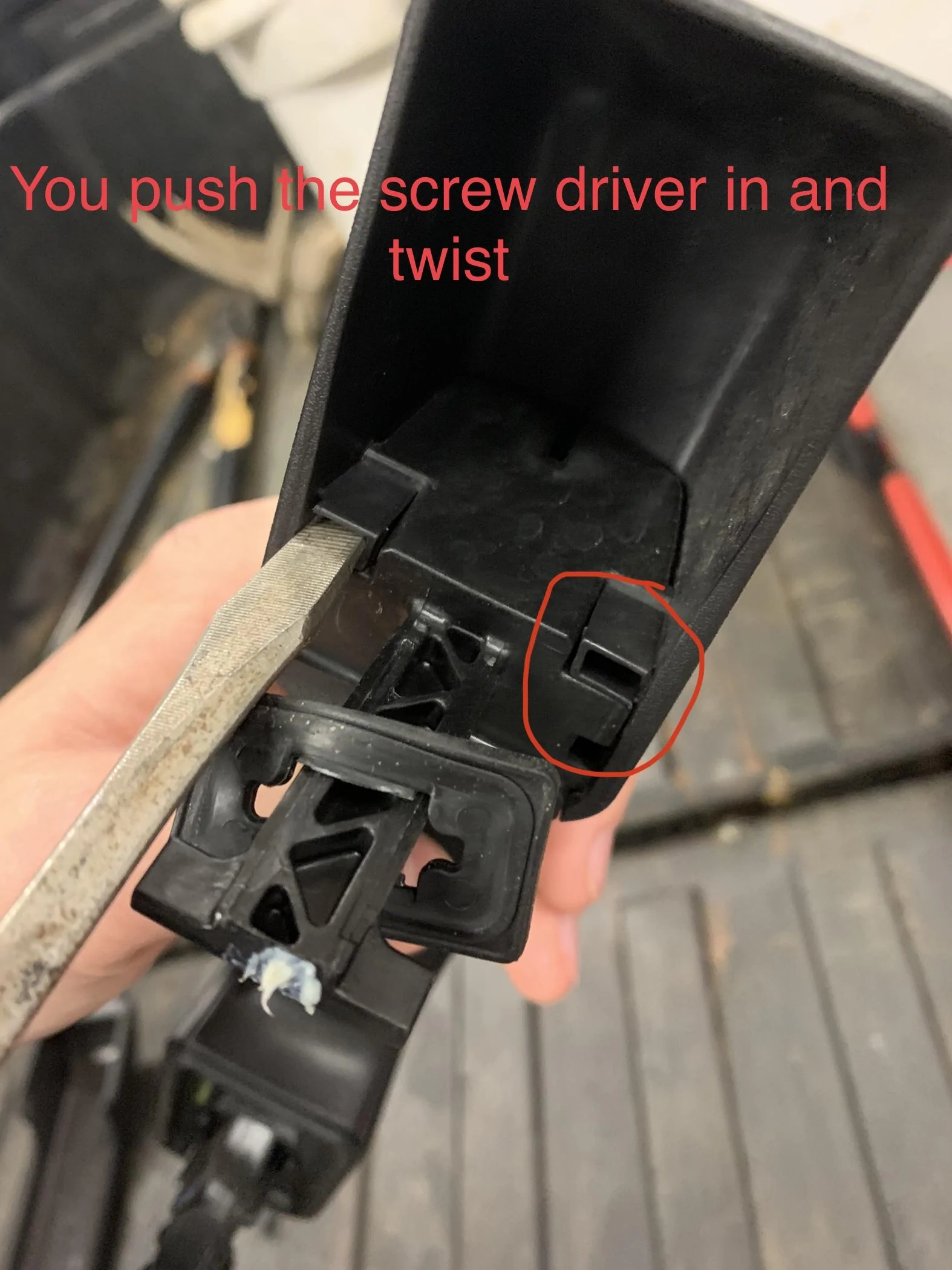

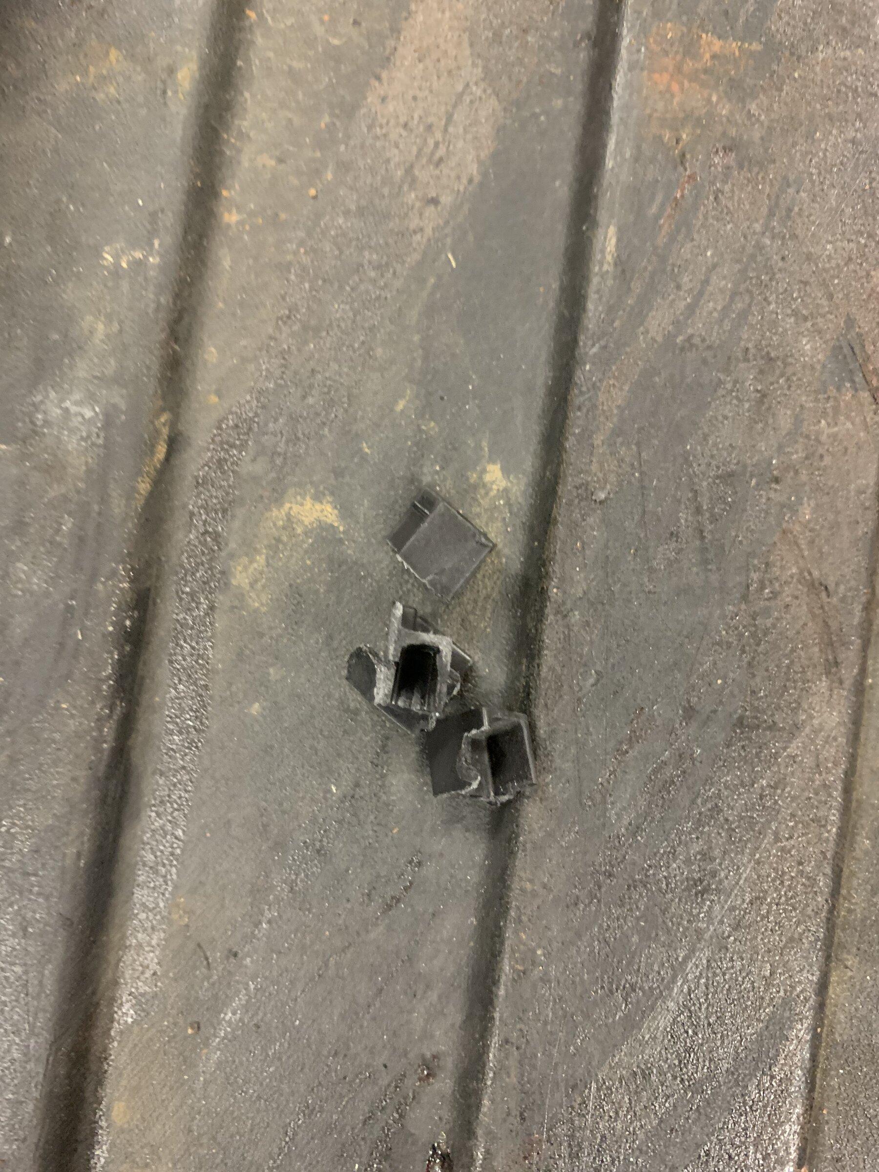

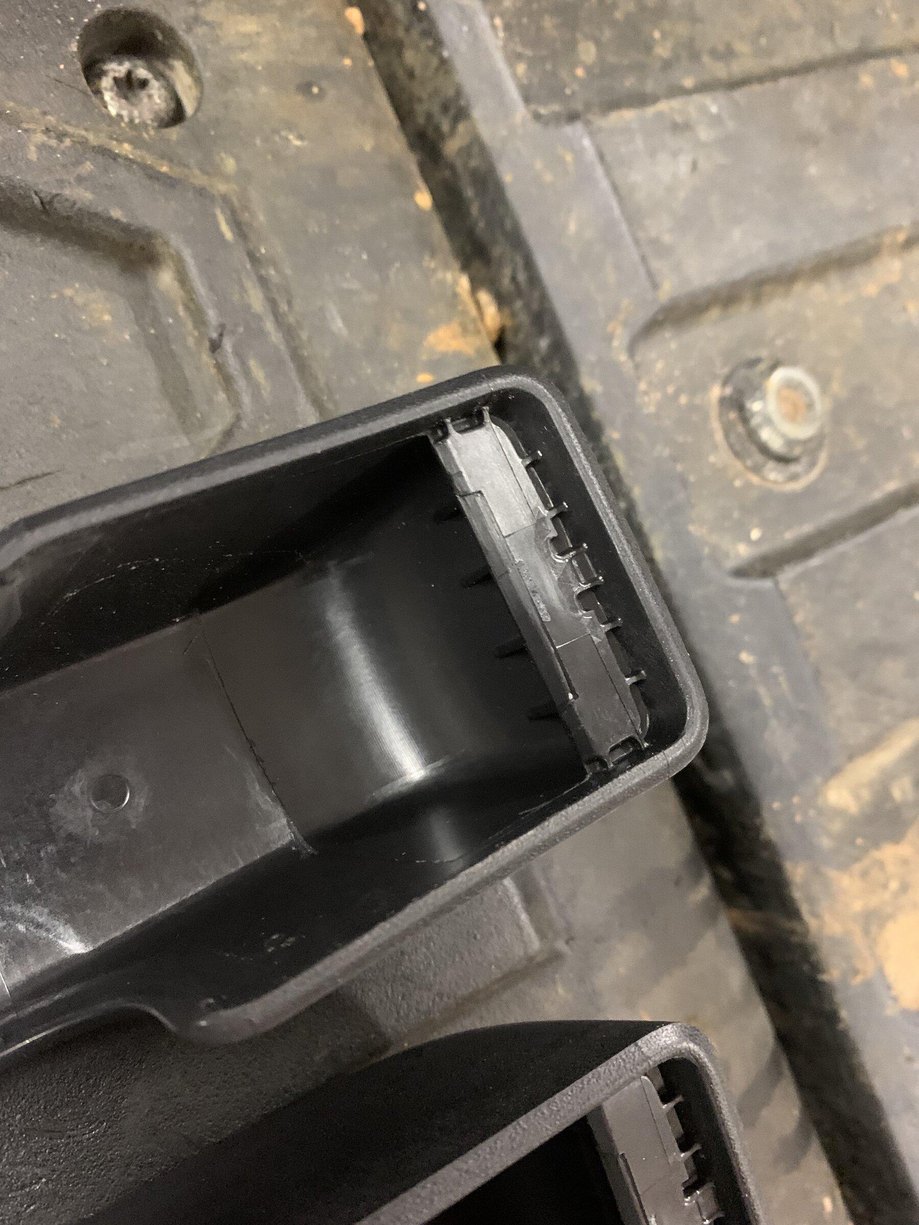

What I learned is that the back tabs have to be broken for install. You just push a flathead screw driver in and twist. Also to remove the front slide in clip just tap the bottom on a hard surface and it will come free. If you have chrome or plastic handles do it the right way and order paintable oem ones or order through BFN, don’t hassle with painting plastic or chrome!
When you are trying to reinstall the handle do the opposite until popping the back into place. Once you are at this step first slide your socket back onto the set screw then slowly tighten it while firmly pushing the handle.
EDIT, you can do it without breaking the tabs but I can’t figure it out, I have black plastic handles so I’m not real worried
