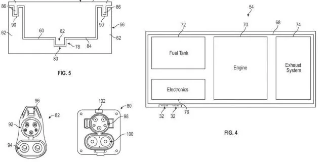

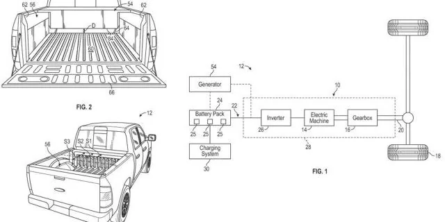

The Drive has discovered a patent filed by Ford that describes a generator that can be installed in the bed of an electric pickup to provide extended range capability for when the main battery runs out of charge.
Ford F-150 Lightning Patent shows how electric F-150 EV could be powered by gasoline GENERATOR-2

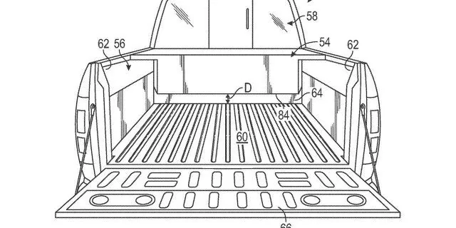

The package slides into the front of the bed like the utility chests commonly used in pickups and would allow an owner to temporarily turn their truck into a plug-in hybrid, like a Chevrolet Volt or BMW i3 REx.
Details on the powertrain contained in it aren’t mentioned, but a diagram of the device shows it to contain an engine, fuel tank, exhaust system and control electronics.

Interesting your spin on that. If there's no ICE then it does not count as a PHEV.
Perhaps I misread the original post. I thought you were saying that the range extender contains "an engine, fuel tank, exhaust system and control electronics" which an EV doesn't have.
Or are you saying that this is a completely separate device from the truck itself, with the truck being a full EV with good range?
From what I wrote about and read as well it's a total EV system and the generator is just some kind of power supplement.

Initially, I was sad that they didn't allow the option to charge the Lightning with a generator while driving. Why couldn't they just put a J1772 port in the bed that could charge from any EVSE/generator while in motion?
I'm less sad now that I realized that I'd only be able to add ~8 kW/h if able to charge with a 32 amp EVSE while driving. That's probably only going to amount to 15 miles of range/hour at best and would take less than 5 minutes to draw 8 kWh at a 100kW DCFC. Range extenders make sense for small, super efficient vehicles like the BMW i3, but not so much for full-size trucks.
I'm sure that the mechanism in the patent would generate more than 32 amps, but the money invested in a range extender is probably better spent on a bigger battery pack or faster DCFC charging architecture.
This functionality would be a unique selling point, though, and I wouldn't complain if it became a reality.
Someone please correct me if my math is wrong!

I was disappointed too, but I think you have a good perspective on it. I do think it would sell better though if they had a bed R-eX. For a couple thousand you can get an 8000W sine wave generator, so 8kWh. At 200 Wh per mile (a conservative 5 miles/kWh) you could get an extra 40 miles charge/hr. I really like the idea of this, especially for trailering.
