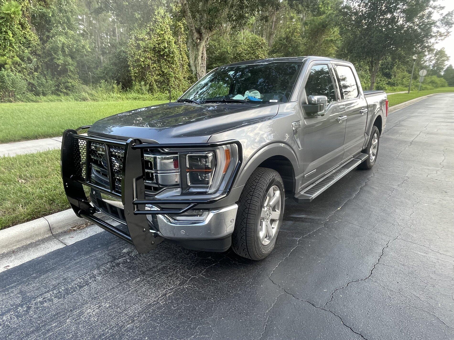

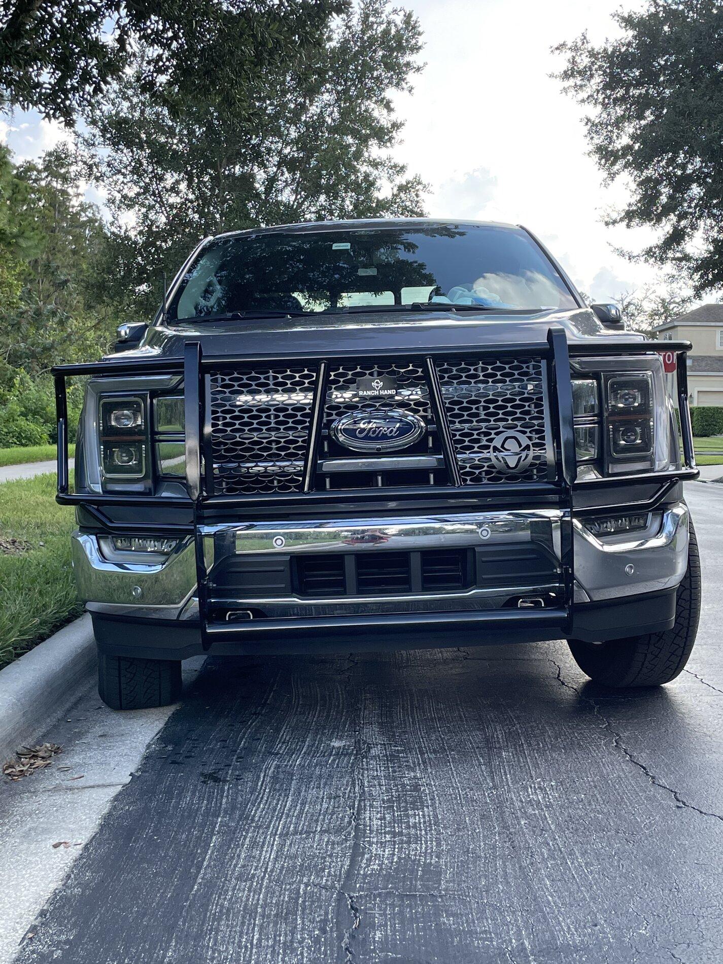

Finally got my Ranch Hand Brush Guard from Trails End Truck. Their service was top notch and I was very glad I cancelled my Order with BumperOnly to order from them. I think they got them in faster than they expected to, but communicated with me instantly. It was a very simple install and I wound up reusing the factory hardware instead of the hardware Ranch Hand sends with the brush guard. You can definitely see it from the 360 and front camera, but it is not so intrusive that it renders the camera useless. No sensors are blocked, but so far I've only driven it around the neighborhood. I have a few pics attached.

I tried to send you a PM??!! I really do like grill guards, but maybe it is because we have deer and hitting one isn’t pretty. Glad to hear that all of your sensors function!! In my opinion, Ranch Hand are top of the line!

Not sure why it wouldn't let you PM me, but I had looked at Bull Bars and seen them described as "damage multipliers" so I figured I'd go with the full guard.

I will need one of these once I get a new truck. Is there a specific model number or does Ranch Hand just make one to fit the '21?

The re-engineered the product that was on the market, the previous part number was GGF18HBL1C and the new part number is GGF21HBL1C, but still compatible with back to 2015.

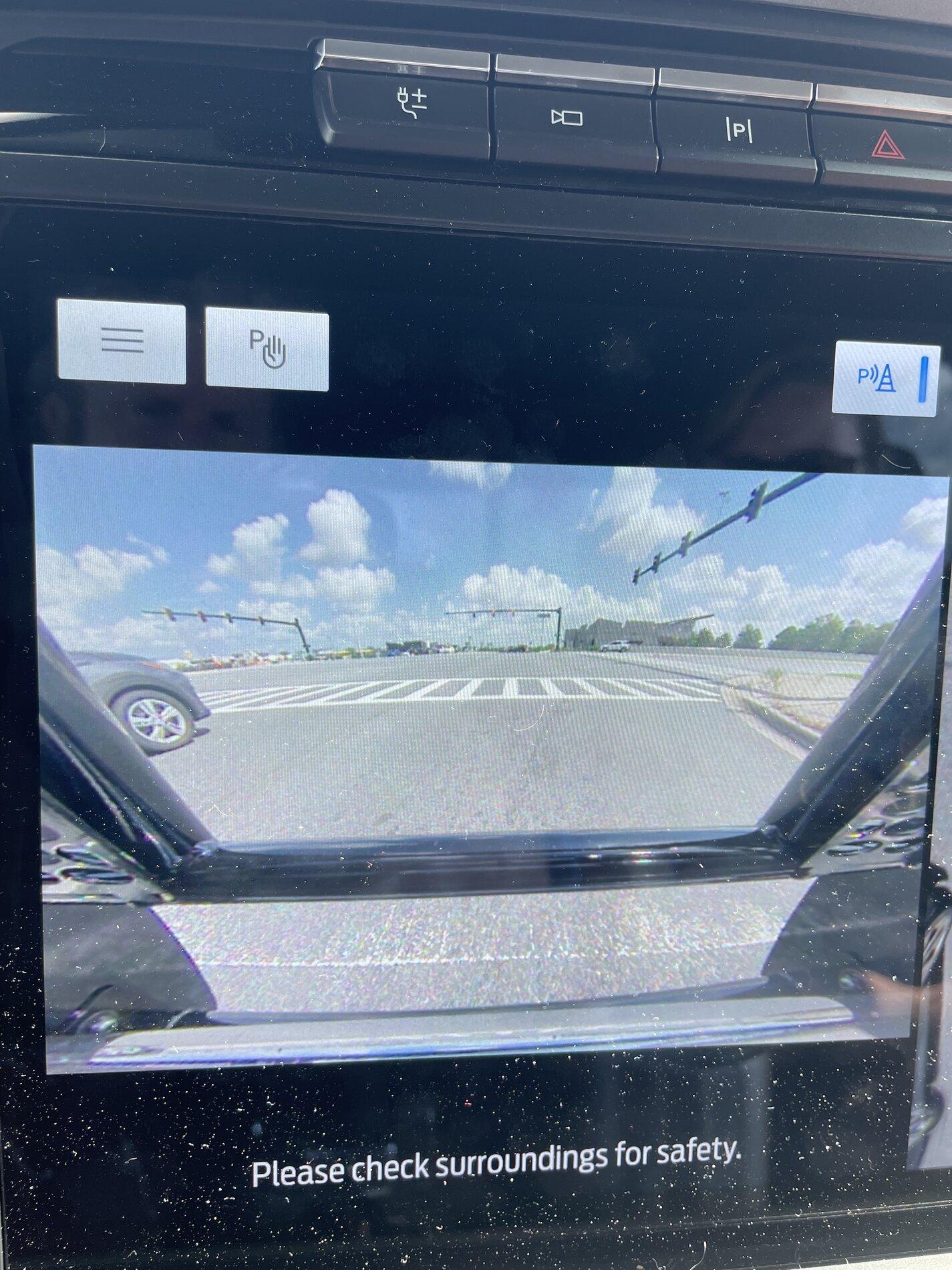

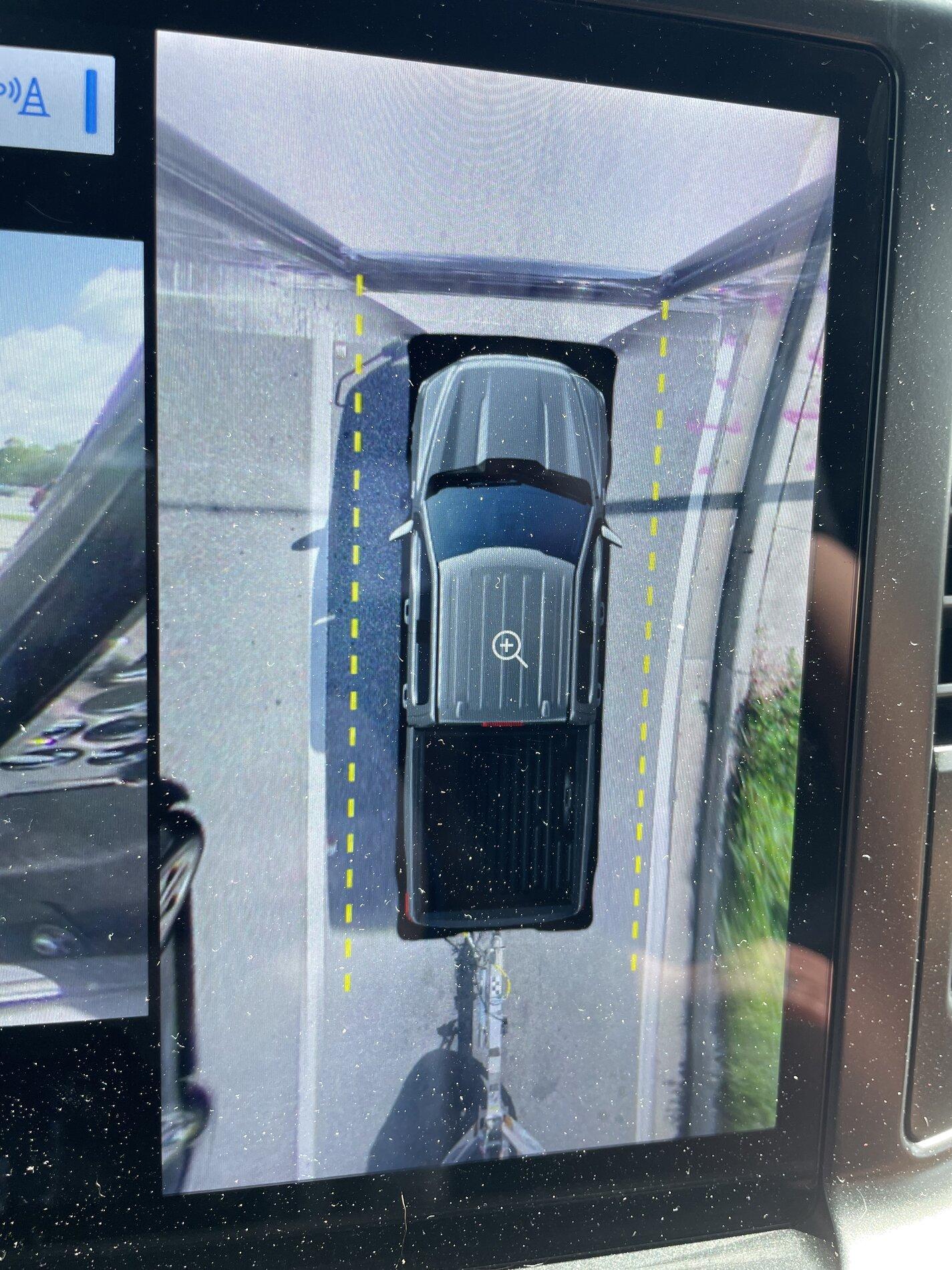

Not bad, can you get a pic of what the front camera looks like on your screen

Sorry for the delayed response but pics attached. After driving around town a bit I do get the warning notifications for the sensors if I brake hard. Probably just need to adjust it, but it isn't a huge bother.

I just called my local Ranch Hand installer to order and he said there should be zero sensor alerts and no image of the grill in the front camera. The issue remains the brackets. They do not mount properly due to changes to Ford relocating various parts for 2021 engines. The cut out grill guard is the correct one but the factory brackets are not correct nor are older ones. They can shift under load setting off alerts and even vehicle damage if they loosen up. He is waiting for correct Ranch Hand brackets for a 2021 guard he has now for another customer before he will order one for me. We both have the 3.5L Ecoboost engine.

That is interesting, when mine arrived it had the new part number on it, but I guess it is possible it was still old brackets. I guess once your dealer gets yours ordered and installed if your sight picture is better I'll try to source different brackets from Ranch Hand directly. Thank you for providing this update!
