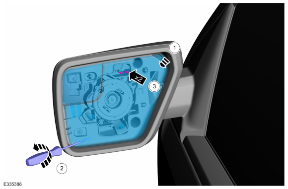

  1. Remove the exterior mirror glass.
    1. Position the mirror glass in and up.
    1. Using a flat blade screwdriver separate the exterior mirror glass from the exterior mirror motor.
    1. NOTE: The number and location of the electrical connectors will vary based on mirror option content.
      Disconnect the exterior mirror glass electrical connectors.
