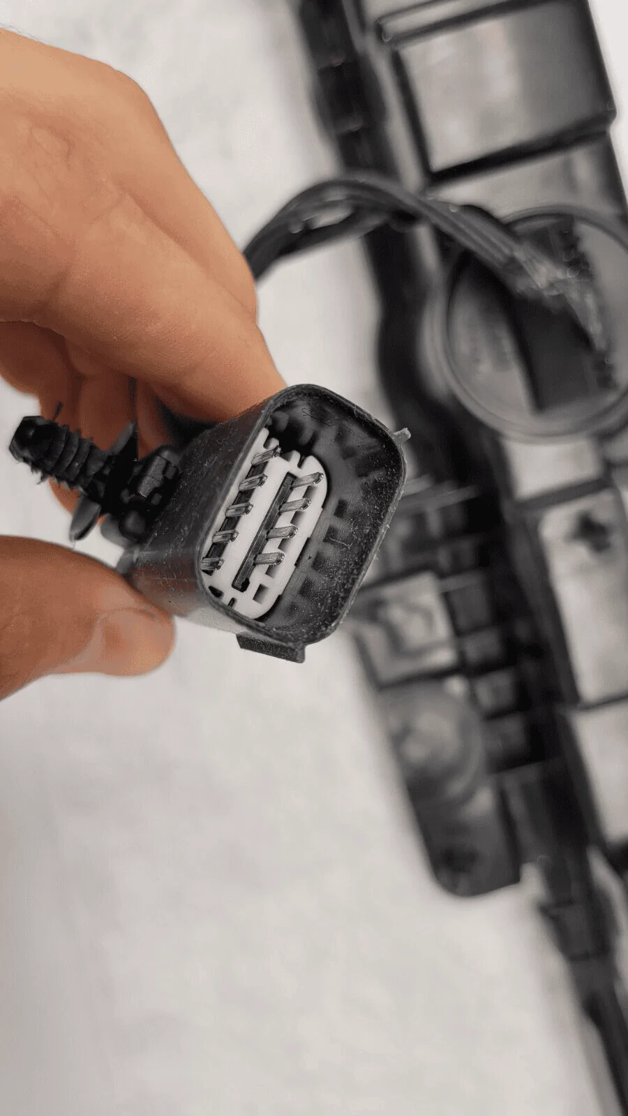

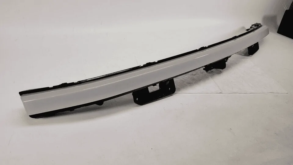

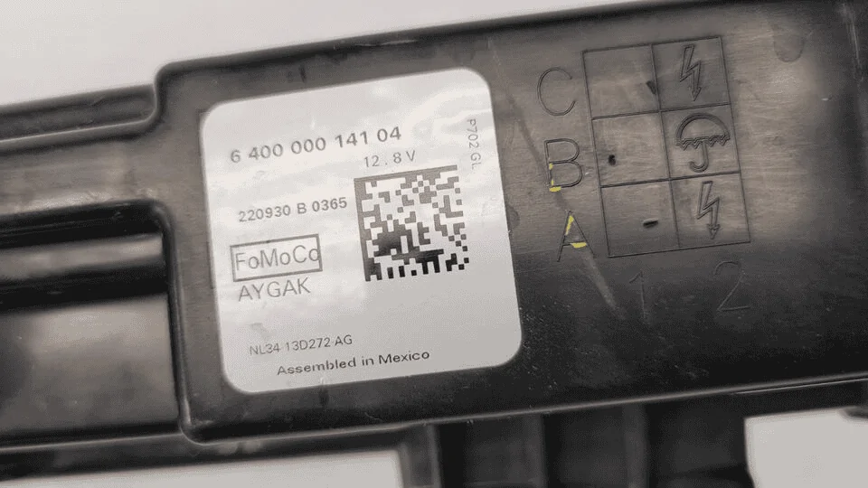

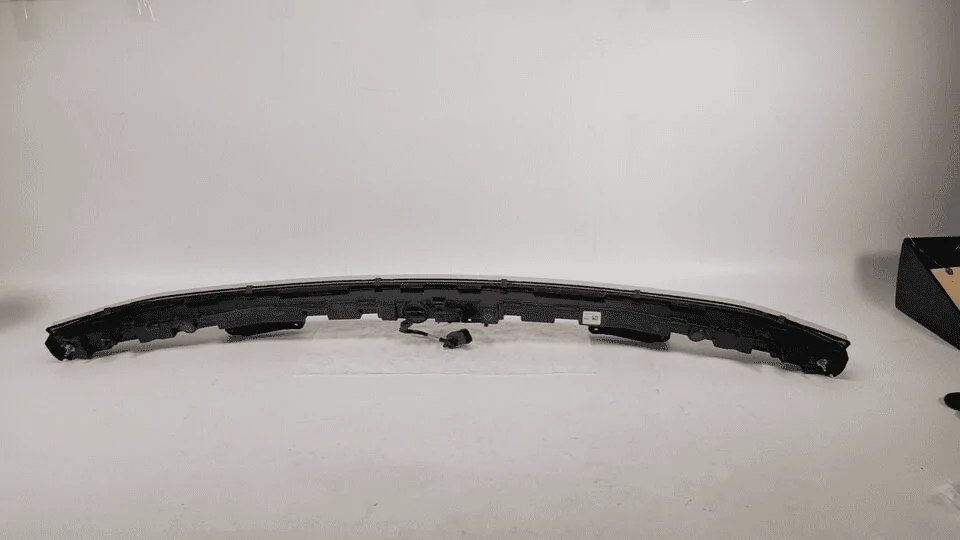

If the idea is to run colored LED strip inside with a deperate controller, separating the white plastic from the backing looks to be tricky without breaking it.
Also, I wonder why so many connections for a simple white lite.

I have the basic knowledge and HW to do what I would need to do for at least a basic startup sequence... what I don't know is how to get into the lights to do the MOD. The middle bar could be purchased from eBay for under $400, retrofit it and then sell old light bar... BUT if I can't get it to work it would be wasted $$.
The example lights here with controller is about $20 in HW so it would be a cheap mod (ESP8266 with logic level shifter and 60 addressable LED's controlled by WLED with a pre-defined start-up sequence).
