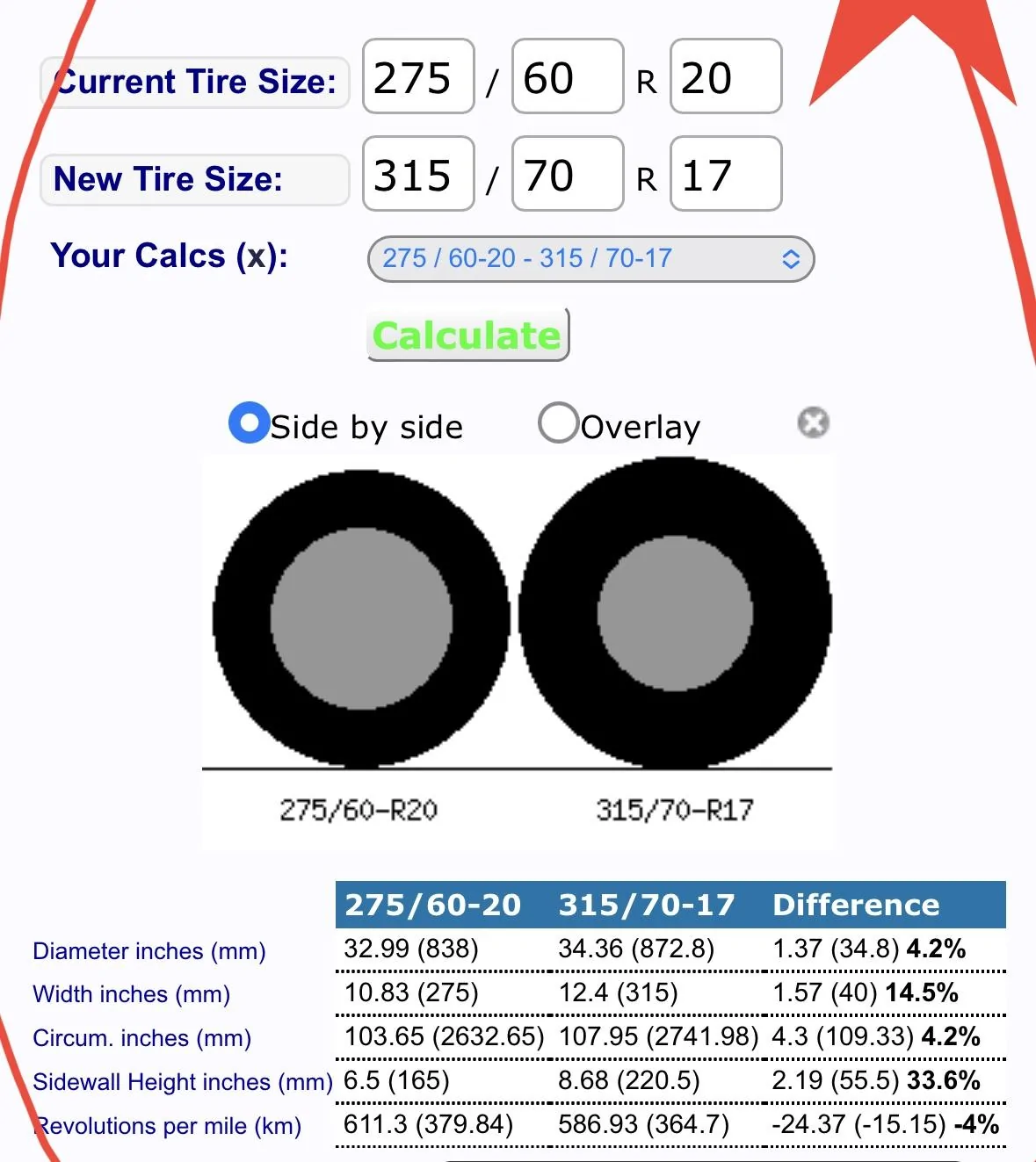

Hi there! Long time listener, first time caller…
I’ve got a 2022 Lightning Lariat, with power running boards.
I‘d like to upgrade my stock tires to some tougher 315/70/17 tires (stock: 275/60/20).
Do you think these will interfere with my power running boards?…
(and if so, any thoughts on workarounds?)
FYI - I’m not planning on raising/leveling the truck (unless needed).
Appreciate all you!

Not sure about the running boards, but I don't think you can fit 17's over the brakes. 18" is the smallest I have seen fitting.

Roger that. Perhaps 295/70/18 is safer?…
(i love those 17”s though ?)
