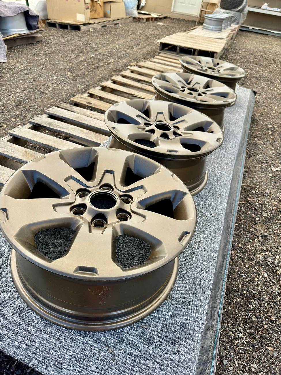

I went with a used OEM 18" ford wheel off a FX4 Lariat, 18x7.5, 44 offset, load limit of 2025# per wheel (8100# total) - Paid $459 shipped off of eBay + $560 for powder coating locally. I'm not worried about the lower load limit since I don't haul anything.
