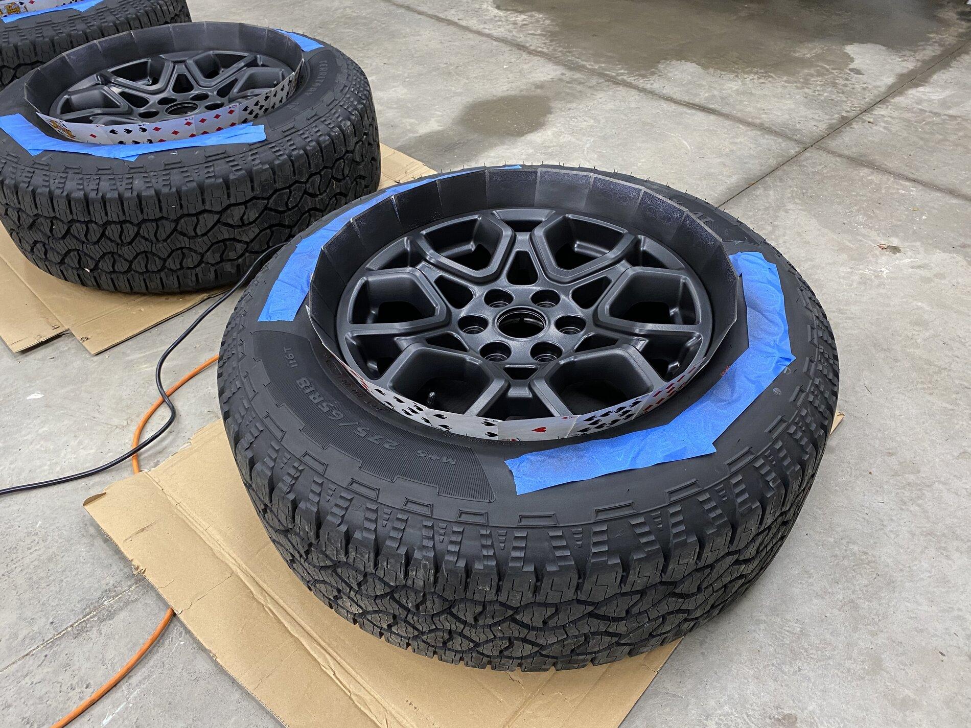

Plastidip fellas. Did it myself. You can get it at Menards.
I like the option to peel it off to put the wheels back to stock if I decide to sell. Wheels and tools are the the only things I’ll use the stuff for, but it looks good and holds up great with good prep work.
Just make sure you pull the wheels and hand wash them, mask properly, and the lay on a lot of thin layers with minimum 30 minutes between coats and I think you’ll be impressed with the results.
Worst case scenario you don’t like it... Just peel it off!
