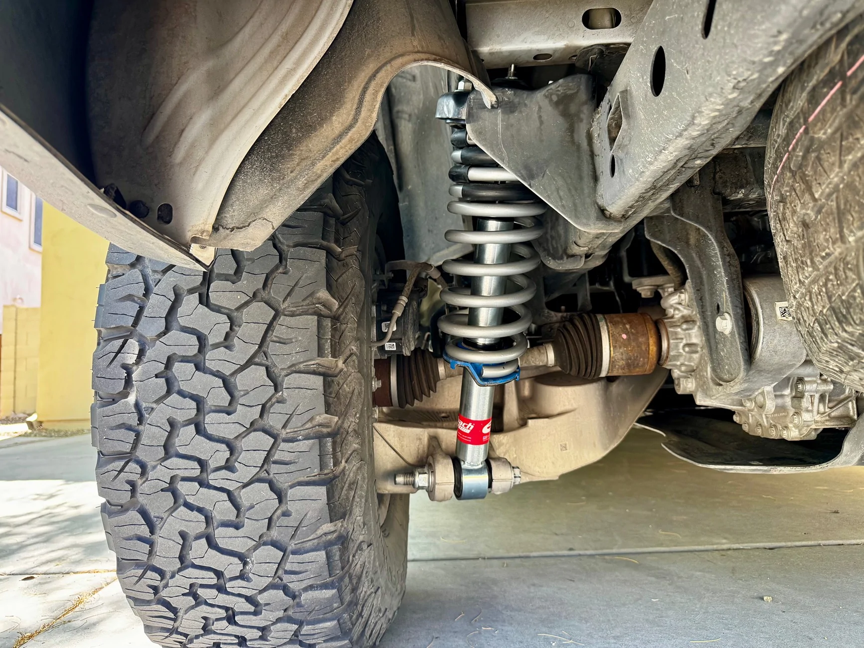

Another question. On their website the picture of the shocks don’t show a dust cover at all. Do they come with one?
We reused the OEM rubber pleated covers. Ditto for the OEM springs and spring tophats.
Note: whether You choose to do this Yourself (not that hard actually) or have a shop do it, Ford instructions indicate the OEM bolts for the bottom of the front and the rear shock need to be thrown away and new ones need to be used.
The rear shock bolt and nut, which are huge, need to be torqued to 380 foot-pounds. It takes a very large torque wrench to do this. I don't recommend the airgun ugga-dugga method here.
For both these reasons I'd recommend a DIY job, or careful selection of a reliable shop that actually follows specs.
I was quoted about $2,400 USD for this job by a pretty reliable Ford dealership here, and separately about $1,700 USD by the local Trick Truck aftermarket truck shop. That is separate from the needed 4-corner alignment afterwards which runs about $300 USD. I ended up doing it DIY in a US Army auto craft shop which had the lifts and the appropriate tools, me being retired Army and all that, which ran me about $216 USD for two eight-hour days of self work and including $25 per shock for the shop mechanic to change out each shock inside the OEM spring & tophat on a wall-mounted spring compressor.
