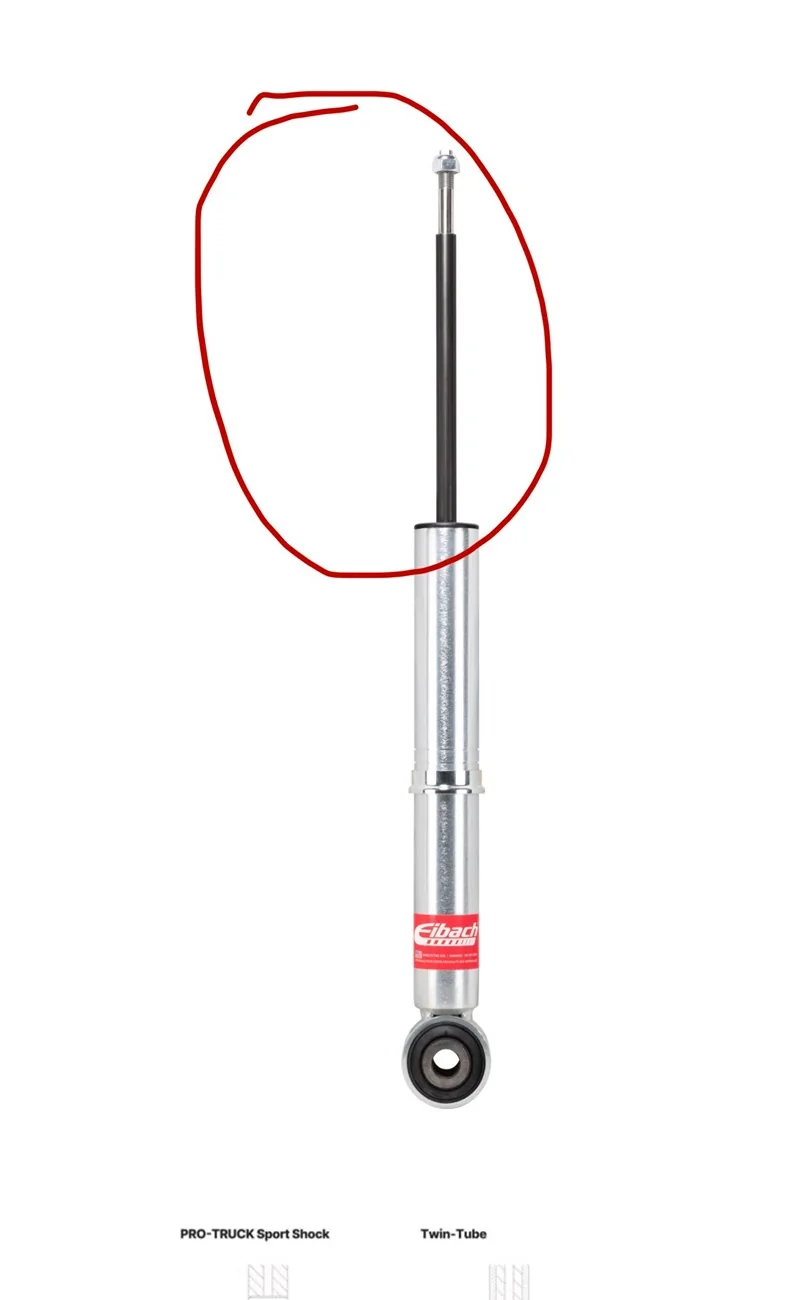

Another question. On their website the picture of the shocks don’t show a dust cover at all. Do they come with one?
We reused the OEM rubber pleated covers. Ditto for the OEM springs and spring tophats.
