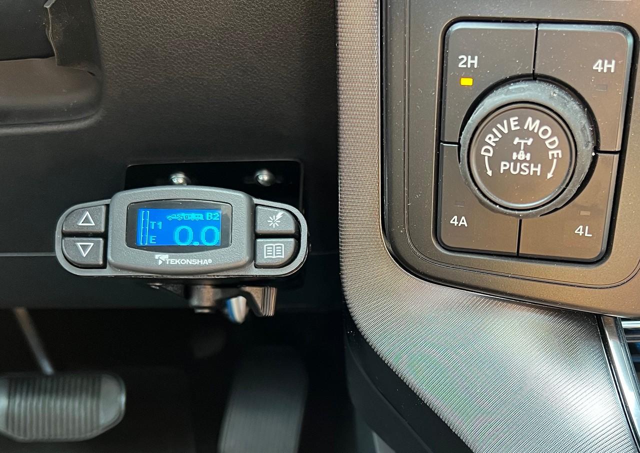

I have given up on Ford. It seems they have a hardware problem but are probably holding back on replacing all the brake controllers because of the chip shortage.
I installed the Tekonsha 90195 P3 Electronic Brake Control in my PowerBoost. This is an excellent controller with many more features than the Ford brake controller, but more importantly it works.
I took the advice of another poster and installed this controller independent of Ford systems. The controller is powered by the Airstream trailer I am towing. Only link to the F-150 is the brake light sense lead. I installed a new, watertight umbilical plug and cord between the trailer and the truck. Nothing going through the 7 pin plug.
For an $80,000 truck it is worth it to eat $139 to have a better, more reliable trailer brake controller.
