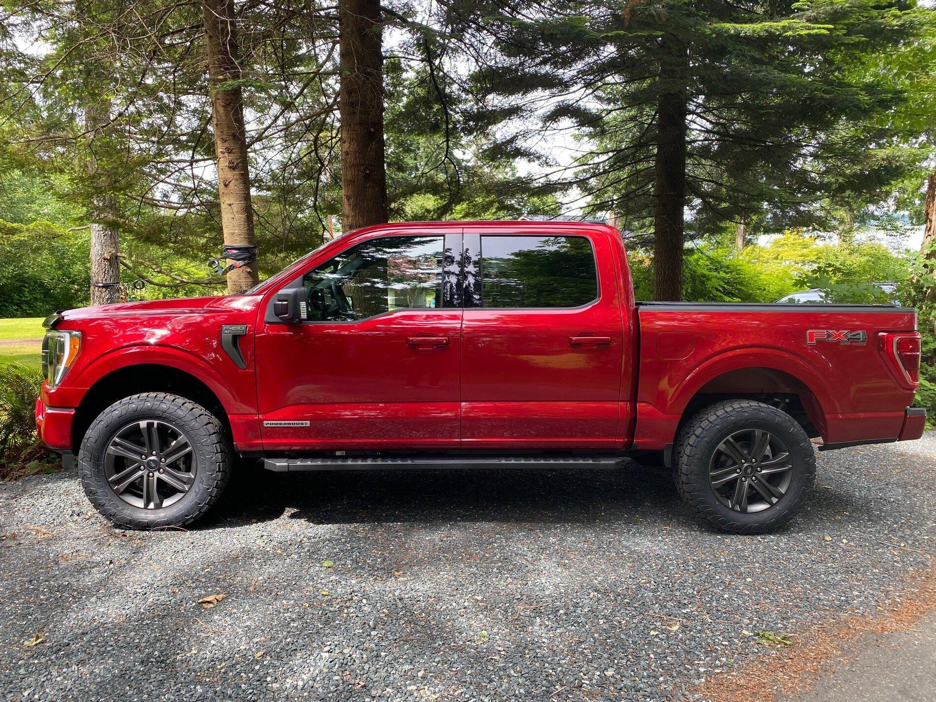

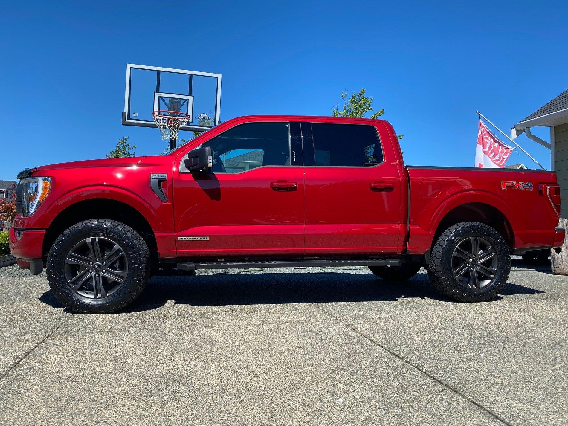

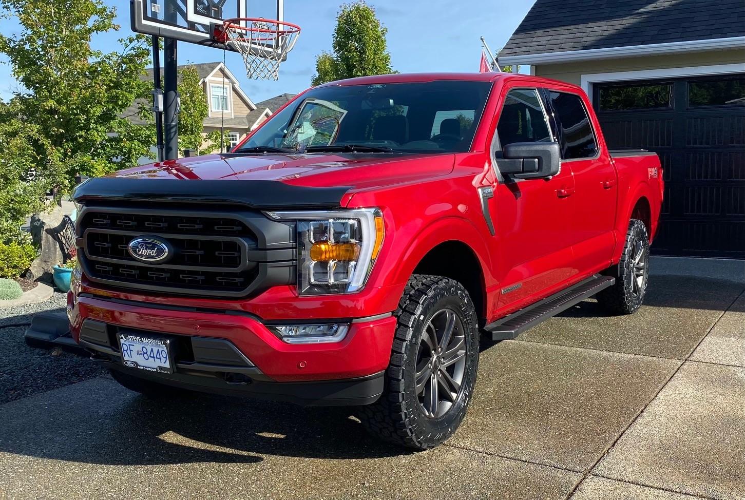

Definitely pushing the tire width limits with a 305/55 on the stock 20x9" +44 offset rim to avoid any trimming/cutting and rubbing. I went with the 295/60R20 (11.8" wide) on my stock 20's and there is not much clearance left near the control arms to add tire chains if required. The 34" tall tire squeezes in the wheel well without trimming.

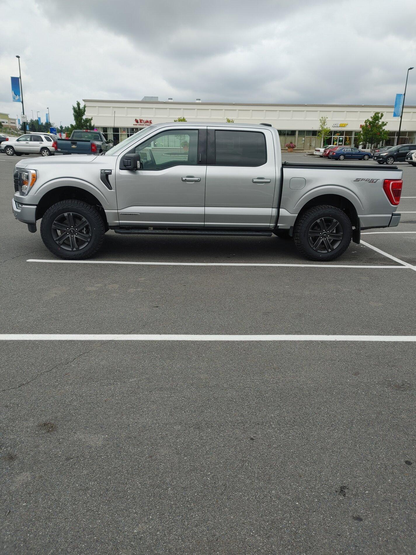

What size tires can I run with the 2" leveling kit on my f150 Powerboost xlt with the stock 20s? My buddy is running 305/55/20s terra grapplers on his 19 platinum, would those fit?
I am running the 275/65r20 Terra Grppler G2's on stock wheels with no lift/level - no rub and no trim required

ok cool thanks! is that with the 2in leveling kit in the front? and can you take a side picture so i can see the stance
Installed is a Pacbrake Pro 2" level kit

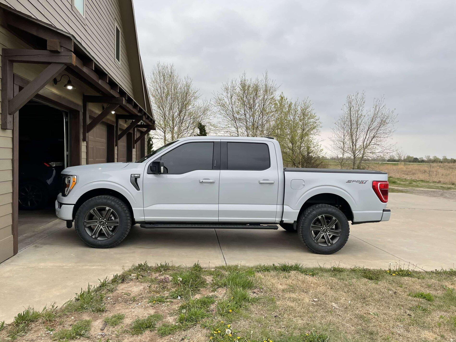

Hey guys thanks for the help! So what I got done was a rough country 2in leveling kit, and want with Falkin Wild peak at3 275/65/R20. I wanted to go wider but I deal with Maine winters so skinnier would be easier.

maybe my 47 year old eyes are deceiving me, but why do those 2" leveling kits thats suppose to make it all even, seems like more of a 3" lift, and front is slightly higher than the back.
