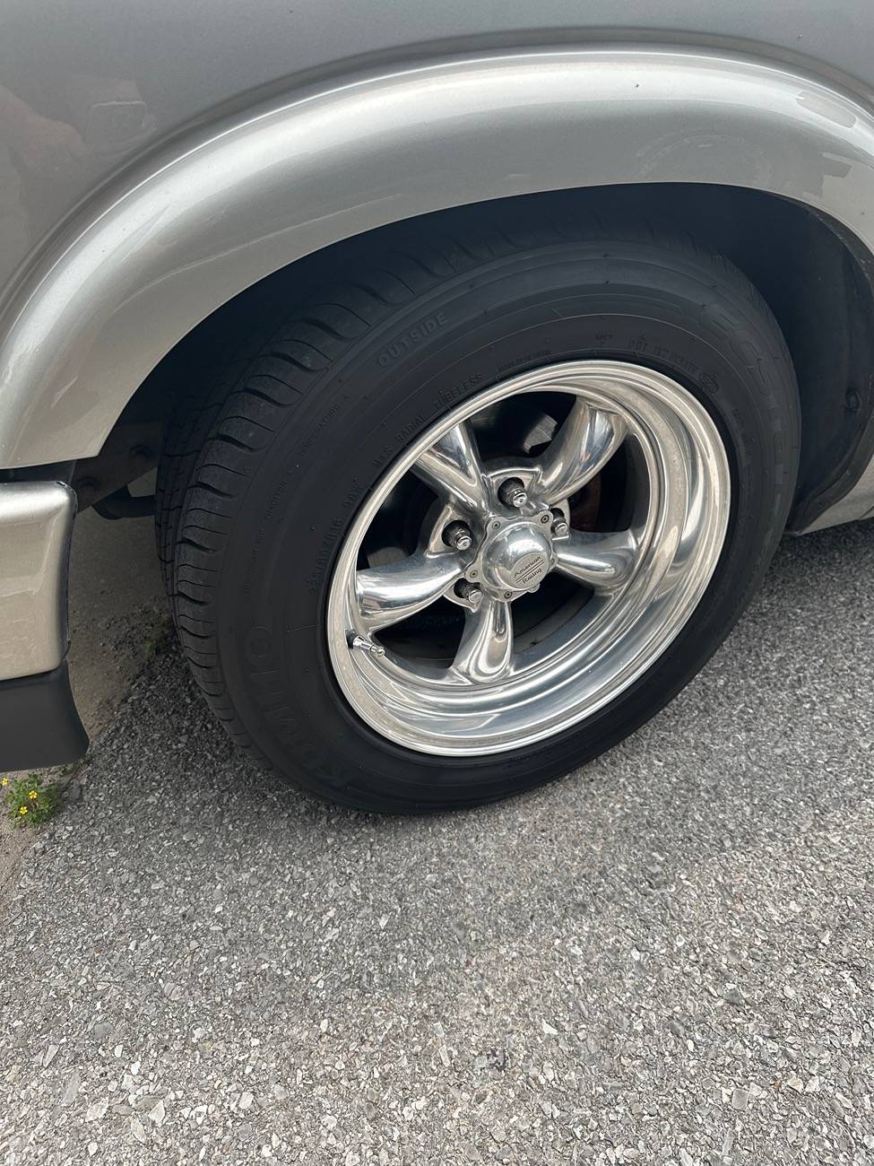

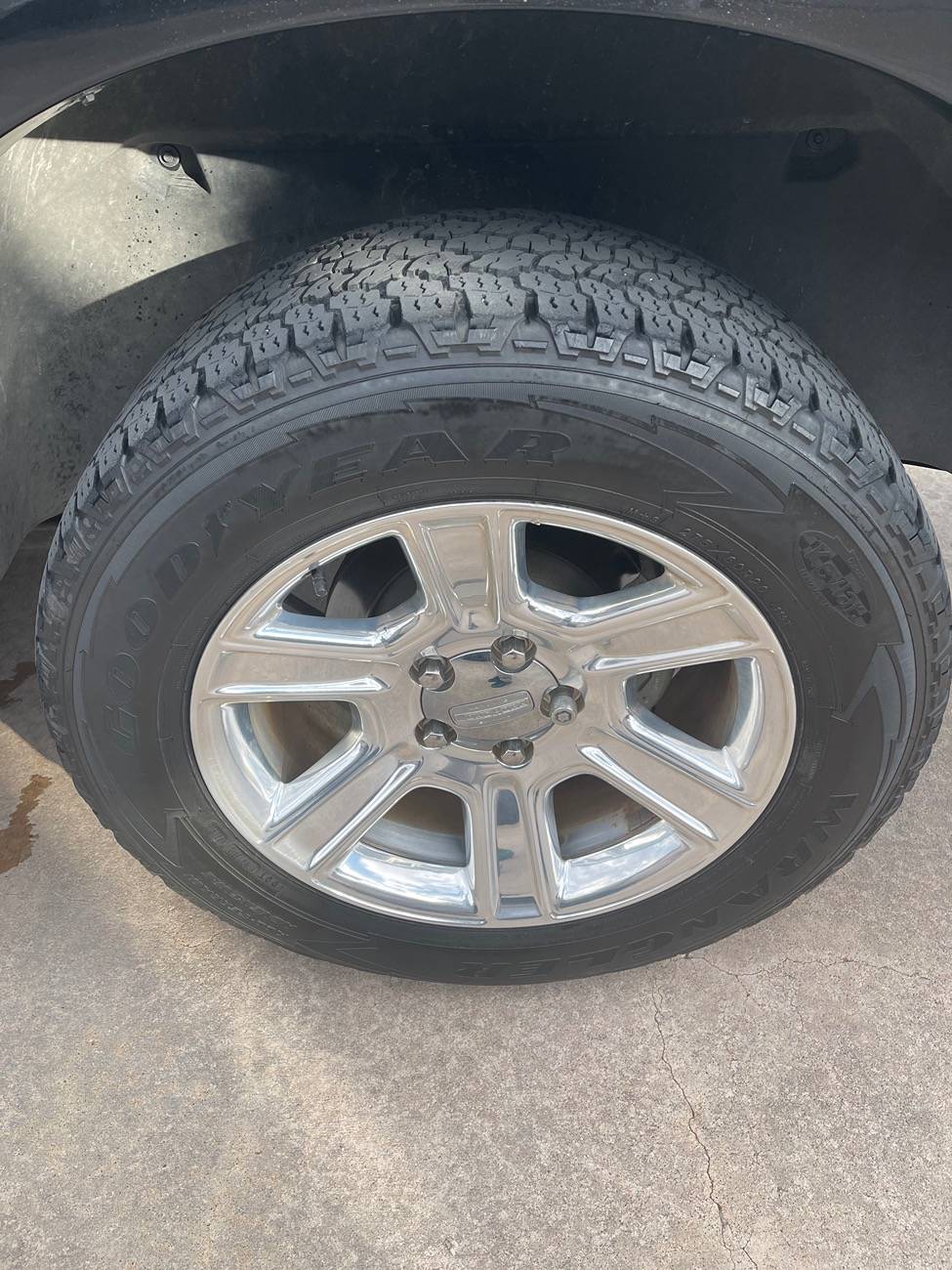

Yes let me know what you find out, I also leveled with 2” kit.
Not to concerned with loss of miles, only drive total 10 miles a day.
But to want to maximize less tire wear and have good longevity.
Looking cool is also a truck must!!!
Ideas…?
