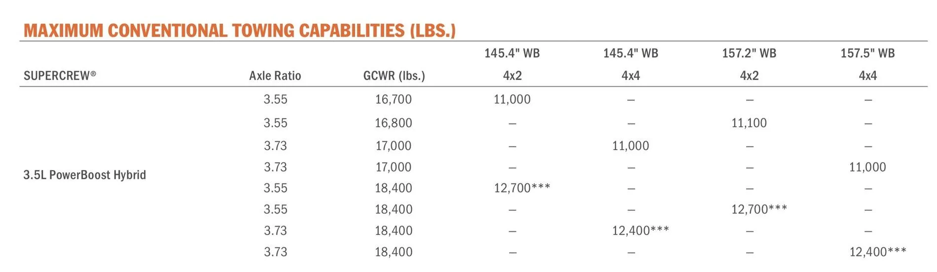

I’m thinking the GCWR is 18,400. If I am reading this chart right. I have max tow.

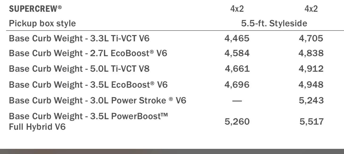

Looks like the curb weight is 5,517.
You're absolutely correct @hevnbnd, my mistake.
18400-5517-12100=783 left over i assume you have to deduct for what's on the truck?
I hope i got that math wrong again as it looks similarly challenging to 'legally' towing. I don't even see how Ford themselves could configure a PB per their guidelines to tow the max 12400.

Yeah I don't think Ford knows either. If you notice that chart of the GCWR it shows 4x2 on both columns even though I suspect since the 4x4 column weighs more it is meant to be 4x4...
If i am understanding correctly I would also need to subtract the weight of my trailer from the 18,400 GCWR. My trailer comes in around 4,500 pounds. If that is correct then I would be looking at
18,400 (GCWR) - 5,517 (Curb) - 4,500 (Trailer) = 8,383 left for the load on my trailer...
