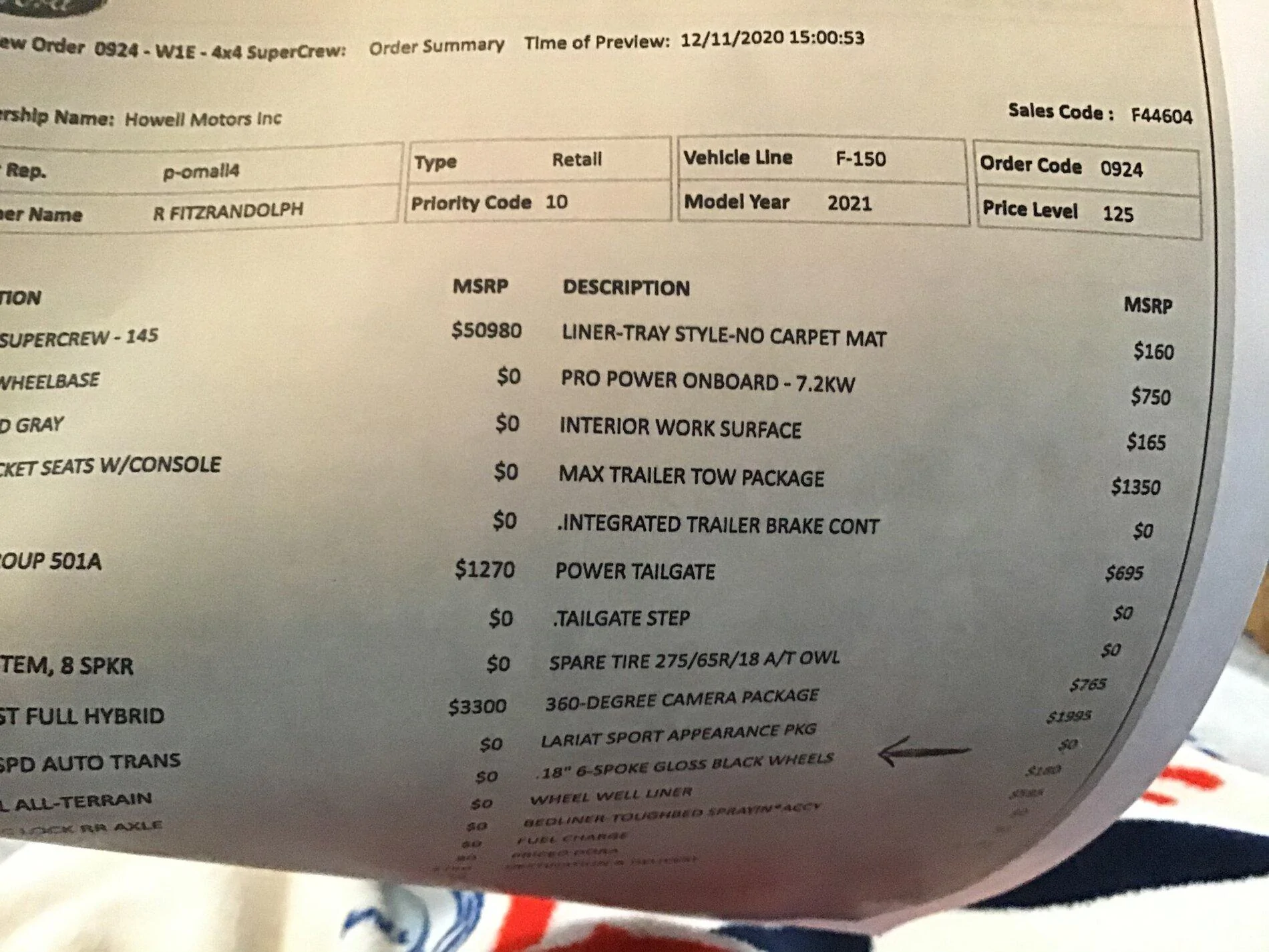

I ordered a Lariat Powerboost back in November when the max tow was 1350. I think it has bigger brakes and a slightly upgraded rear bumper. The price increase is ridiculous.

That would be my guess. I compared stickers on the rear axle GAWR for a Max tow vs Tow tech and they were both 4150 lbs. The tow guide shows a better tow weight capacity to I am thinking it must the the HD9.75 axle with the bigger brakes, but that is way too much money for a bit of a plus on the max two it doesn't include the 360 cameras, like tech tow does, thanks for the input.

Just a heads up, you are subject to the price increase. I ordered in September and my price went up.
Well that blows. I know I couldn't do that with my customers and keep them as customers.
" You know that contracted price I gave you - just kidding!"
Guess I'll have to see how my dealer handles it, to determine how I'll handle it.
This truck is a want, not a need. My 2015 XLT only has 29000 on it.
