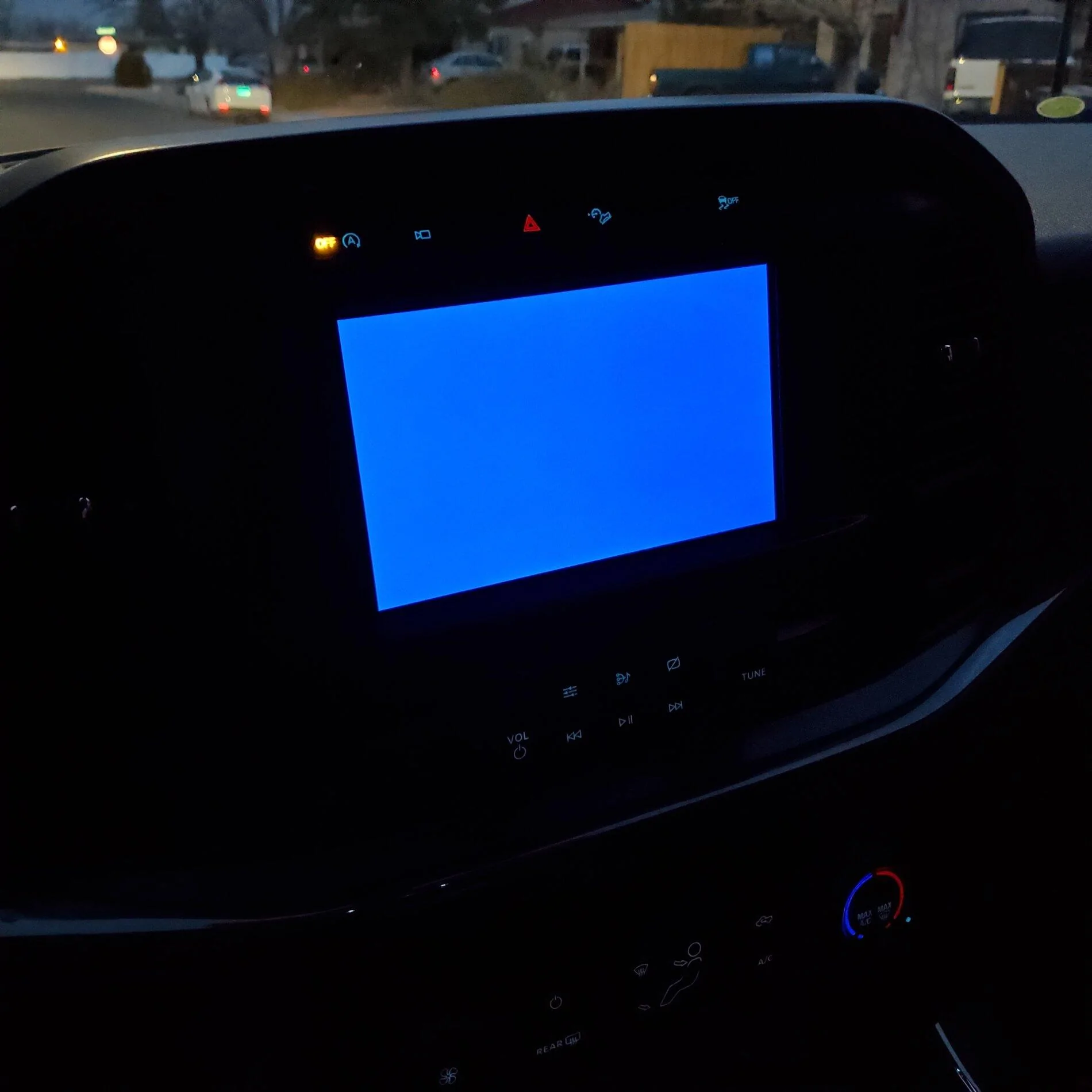

New problem.... When I connect AA, i now get an all blue screen. Goes back to normal when I disconnect AA

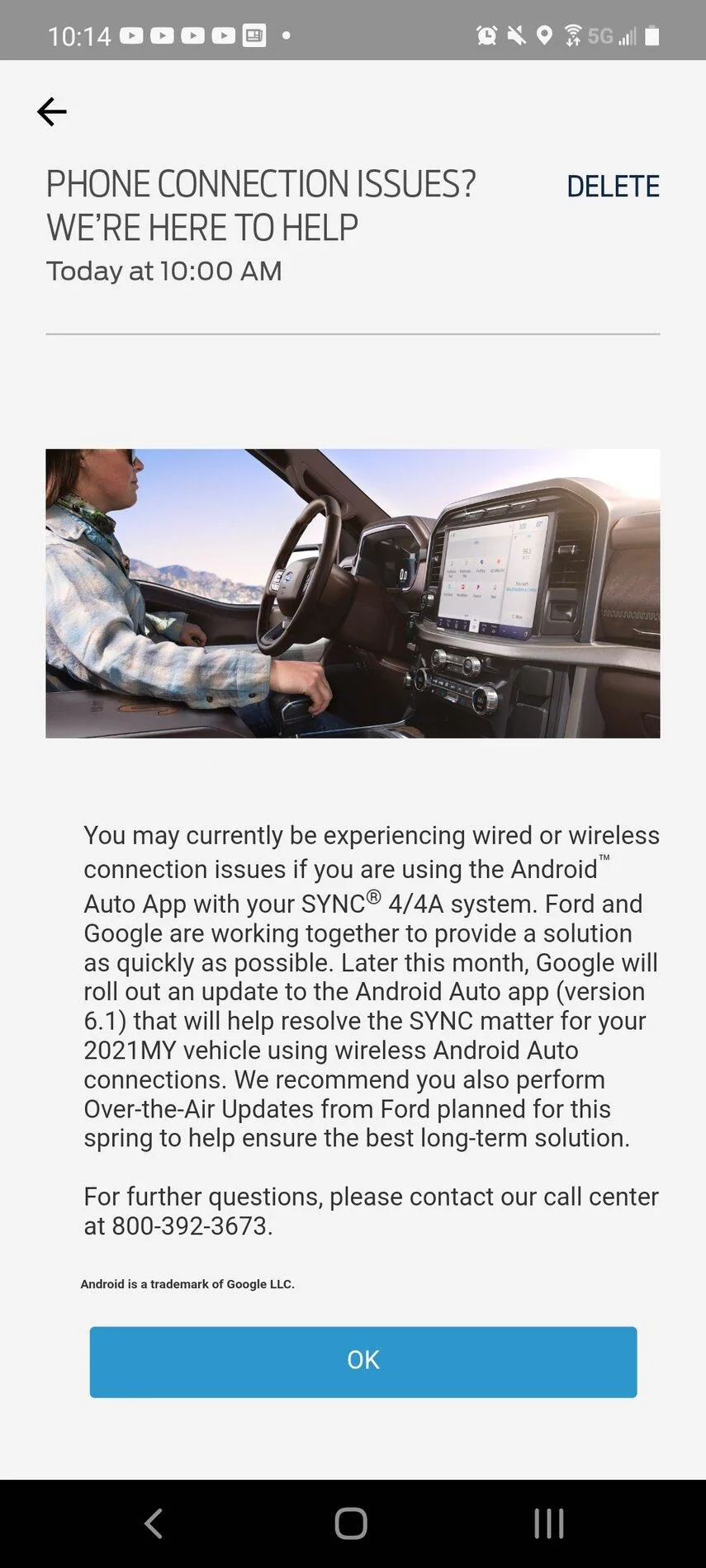

Got that same message from Ford this morning.
However with the android auto 6.1 and chrome update my system has been working just fine for about a week or so. AA connects wireless whenever I enter the truck. Boot loop when plugged in is now gone too.
Note 10+ with One UI 3.0 Android 11
Did you side loaded the update? I am checking the Play store everyday from my Note 20 and haven't seen the update yet.
