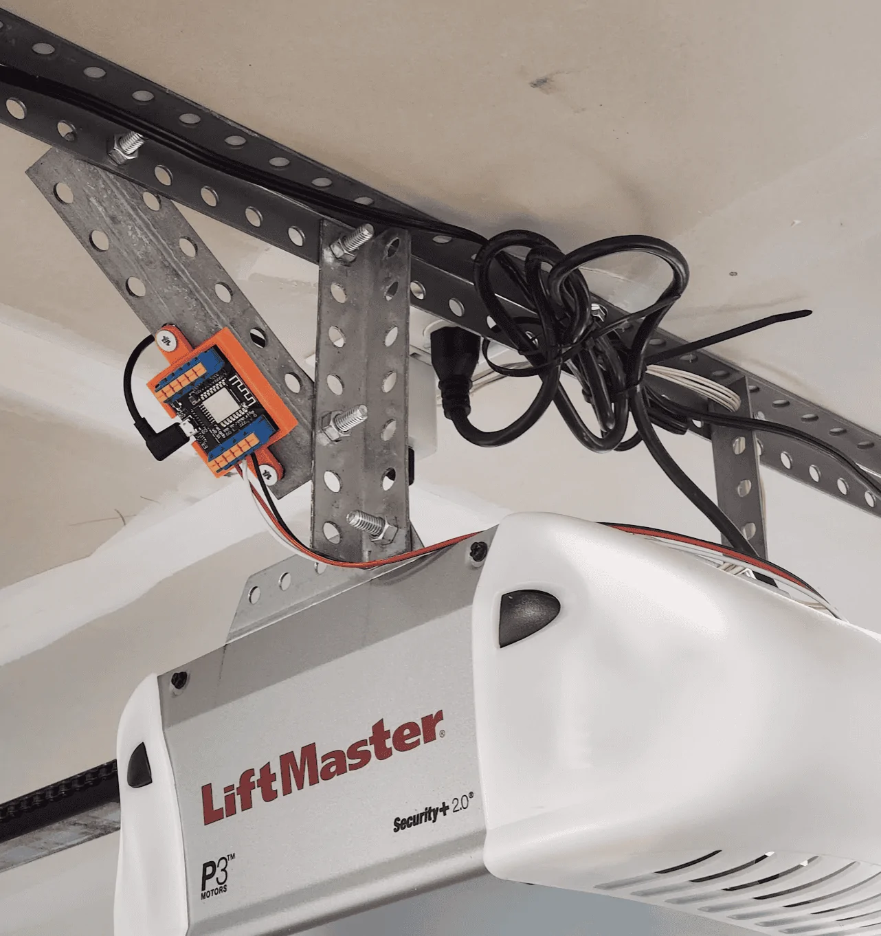

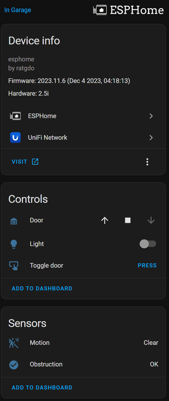

It's pretty awesome so far.
Ford F-150 Lightning MyQ Panel on Carplay 1703098218569
Ford F-150 Lightning MyQ Panel on Carplay 1703098299652
Not sure what the motion sensor is, might just be something some doors have, mine seems to not.
I have a chamberlain opener, it has a motion sensor just to turn the light on when I walk into the garage.

Re: walking in... that's the obstruction sensor being tripped, or at least in my case that's what mine does.
