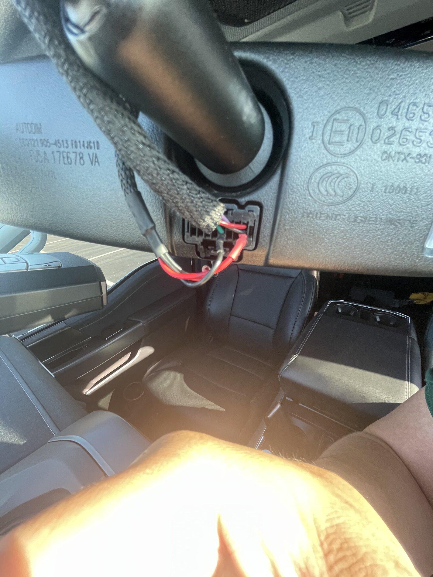

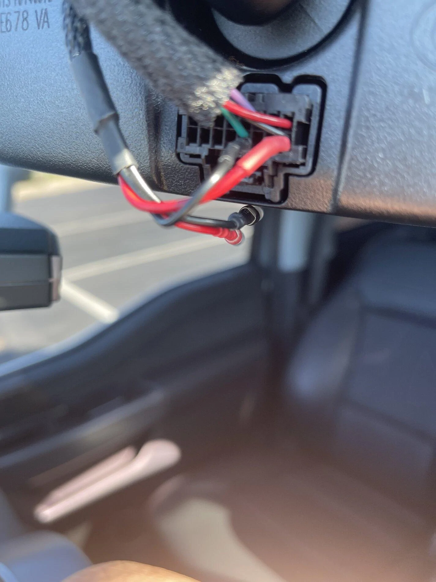

I used my mirror taps with no issue. Removed from my 2018 F150 and dropped right into the 2021 F150. Was the same wire locations on the mirror. Bottom Left (driver side), +12, and I believe pin 4 is ground on the bottom row. On my connector, there are only two wires on the bottom of the connector and those are +12/GND.

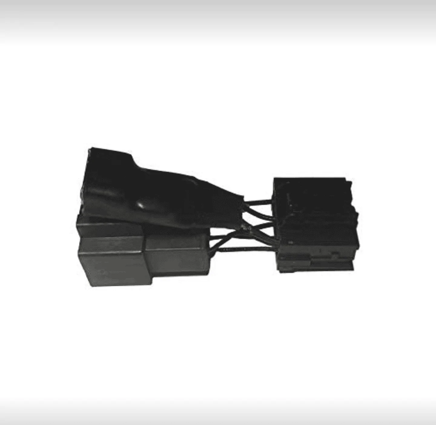

Can you still use the mirror tap for a radar detector too??
If you're asking if you could use this for both at the same time, I doubt it.
It's only recommended for devices requiring less than 2A, which I think you might exceed using a dash cam and a radar detector at the same time.

I want to splice power from rear view mirror on my 2021 for radar detector. Anyone done that yet?
YES ITS VERY EASY SAME AS THE PREVIOUS GEN

easy to do. ordered off amazon

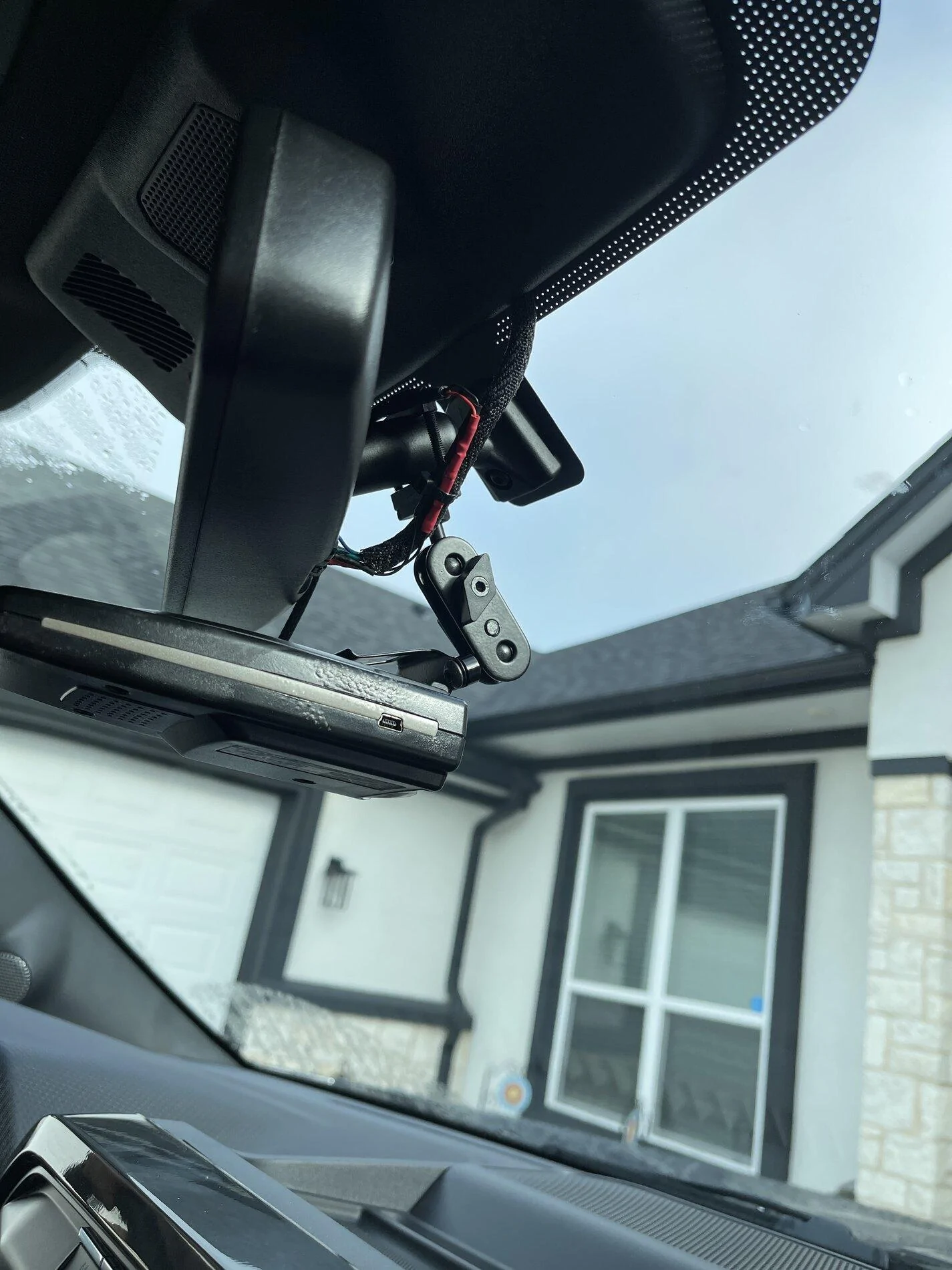

I did this as well, made a video on it if anyone is interested. Love the clean look of it.
