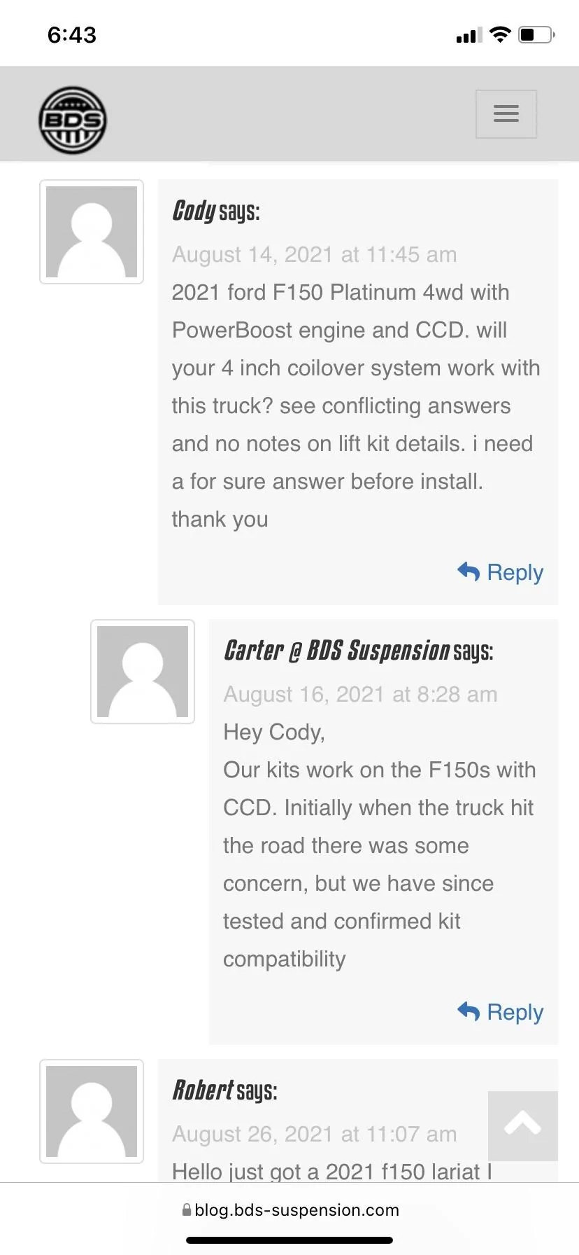

CapIrish, I’ve got the same truck and similar issue. I had a 2” level installed… I’ve got fuel sledge 22x10 +10 offset wheels and Toyo AT3 285/55/22 tires. When I get the truck around 50mph and higher the whole truck shakes. The installer has no idea on what the issue is. The only thing they haven’t tried is road force balancing. I did find this info on BDS site saying their kits would work on CCD equipped trucks but have not dug any further yet. I also seem to have a slight buzz or hum I can feel in the gas pedal and steering wheel at times. Just ready to get this figured out.

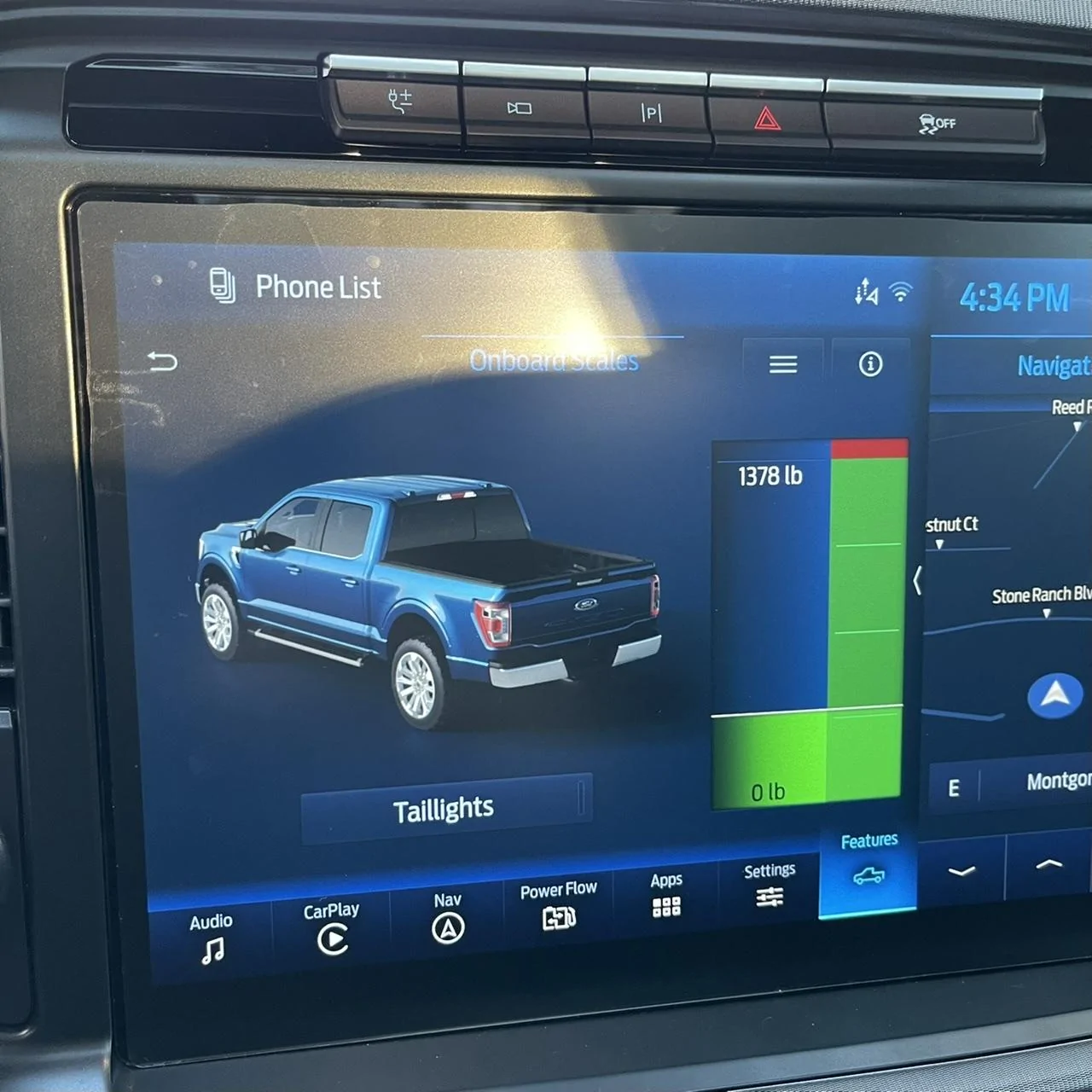

Shaking and vibrating is most likely your tires and not related to CCD or the level. Check your scales to see if the sensors need to be reset. Since I’ve done that, my truck rides almost as good as stock albeit with LT tires.

That's interesting. I just talked to BDS last week and they said they have nothing in the works yet for the ccd. They haven't even seen one in person yet so they have no starting point. It seems that none of the lift companies have a clue yet but hopefully they figure something out relatively soon.

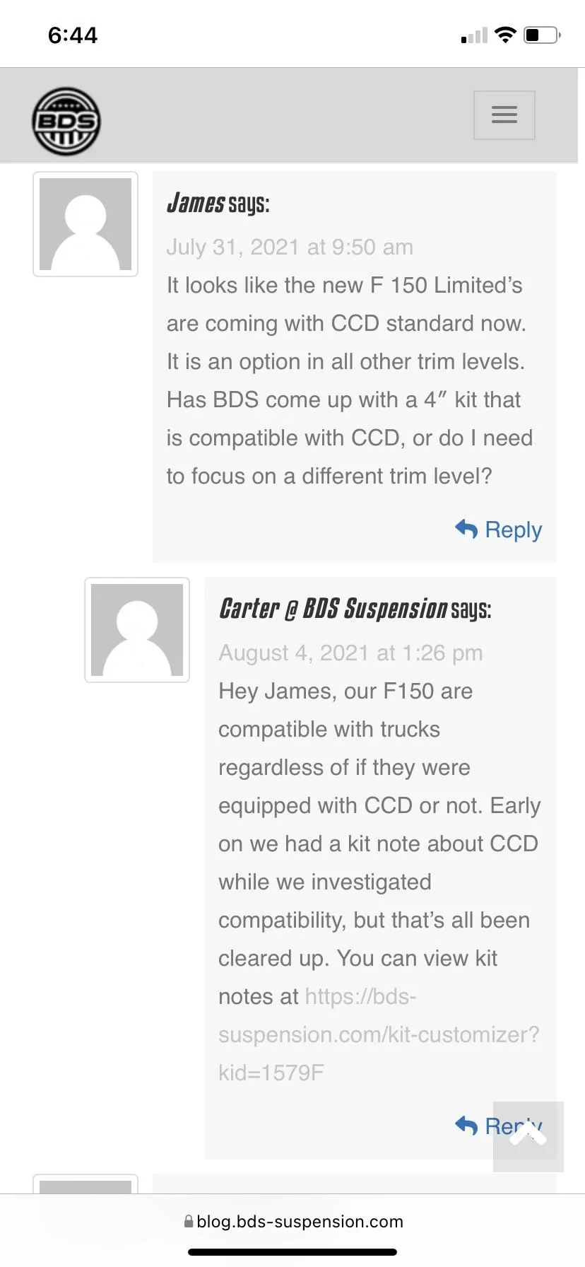

CCD should be fine, Smart Hitch is a different situation. I’ve emailed with all the manufacturers of helper spring setups and bump stop replacements, yet to get a good response on the Smart Hitch. My sense is they're not compatible unless there are recalibration with new deflection parameters for the system (and not sure if that’s even possible).

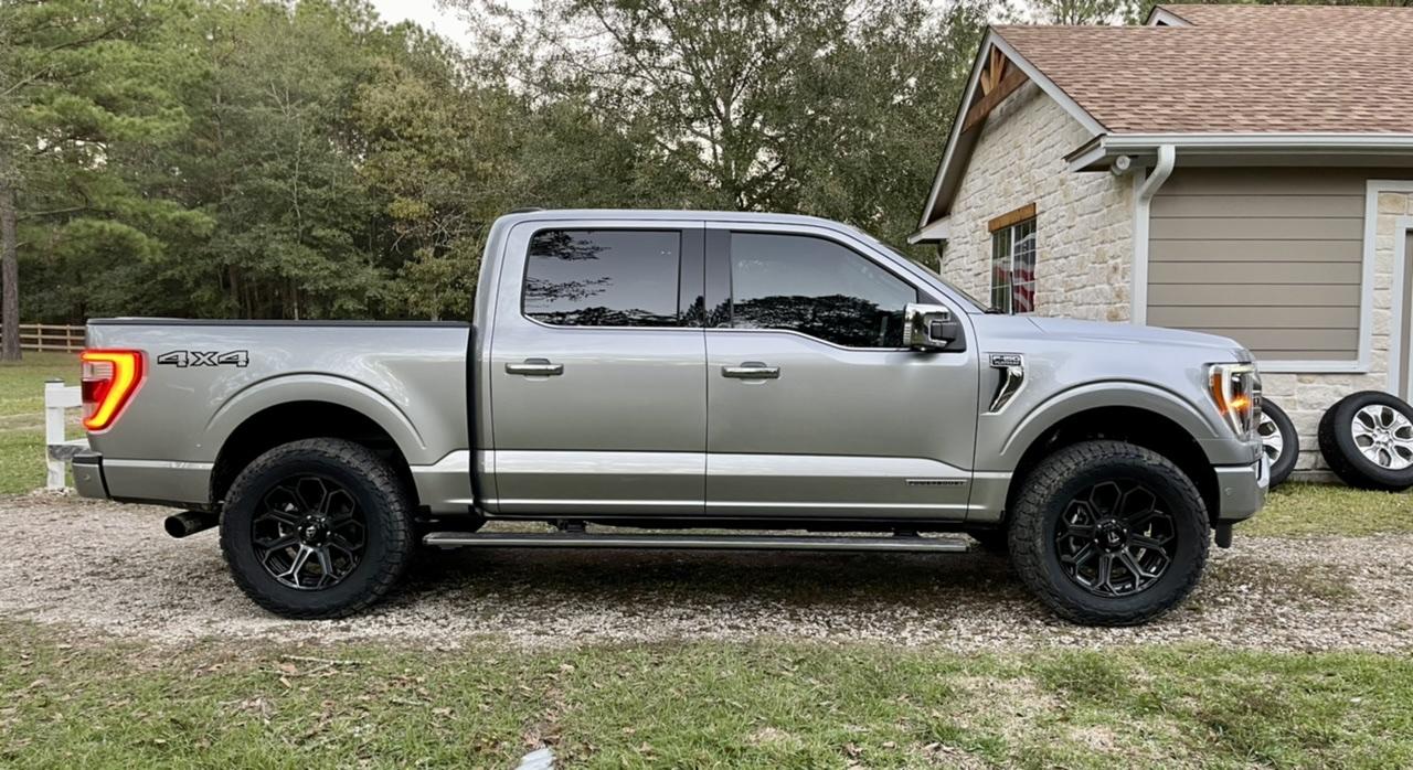

Haha thanks! The guys over at Allout Offroad know what they are doing. Keep us updated on yours!

Have you revisited this yet? I see Readylift says the 3.5 works with CCD and I’ve see Atkins Ford (Real Deal Neal) did a 6” BDS lift As well. No idea how they managed the CCD errors with new shocks.
My plan is to go with the 3.5 and some 295 65 r20 on VenomRex VR 601 mystic black. Once my 2022 Platinum shows up.
