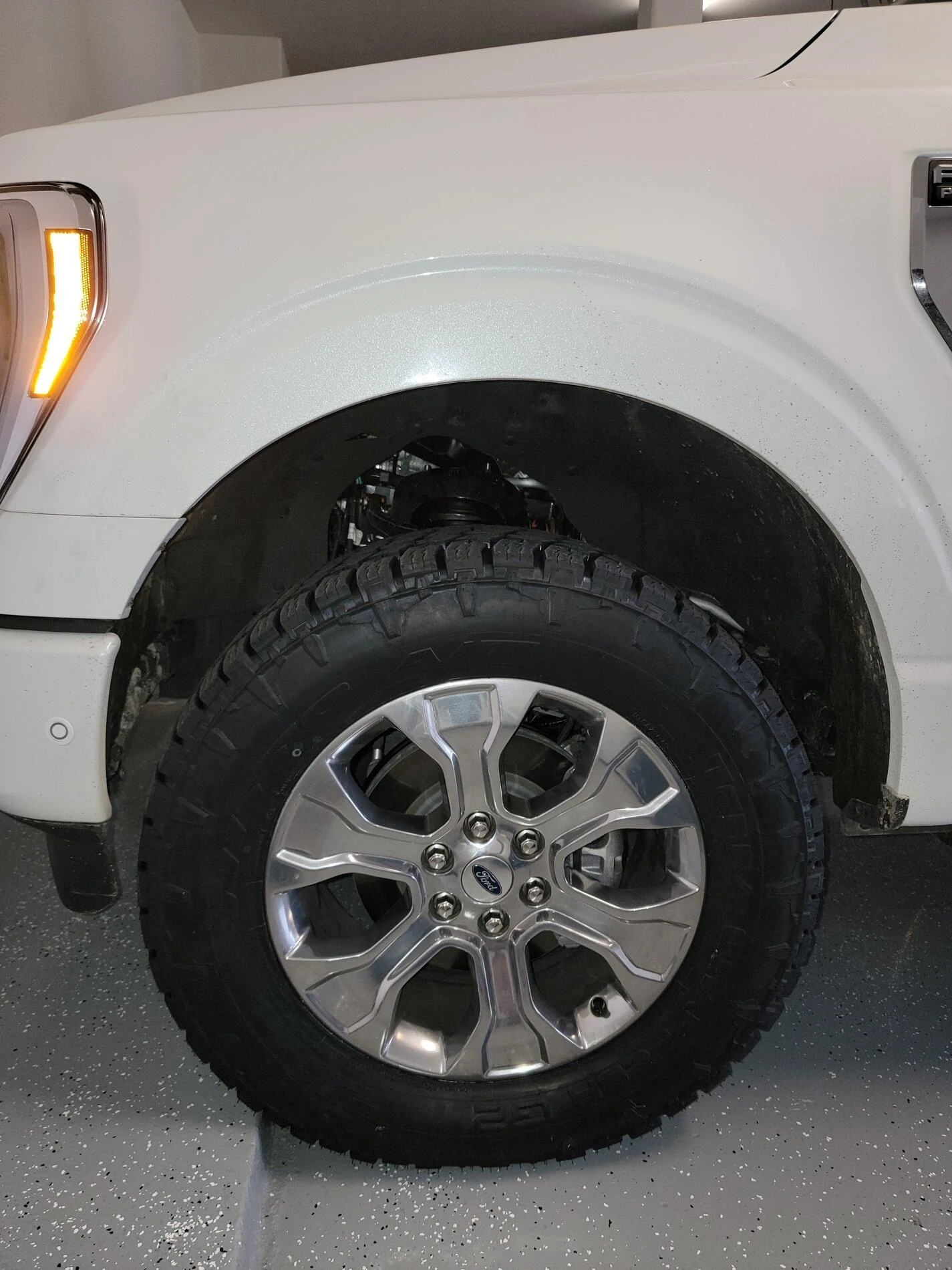

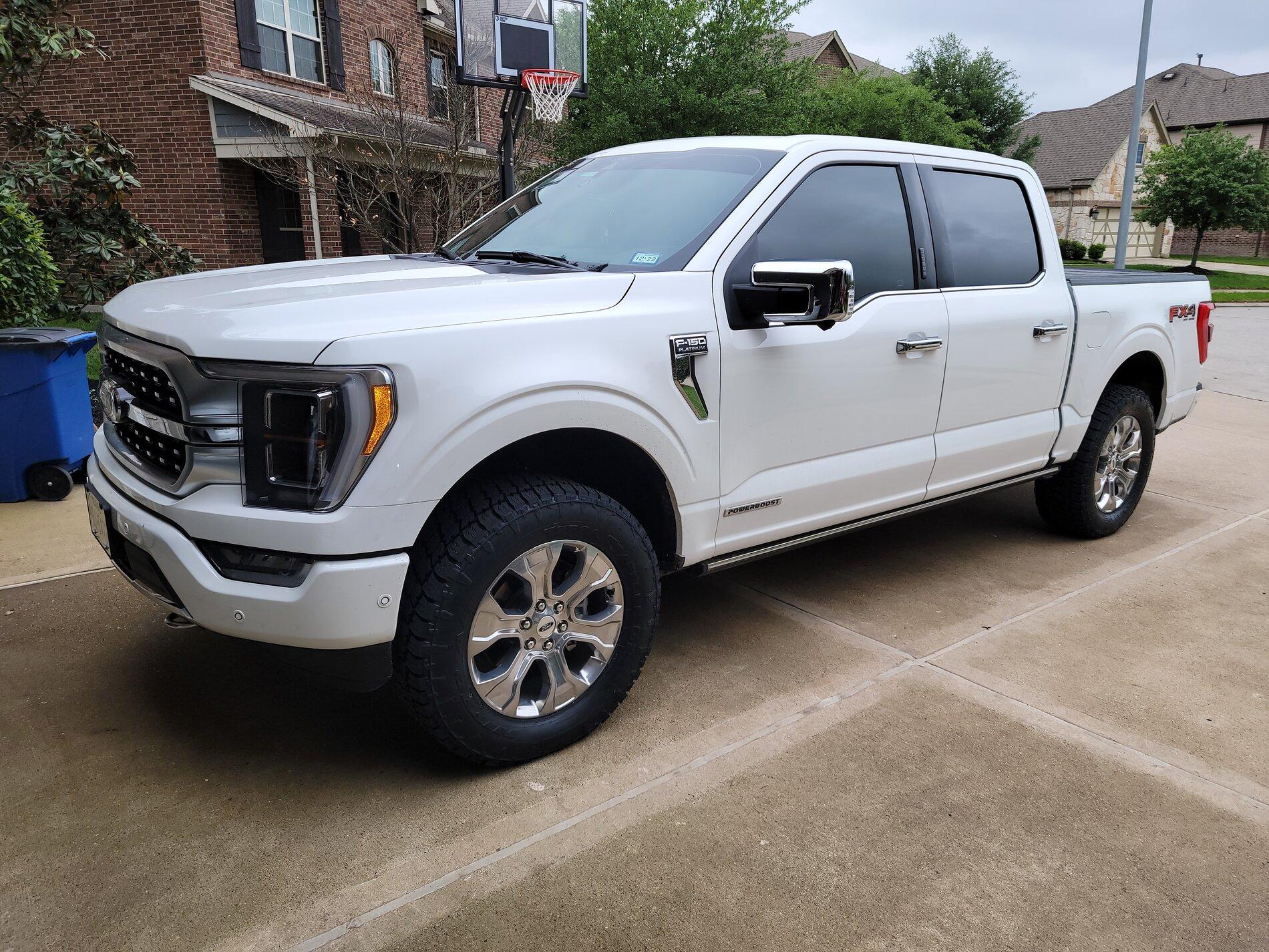

295 60 R20 Nitto Tera Grappler G2 tire.
On level kit.
Ford F-150 Lightning Factory Wheels with Aftermarket Tire Thread 20210414_170953
Ford F-150 Lightning Factory Wheels with Aftermarket Tire Thread 20210414_170235
