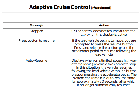

Less than 3 seconds the auto-resume works for up to 30 seconds. So after the 30 seconds you have to click the button or press the pedal. Image below taken from manual.
In my head I was trying to figure out why they would do this. My thinking is because it probably canā€™t detect your hands on the wheel in stop and go traffic.

The ā€œafter following a vehicle to a complete stopā€ is the part Iā€™m interested in I guess. That seems to be hit or miss, sometimes it works fine snd does auto-resume, other times it keeps doing the ā€œstoppedā€ thing which is very frustrating.
As earlier post said it should be based on your location - stop and go on city street vs freeway.
In my experience, if I am on a City street at say a stop light it is based on 3 seconds, and if itā€™s stop and go on a freeway itā€™s more like 30 seconds. My guess is the city is so that if you are say at a light and the person in front of you turns right on red you donā€™t just automatically drive straight through a red light (because there are no cars in front of you). On a freeway this time issue.
