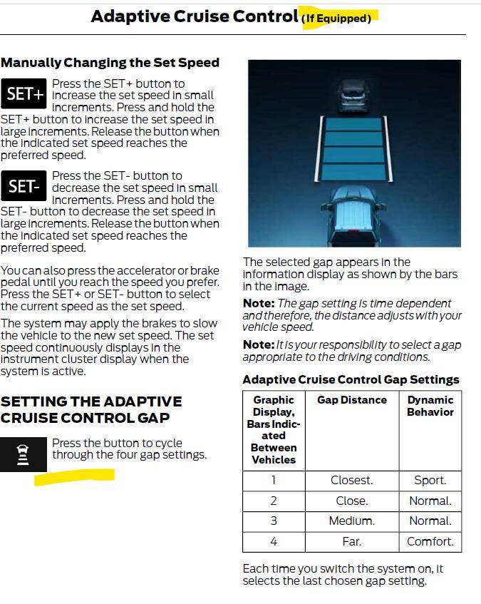

So is the 1 or more car distance a BC setting, or is that how you set the active cruise to use BC in heavy stop and go freeway traffic?
209
15,466
17,224
it's related to Adaptive cruise control,
left side if steering wheel,
button with the dashes

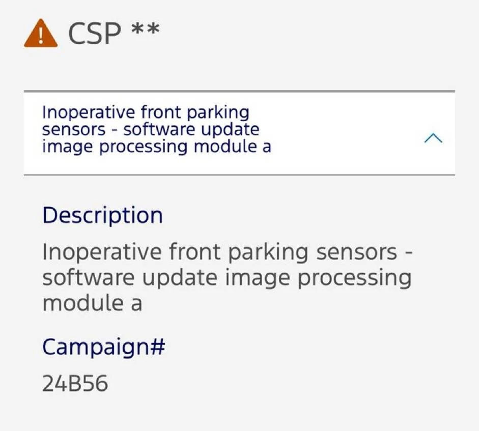

This update fixed my problem. Mobile service performed it two days ago and I just drove to Austin today with lots of stop and go traffic. It performed much much better than it did before and when traffic came to a stop and started again it started up and it didn’t leave multiple car spaces in front where many people could cut in front of me.
