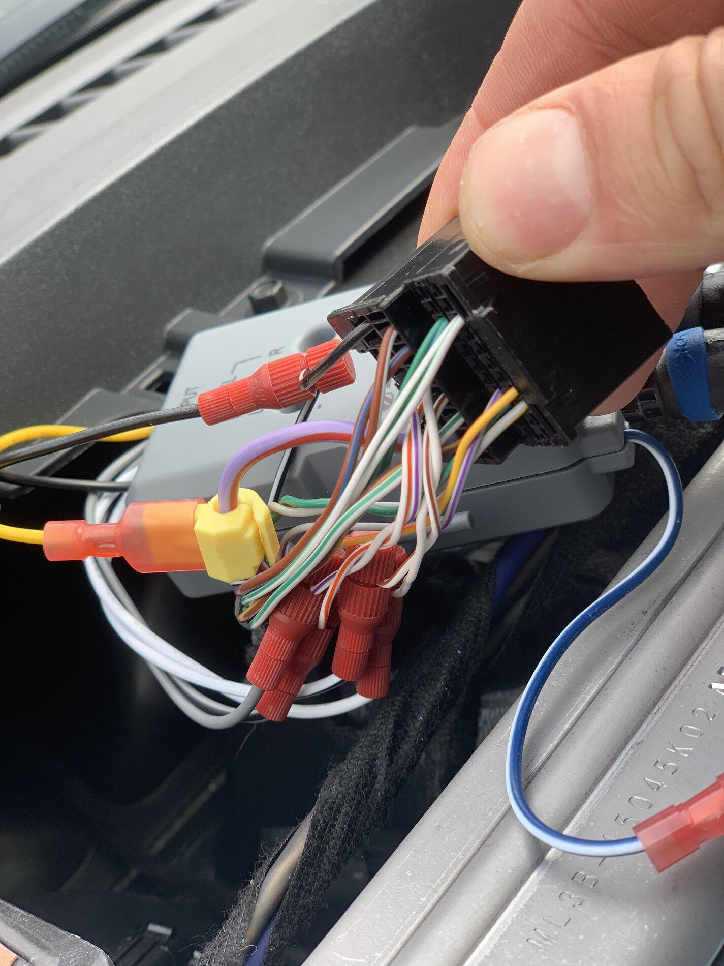

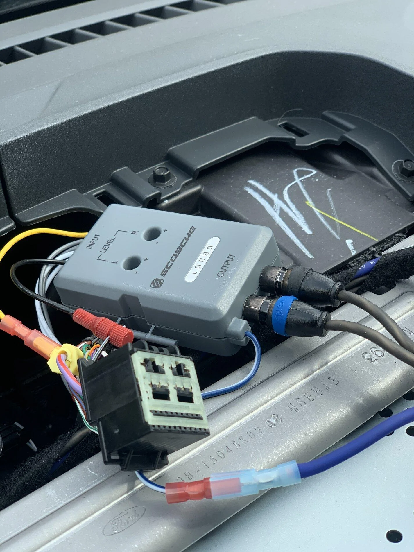

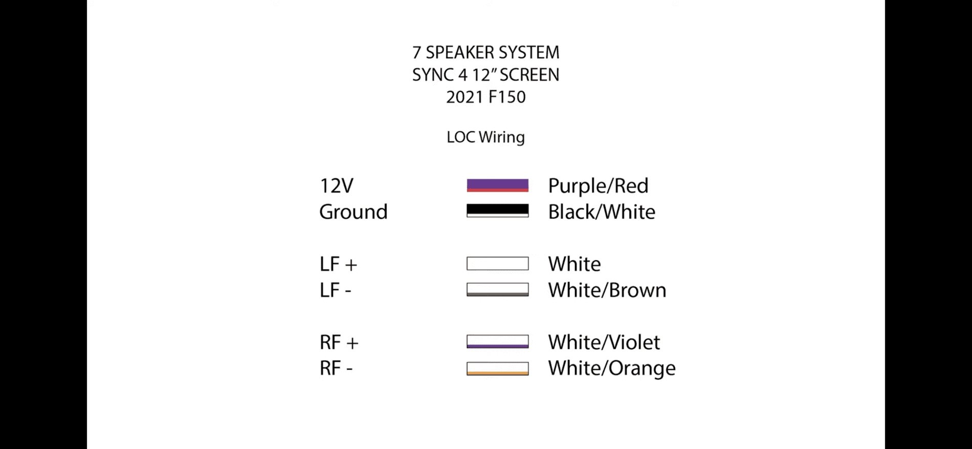

Just installed a Scosche 90LOC to my 6 speaker system and it works great. There is no need to spend the extra money on a fancier LOC since this has adjustable output and fits great behind the head unit.

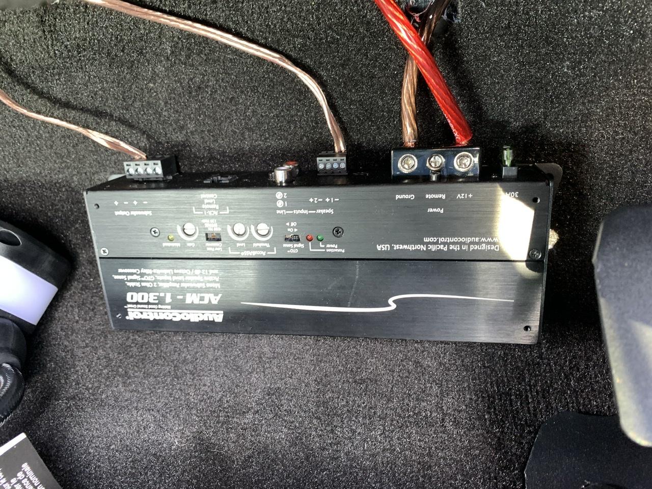

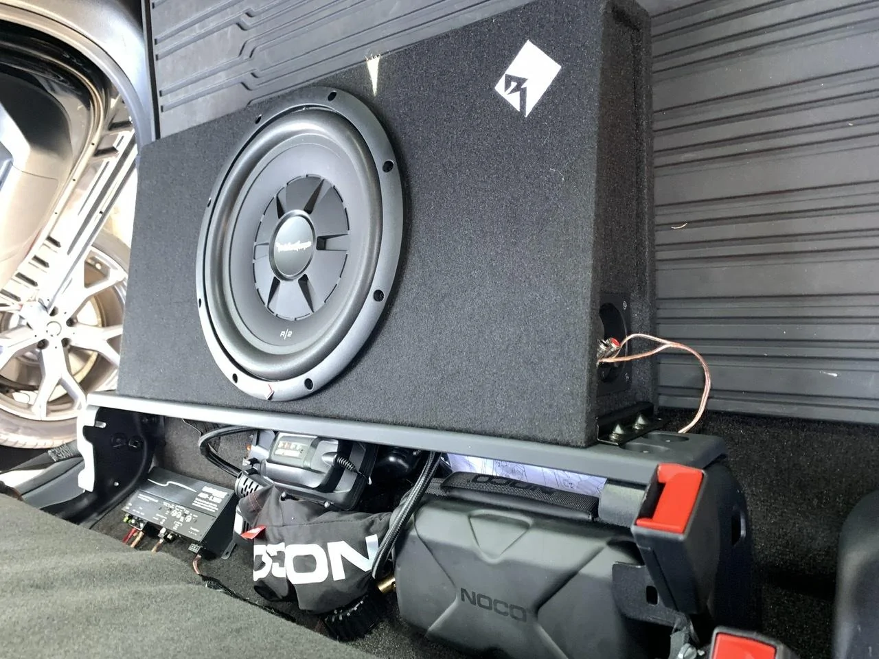

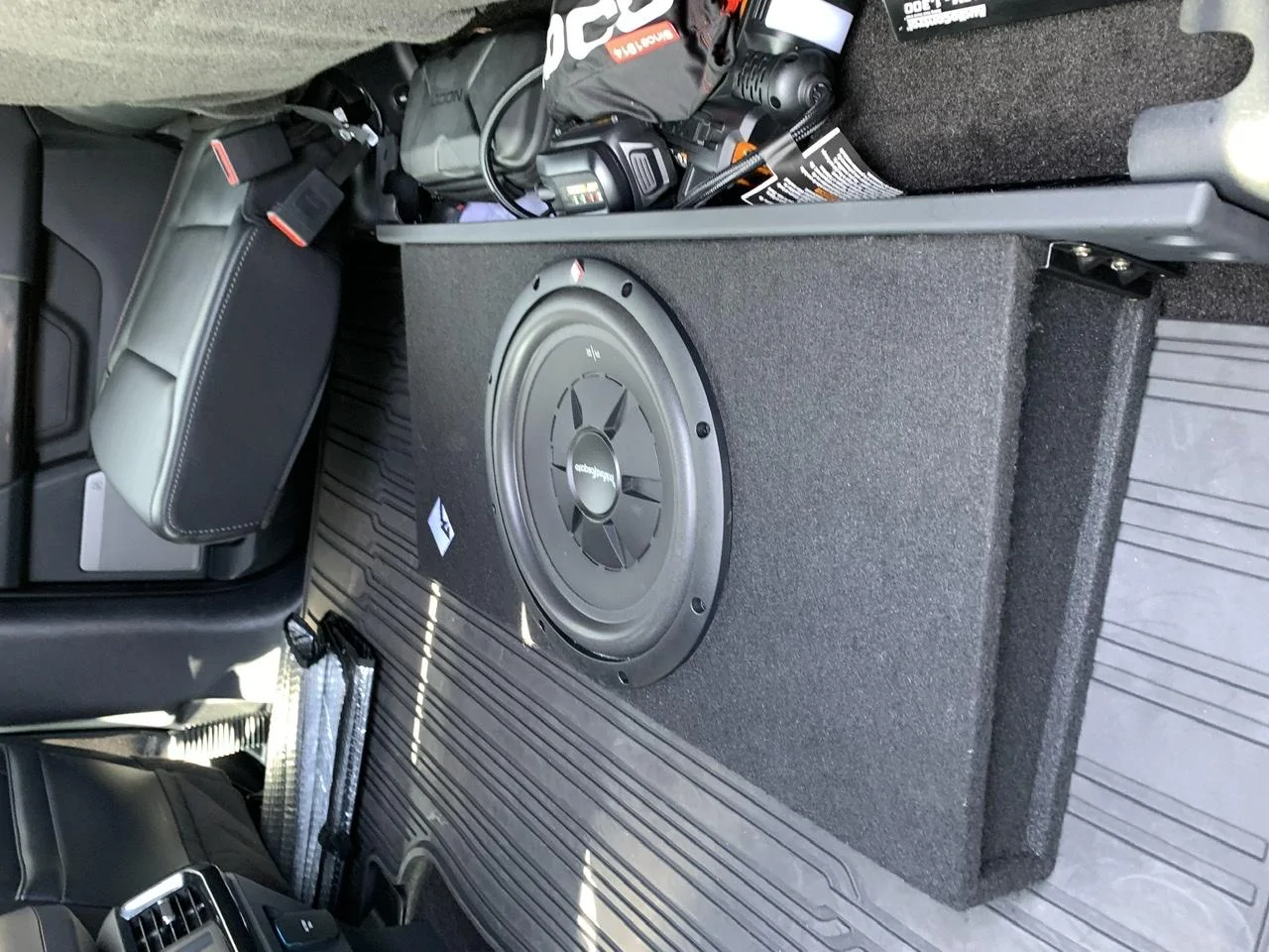

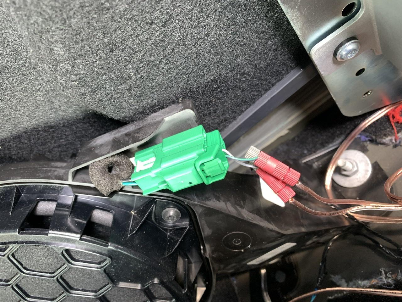

ended up going with a Rockford fosgate 12” sub and an Audiocontrol converter/amp combo. Super easy install and now I feel like I have some real bass. A few pics.
What power source are you using for the remote wire? I've been struggling to find a fuse that'll turn off when the truck is off. Can't tab into the ignition bc of it cuts on and on as you know.
The audiocontrol unit I went with automatically senses an Audio signal and turns on…no need for a remote turn on…part of the simple install comment
