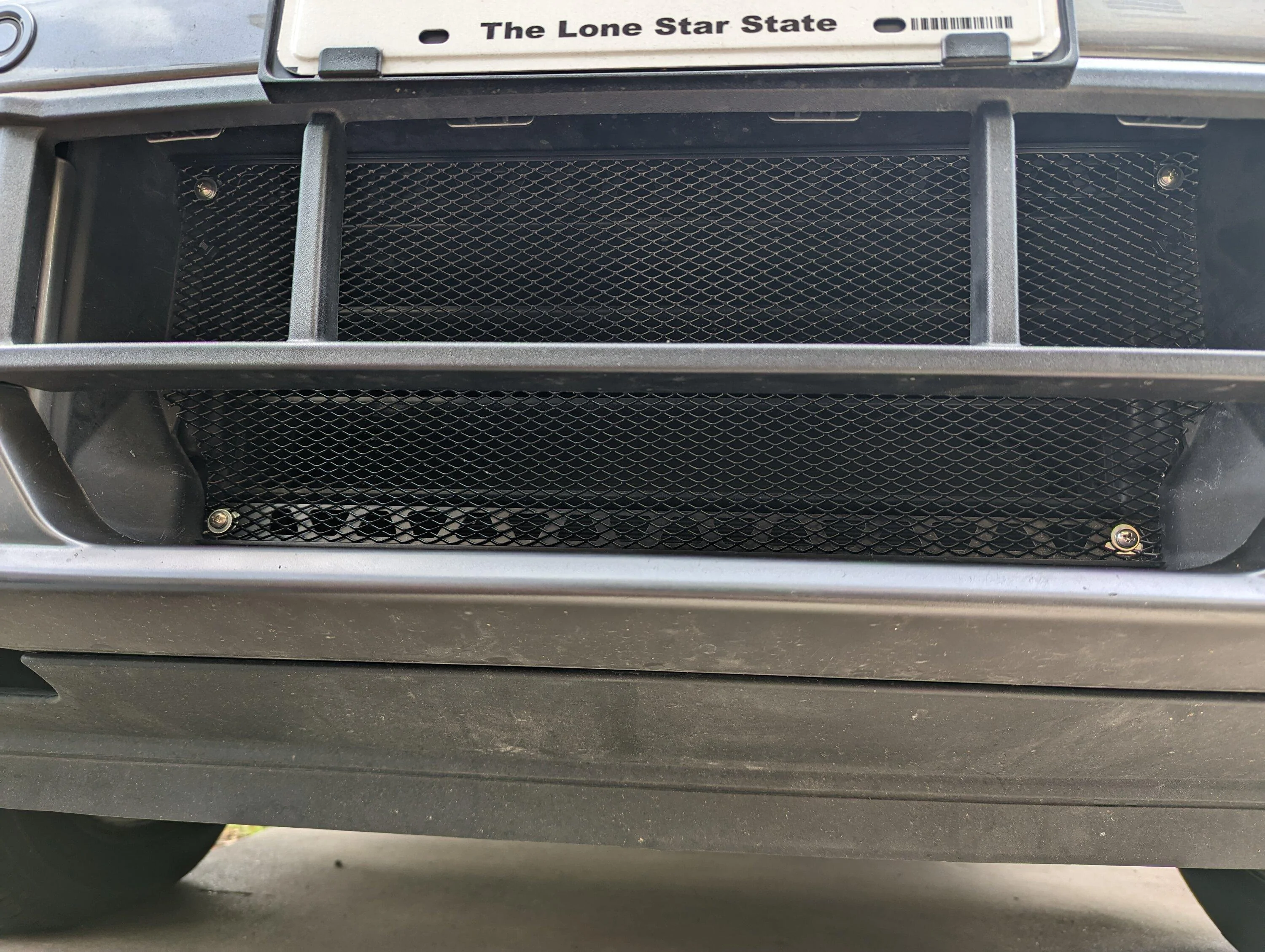

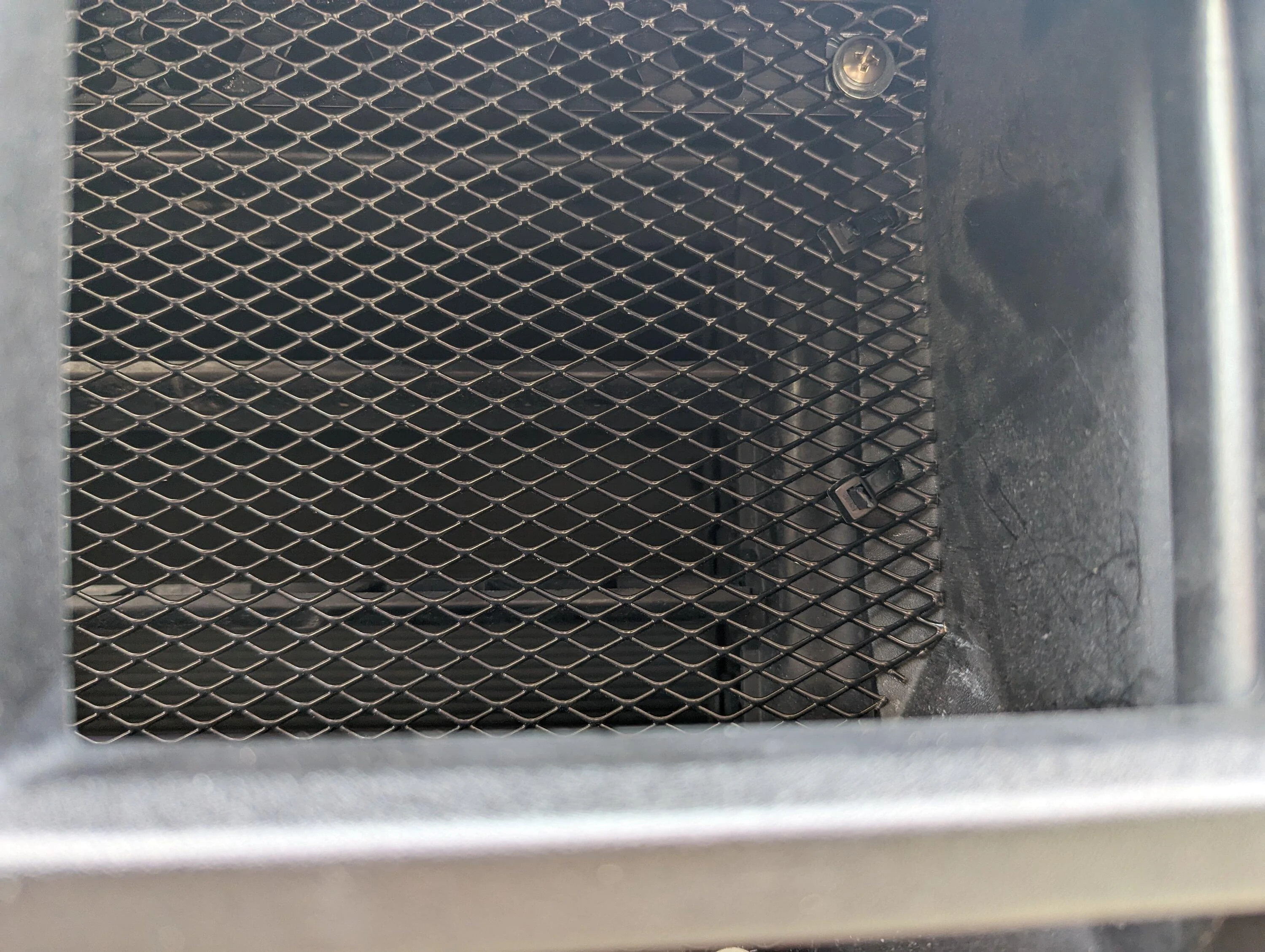

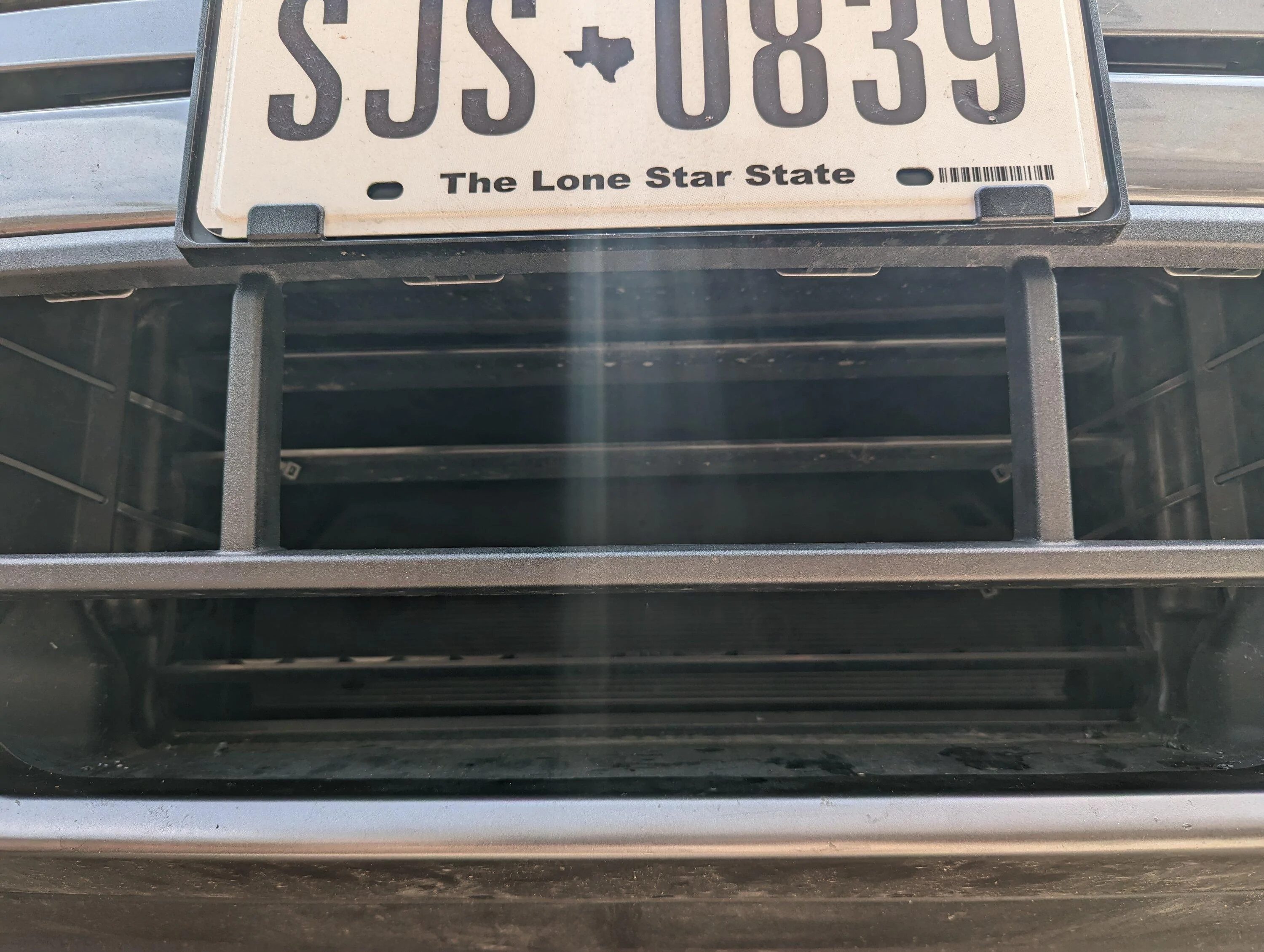

Just did this on my 2023 Lariat.

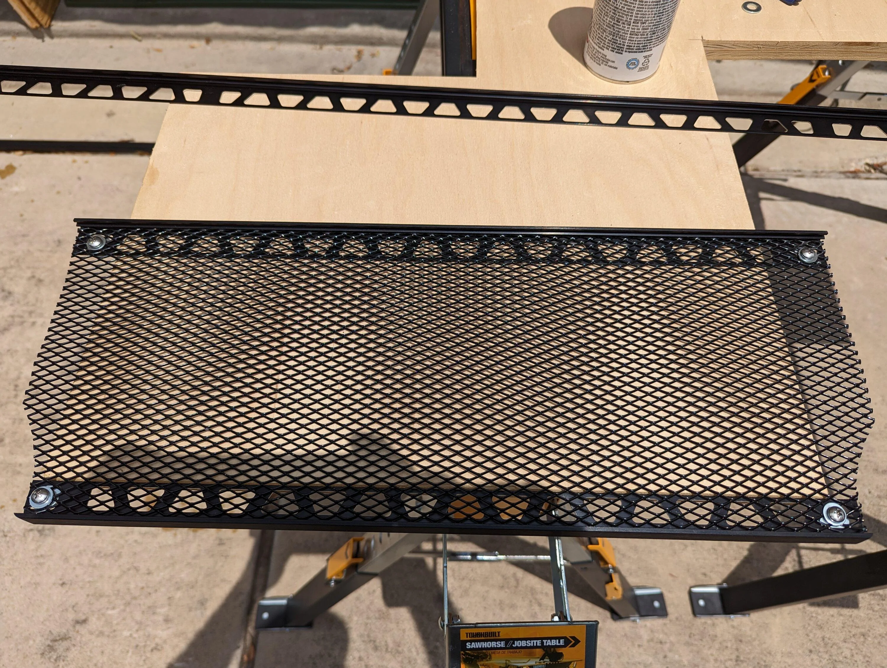

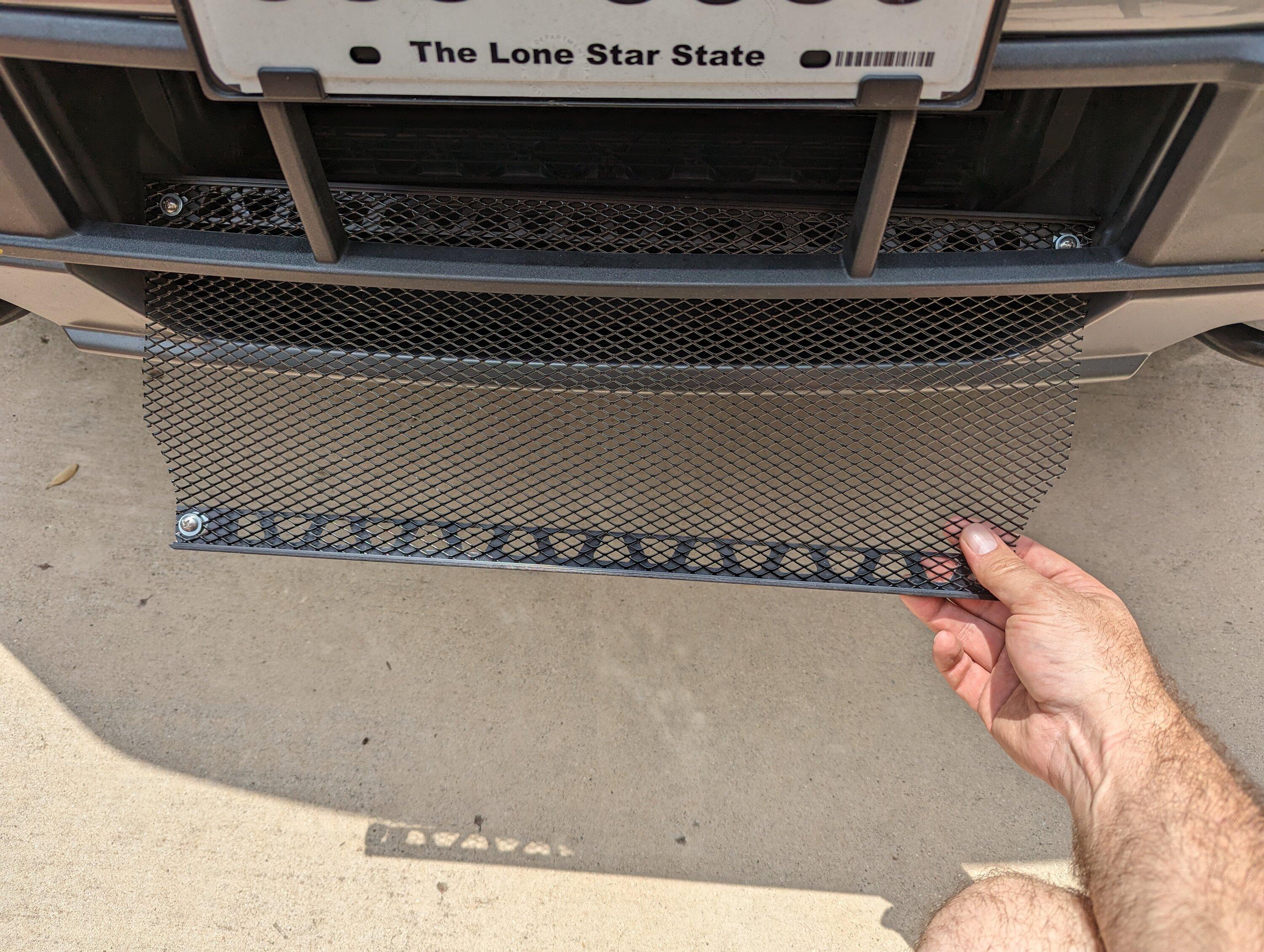

This is about 4 times the size of the grill so you could do yours and three friends!! (Was not expecting it to be that big). I cut mine easily using tin-snips. 11x30 is the one that I used. Takes some poking to get the zip-lock ties in there but use small ones and you should be able to get them in.
