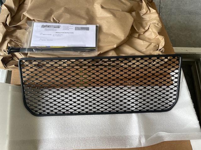

Here's how things come out of the box, there are 8 zip ties included:

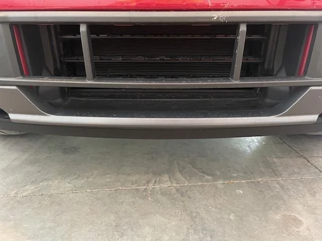

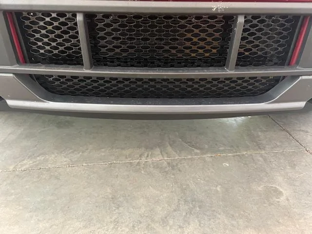

Here was the front grill before starting (shame that it can't protect against bug splats):

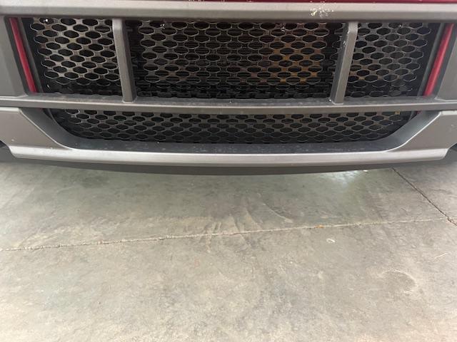

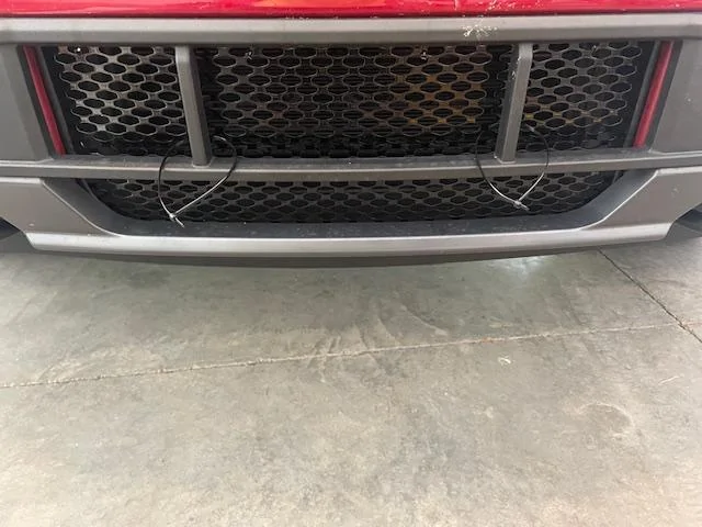

Here is a pic with it in place before the ends of the zip ties were snipped off, it was pretty easy to slide up into place. A few quick notes:
1 - The hardest part was getting the zip ties started in the existing upper brackets as noted in the instructions in https://www.customcargrills.com/proddetail.asp?prod=F150-Lightning-2022 as there are already small metal straps in there to hold the existing grill pieces in place, so it may take a few tries to get it fed through each one.
2 - Once the mesh is pushed up all the way into place, it's handy to have a small tool to hook behind it and pull the bottom of the mesh into the groove at the bottom of the grill.
3 - Plenty of real mechanics will have rugged and durable petzl headband lamps to use, but you can get a cheap knockoff at Walmart for $1.88 and if you only need it occasionally it works perfectly and definitely better than trying to hold the iPhone flashlight in one hand and thus only having one hand to manage the rest of the positioning.
Ford F-150 Lightning Adding grill mesh ahead of active shutters in bumper? screen3

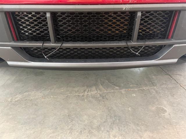

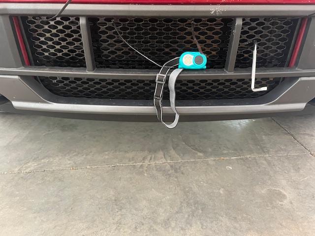

Here's the finished pic, took less than 10 minutes even for a definite non-pro like me:

Since there are 4 connection points at the top and 8 zip ties included, I thought about using a couple extra and securing on each side in the middle, but decided to hold off on that unless I find that it gets pushed back a bit and pulling it forward against those two pillars might help:
Ford F-150 Lightning Adding grill mesh ahead of active shutters in bumper? screen5
That's all there was to it!

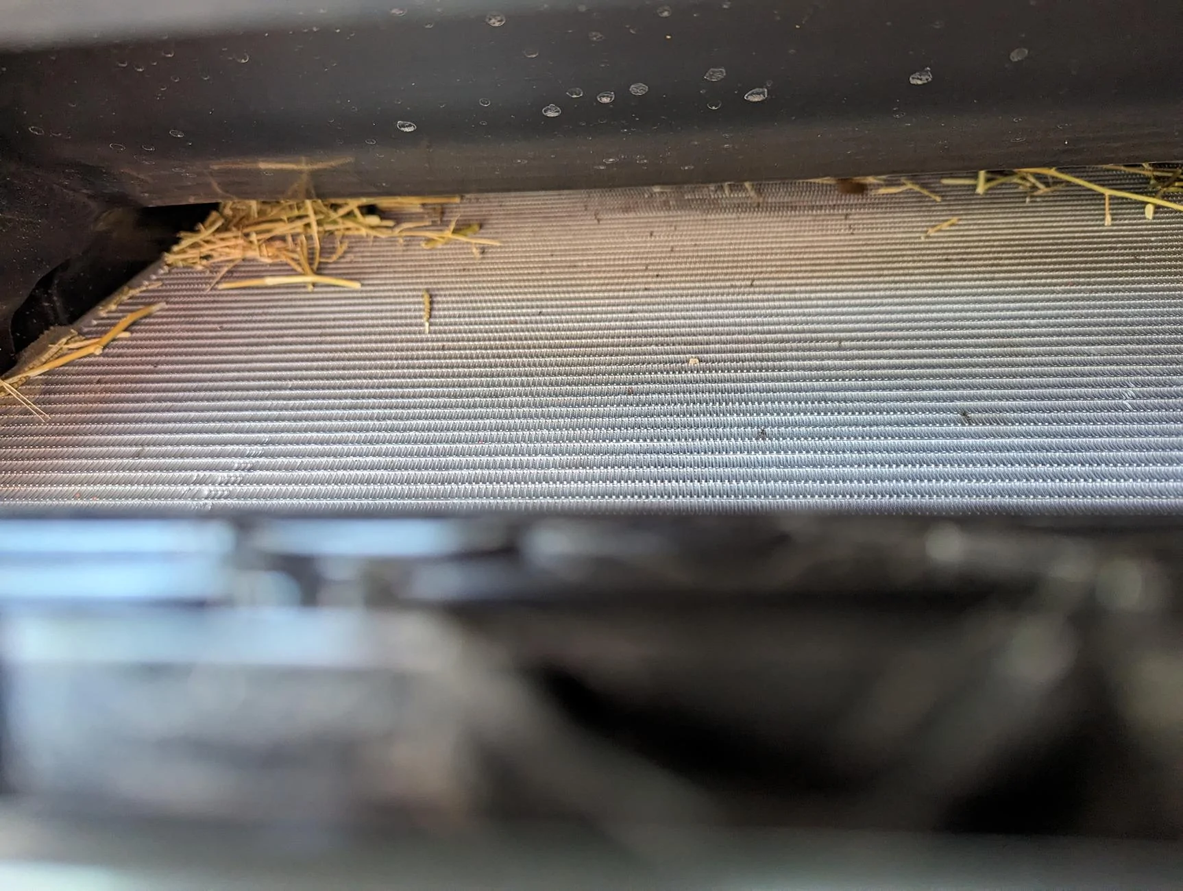

I wonder if all this modification would be needed if we realize that the shutters are actually always CLOSED while driving... but, yes, if you just like the 'look', that's a different story.
I did mine because we hit a tumbleweed on the highway and had to vacuum out the debris. Whether the shutters stay closed on the freeway or not, debris manages to get in there.

On the roads and highways I drive, dry weeds tumbling across the roadway is a common event. Since I've already had a 70 mph encounter with one, all I can say is that either the louvers were open or they were forced open by the debris. Either option is reason to put the mesh in.

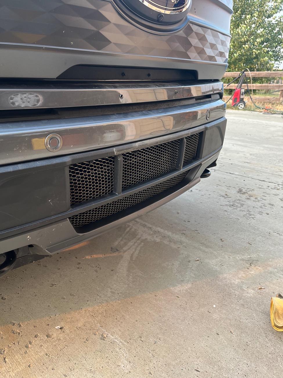

Did mine a couple weeks ago.
simple aluminum mesh and zip ties.
I’ll probably paint it or powder coat at some point.
I’m not so sure about the shutters closed all the time.
I scooped up a bird that flew up from a flock sitting on the road and had to remove it and about a pound of dead grasshoppers from the surface of the radiator.
