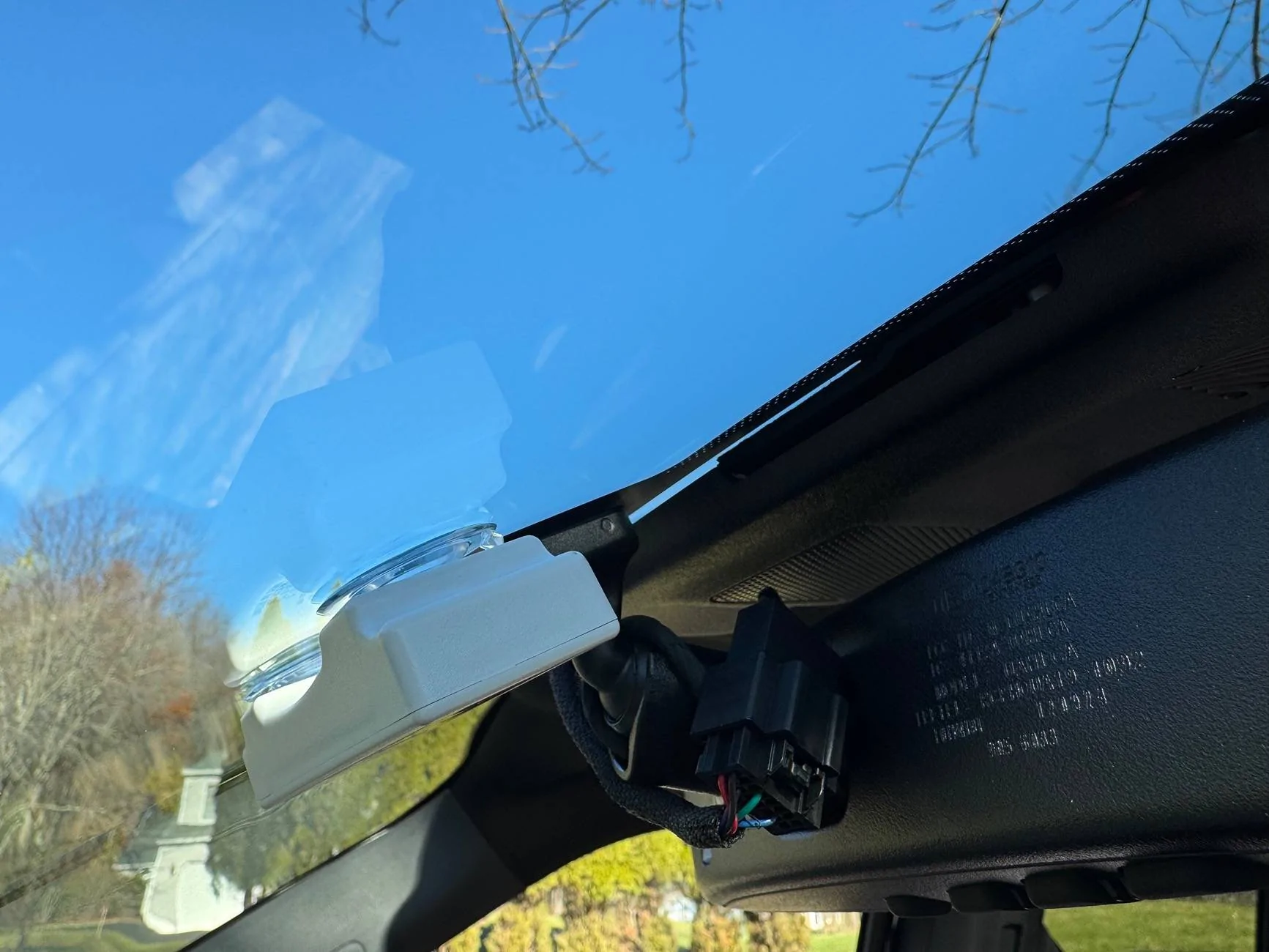

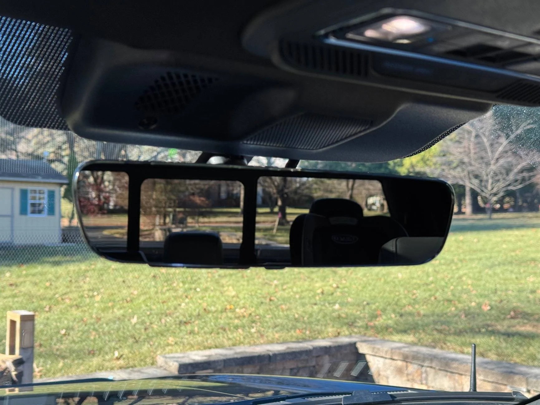

Works with a Lariat except there’s not much in the way of space to tuck the wiring under the rain sensor cover/shroud (the flat plastic piece stuck to the windshield) so I just neatly wrapped the wiring and connector around the mirror stem. I’m sure I’ll never think about it again.
