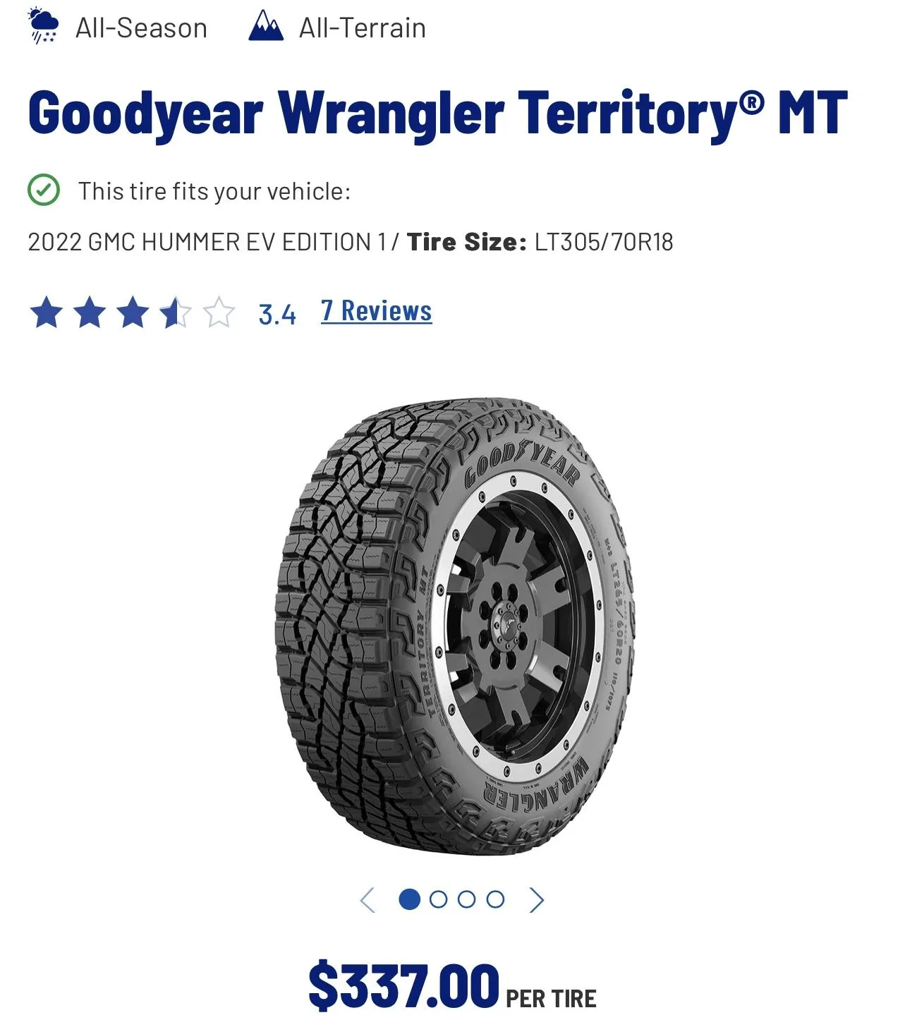

Anyone considering or have installed these?
Ford F-150 Lightning Anyone install 305/70R18 | OEM GMC/Hummer EV Tire ? IMG_0531
The 305 is a very aggressive fitment. I have heard the 295 fits with mods and a leveling kit.
You would certainly need a leveling kit and some +44 offset wheels to have even have a chance without trimming. These tires have a diameter of 34.8" and a section width of 12.0". I have a 3 inch lift and +12 offset wheels and I get very slight rubbing with tires that have a diameter of 34.5” and section width of 11.4” and I have slight rubbing.
I have seen reports that 285/75/R18 on the OEM +44 wheels fit as well as 295/70/R18
