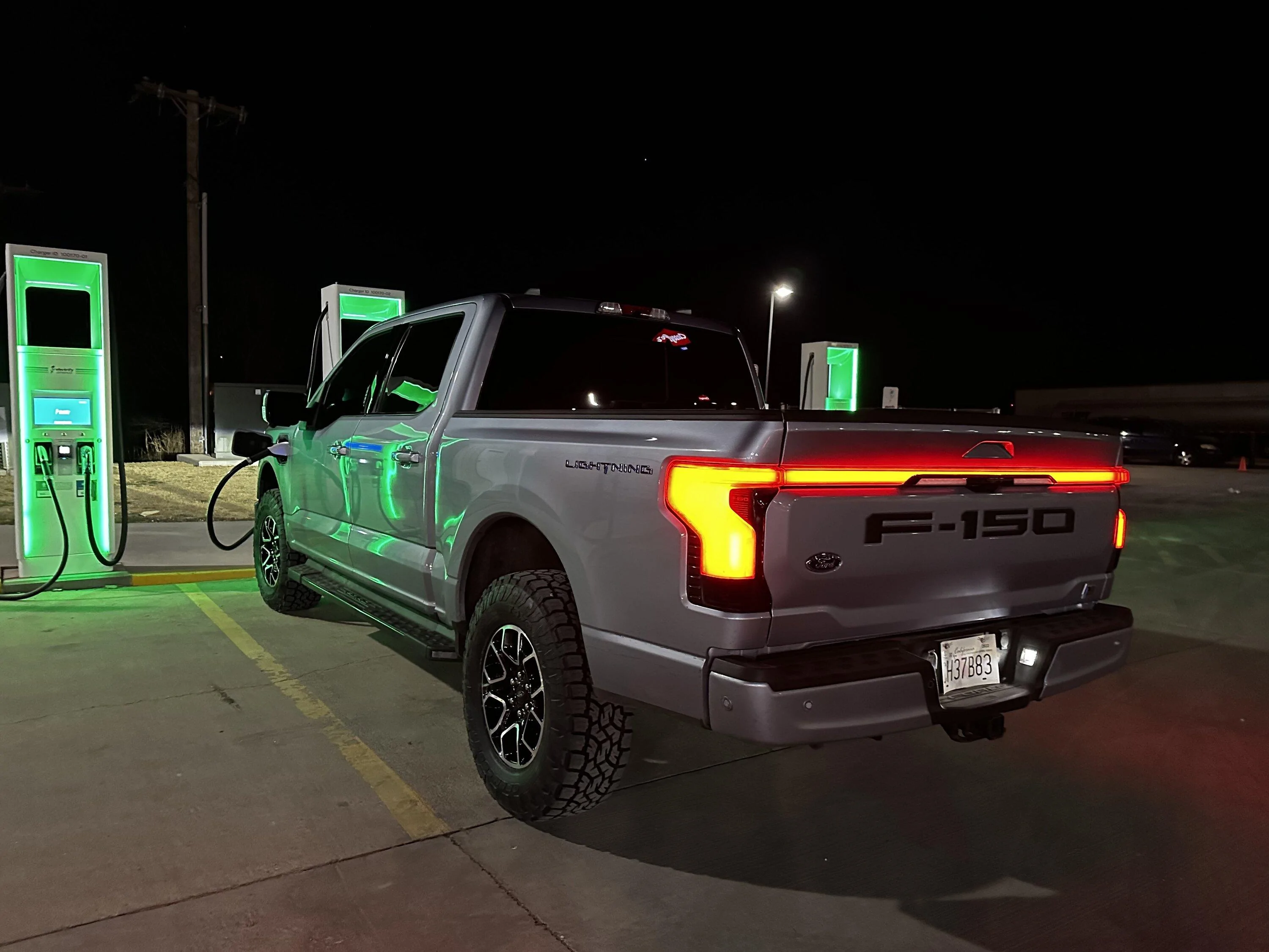

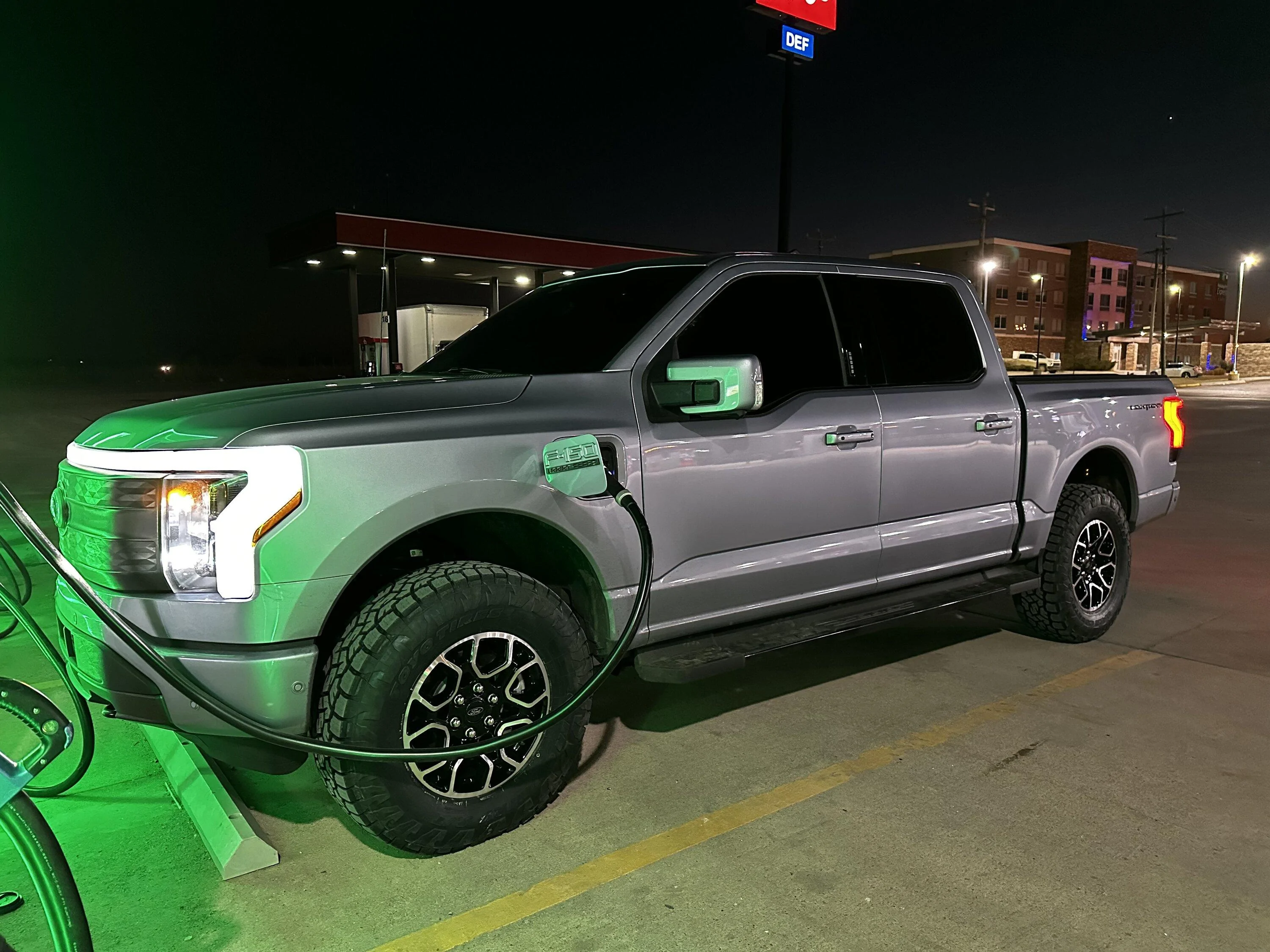

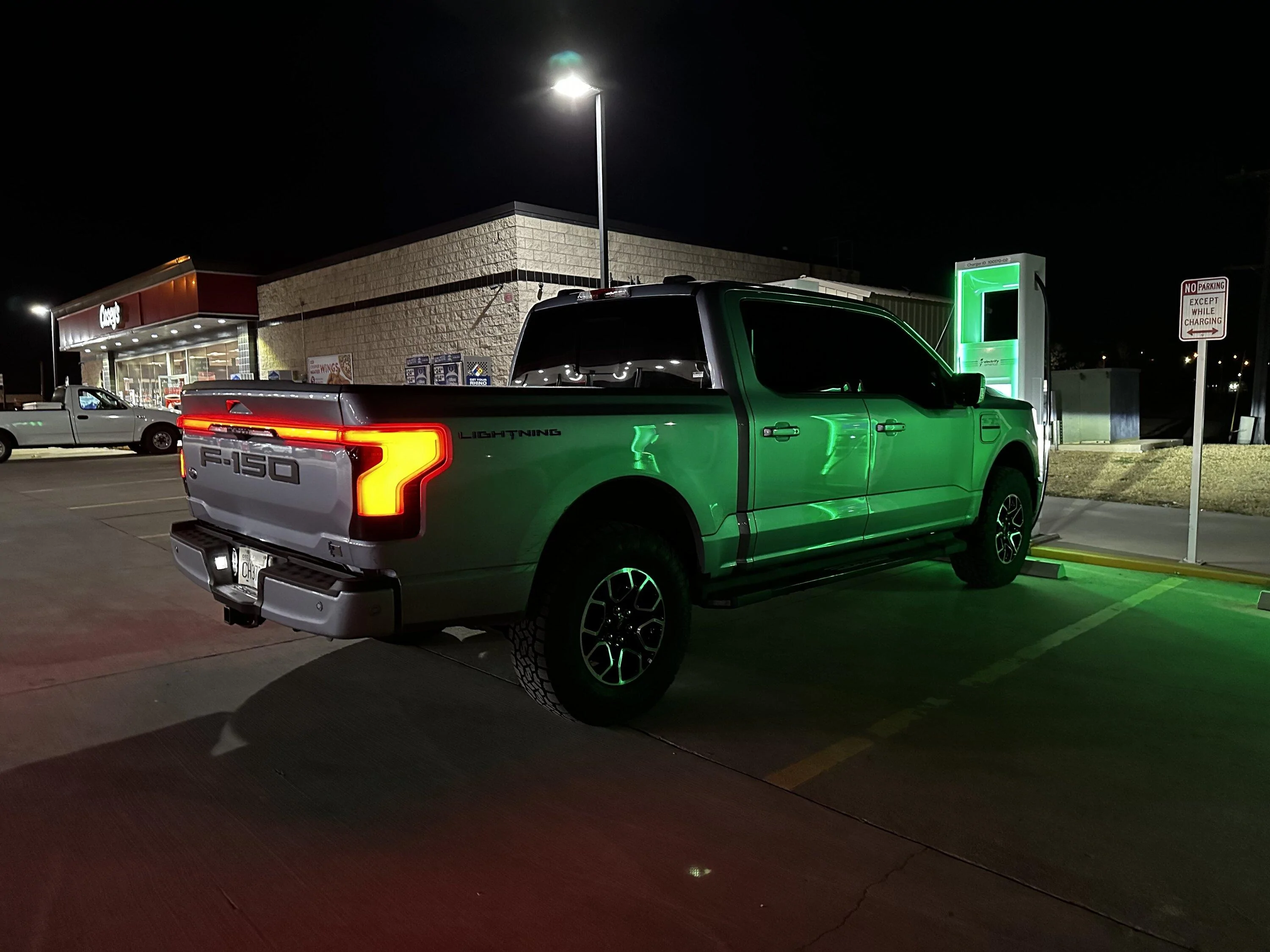

I leveled my truck with rough country 2” kit and bought some ford takeoffs. The range did take a hit in getting 1.3- 1.4mi/kWh vs 1.5mi/kWh @ 38F + 75MPG
I was too scared to go 35s but these are 34.8 I believe and I still have some clearance no rubbing under any conditions. Bumps, off road, steering end to end are all still good. Tires are a bit noisy but that’s expected.
