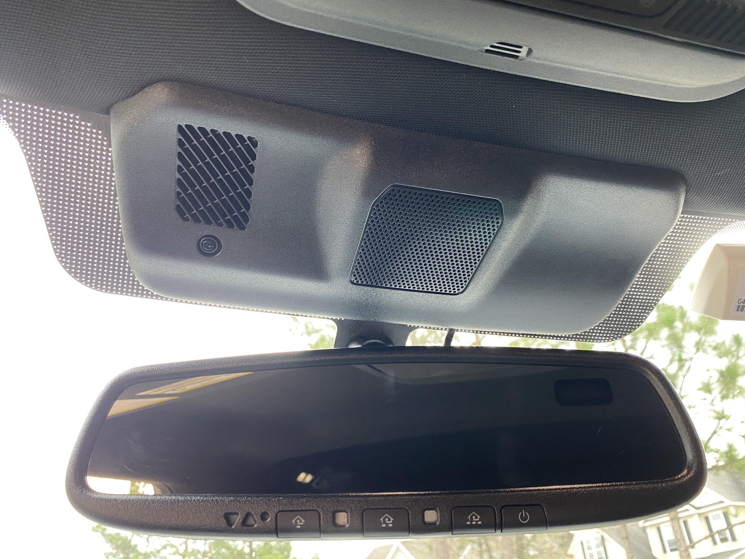

Well i decided to get homelink in my rearview mirror and i'm going to get illuminated mirror visors without homelink(still waiting to purchase these). They seem to be about half the price of homelink visors. Here is a picture of my gentex homelink v5 rearview installed with blue backlit.
Ford F-150 Lightning Anyone install OEM lighted vanity visors with HomeLink ('21 F-150s)? IMG_3402.JPG
Ford F-150 Lightning Anyone install OEM lighted vanity visors with HomeLink ('21 F-150s)? IMG_3401.JPG
