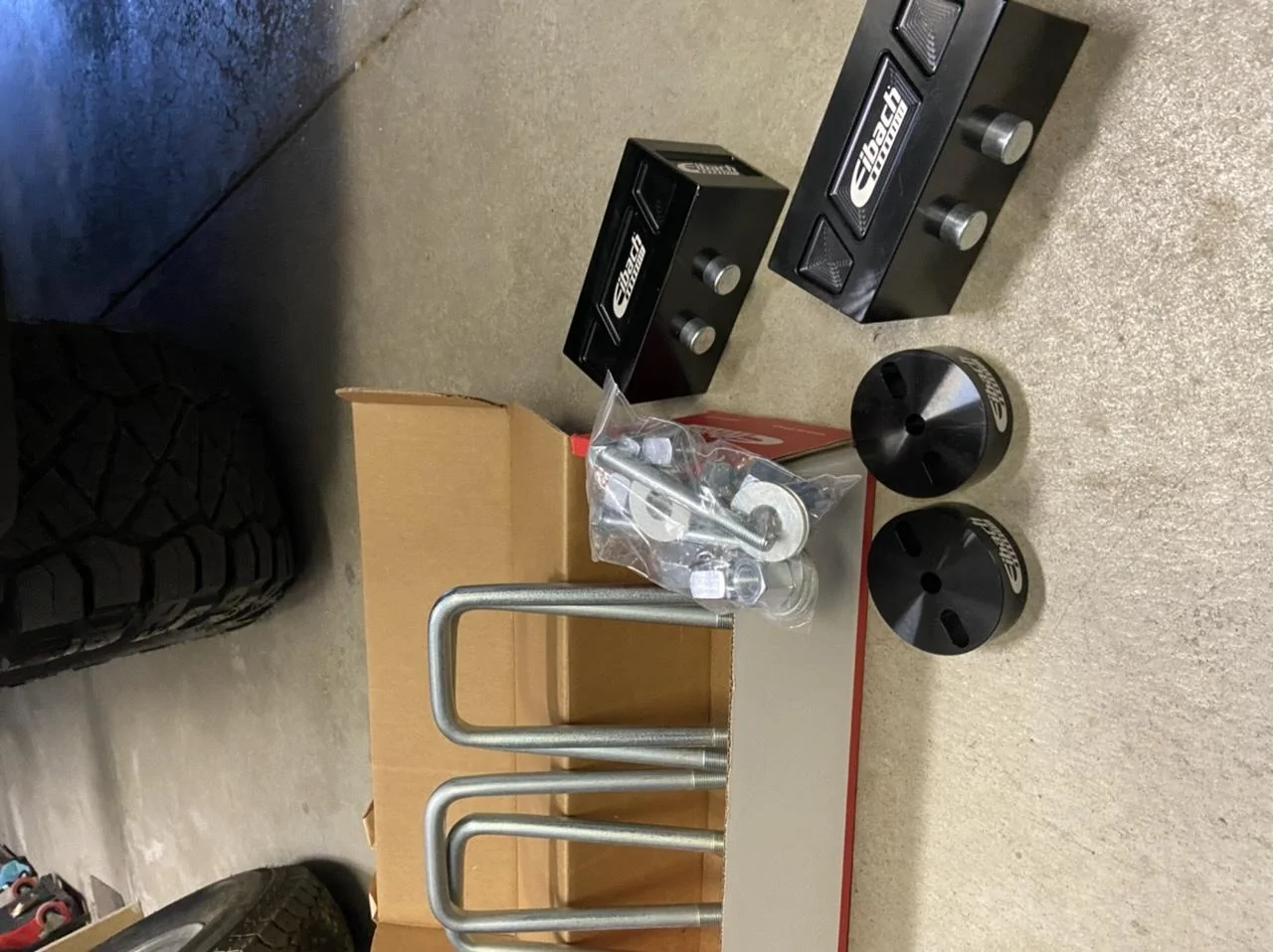

I just got my order of 2.5" rear replacement blocks from Stage 3 motorsports. Stock blocks are 1 1/4-1"1/2 tall on my CC 4x4 NON FX4 with Max tow. I have a 2.5" level and want a little rake for towing. It should lift the rear 1" supposedly. The kit I bought was Eibach 2.5" rear blocks and it said it fit the 21's. It came with new U-bolts but I haven't installed. I'll let you know it will probolly be next week.

Oh awesome, would you send me a pic of the parts?
In the 17 we had 3" F&R and it was good, slight rake. After installing just the front on the 21, the front definitely is too high lol. So looking for 2.5 or 3" rear block.
Here ya go

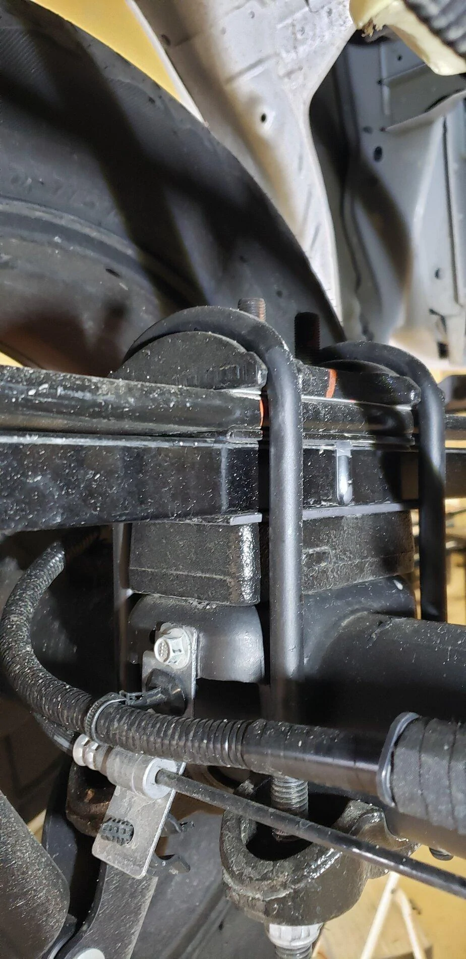

I don't know if that is gonna work for you, those u bolts are too square I think, here is a pic

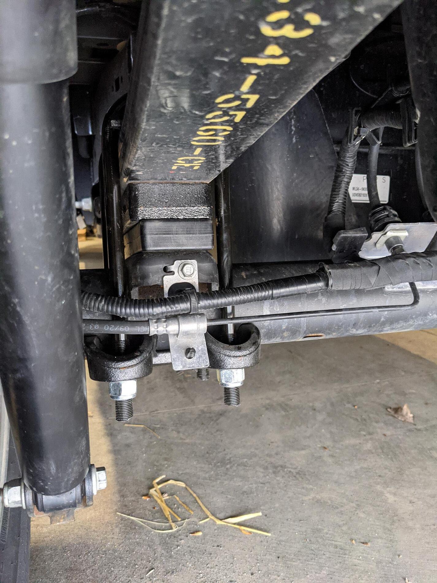

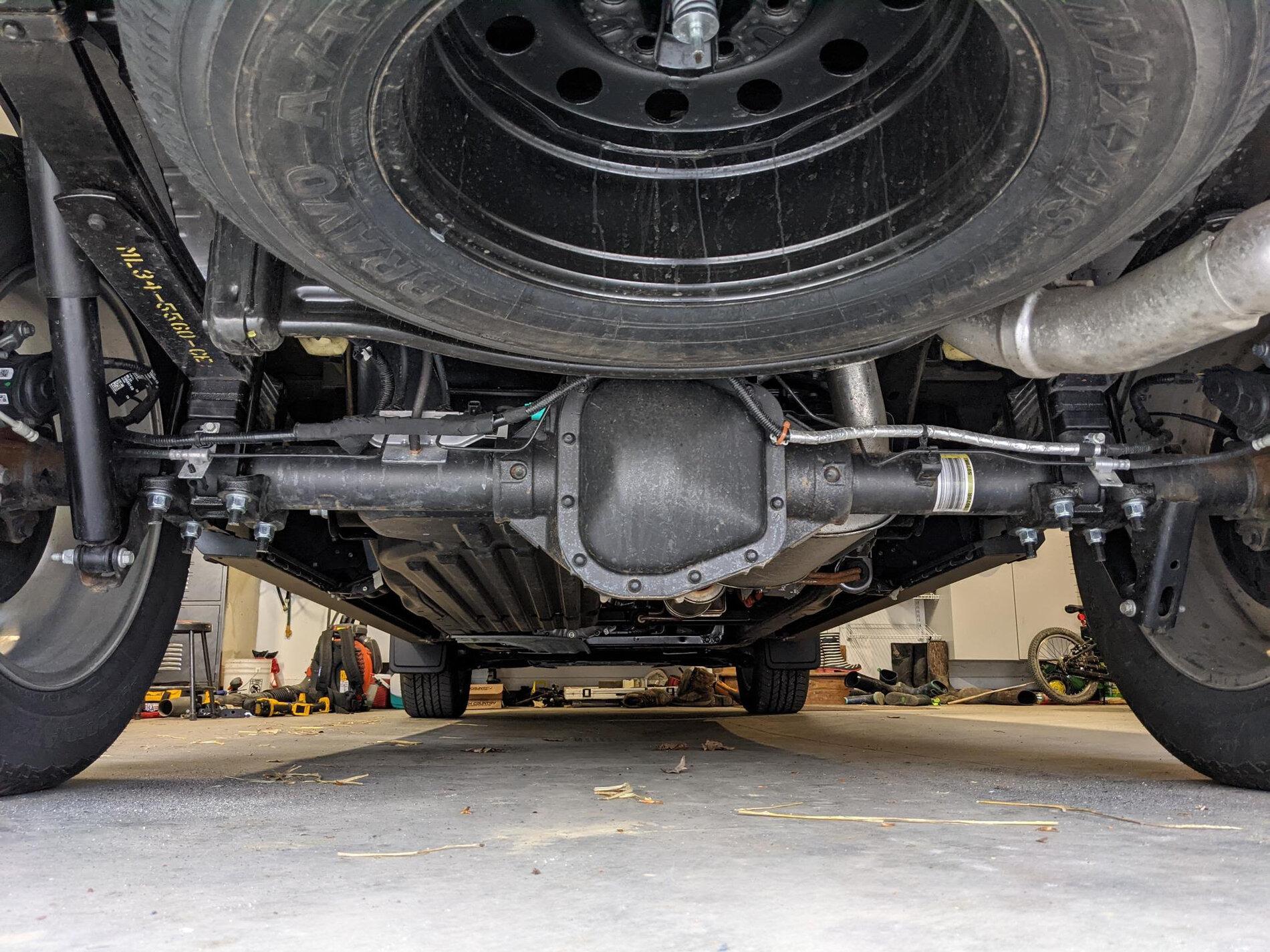

A couple quick pictures of the blocks installed. I'll grab a side shot once the level is on. I'll be running stock wheels and tires with the level for a couple weeks before the Fuel's arrive.
