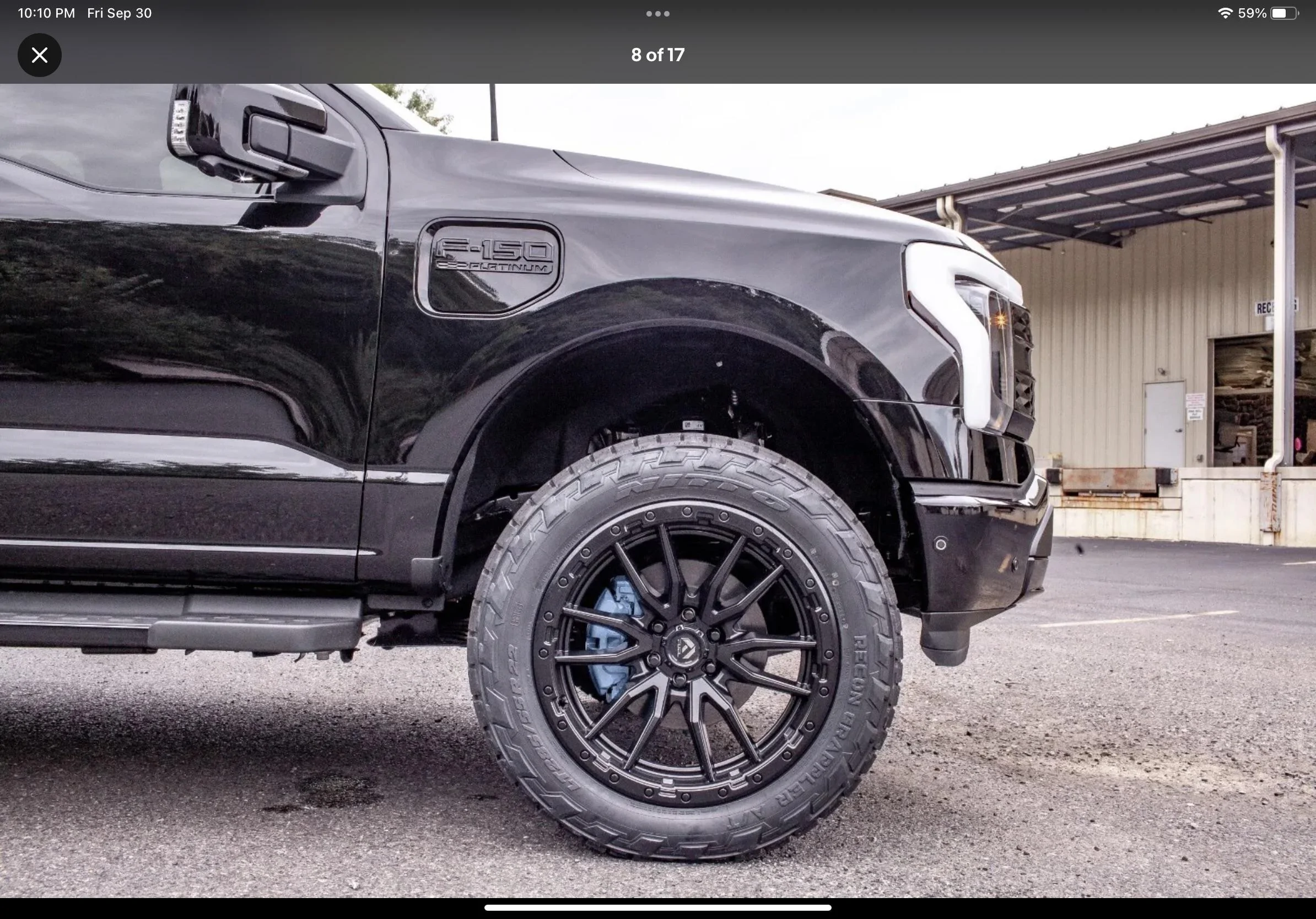

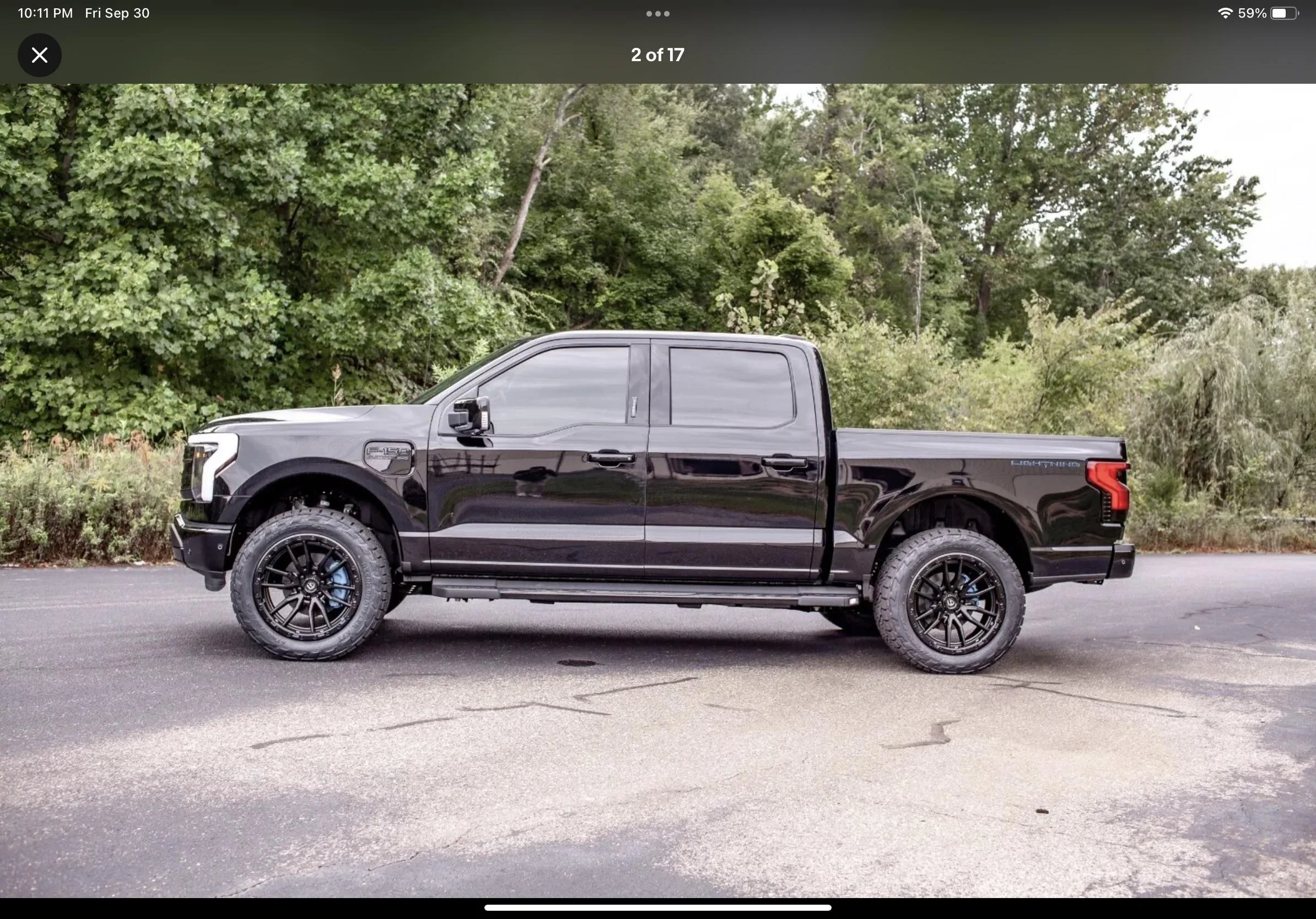

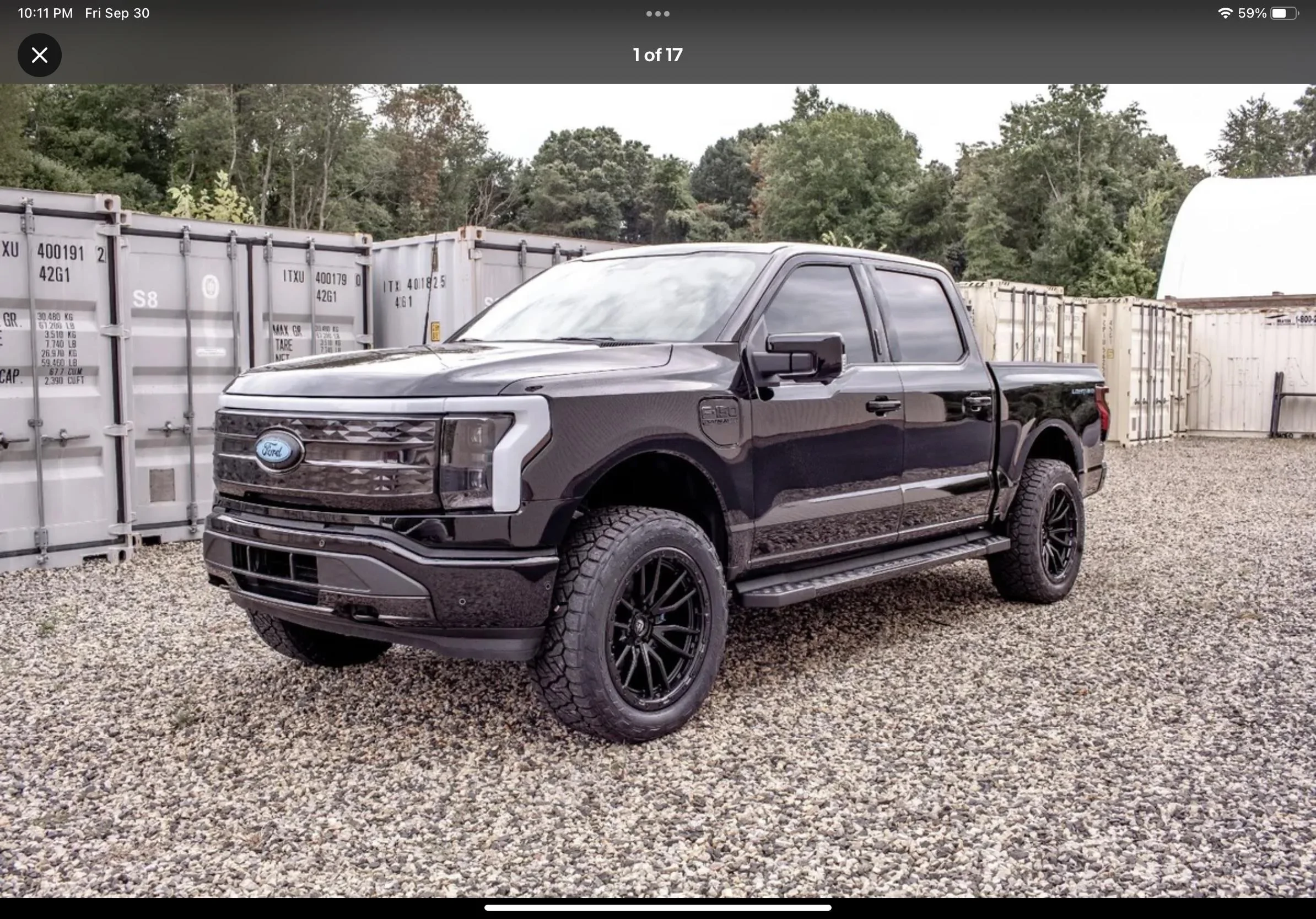

Found this truck on eBay (someone selling). Running 22x10 Fuel Rebel wheels (-12 offset) and 285/55/20 recon grapplers. I think I’m going this route. Love the look of 22s.

This is also a 3 inch front level

3” seems a bit much to me. It’s starting to get a bit if that Carolina squat look to me.
20x9 44 offset if I remember correctly.
I thought I had read that somewhere but wasn't sure.

Personally I can’t stand the front end higher than the rear. So I completely agree. 2” level for me.
Still gonna remove/cut those crash bars to make room for the 34” tires and offset of 10” wheels. I love the look. Raptor didn’t have crash bars, so I won’t miss them :)

Not a fan of off road (A/T) tires on such big wheels. Thin tires like that provide improved on road handling by reducing sidewall flex, but make the ride harsher and off road performance worse. For off road you want the smallest wheel you can fit so you have the most rubber to improve traction on a loose surface and to soak up bumps better. Mixing them like this just gets you worse on road performance (less grip and all season or performance tires) and worse off road performance (less flex and more risk of damage to the tire)!
